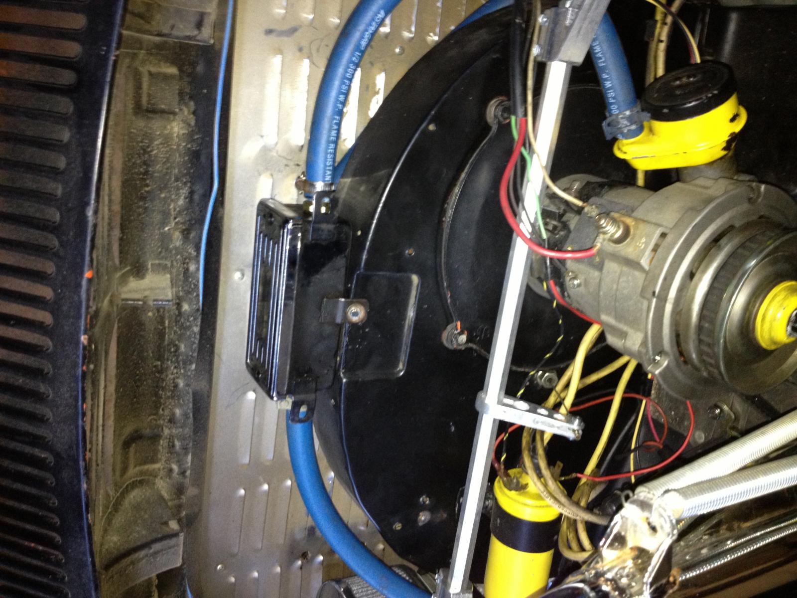

[email protected] Samba Member
Joined: August 03, 2002 Posts: 12785 Location: Salt Lake City, Utah
Posted: Fri Dec 14, 2012 12:44 pm Post subject: |
I normally run deep sumps 1/2 qt low, using the "Add" mark on the dipstick as my new "FULL" mark, and the end of the dipstick as my "add" mark. You'll get less oil blow running it 1/2 qt "low", which you can only get away with because you have a deep sump. Breather Box orientation is correct in that picture. Don't use screws, use bolts with nylock nuts so they don't vibrate loose. Make sure breather hoses slope down to the engine.
I also run 2 hoses on the 1/2 side, and none on the 3/4 side due to windage, it just works better. _________________ It's just advice, do whatever you want with it!
Please do NOT send me Private Messages through the Samba PM System (I will not see them). Send me an e-mail to john at aircooled dot net
"Like" our Facebook page at
http://www.facebook.com/vwpartsaircoolednet
and get a 5% off code for use on one order for VW Parts ON OUR PARTS STORE WEBSITE, vwparts.aircooled.net |

69bajaguy Samba Member
Joined: June 26, 2011 Posts: 267 Location: Tennessee
Posted: Fri Dec 14, 2012 12:20 pm Post subject: |
So I don't need to factor in the external filter? And thanks for catching that breather box. Is this better? Any other concerns or comments?
