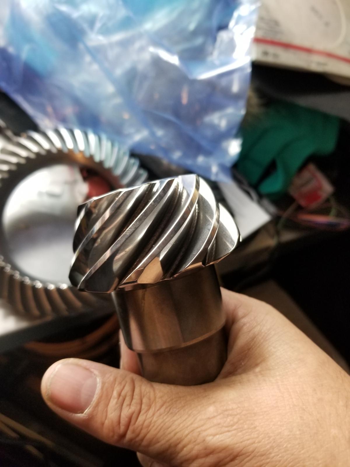

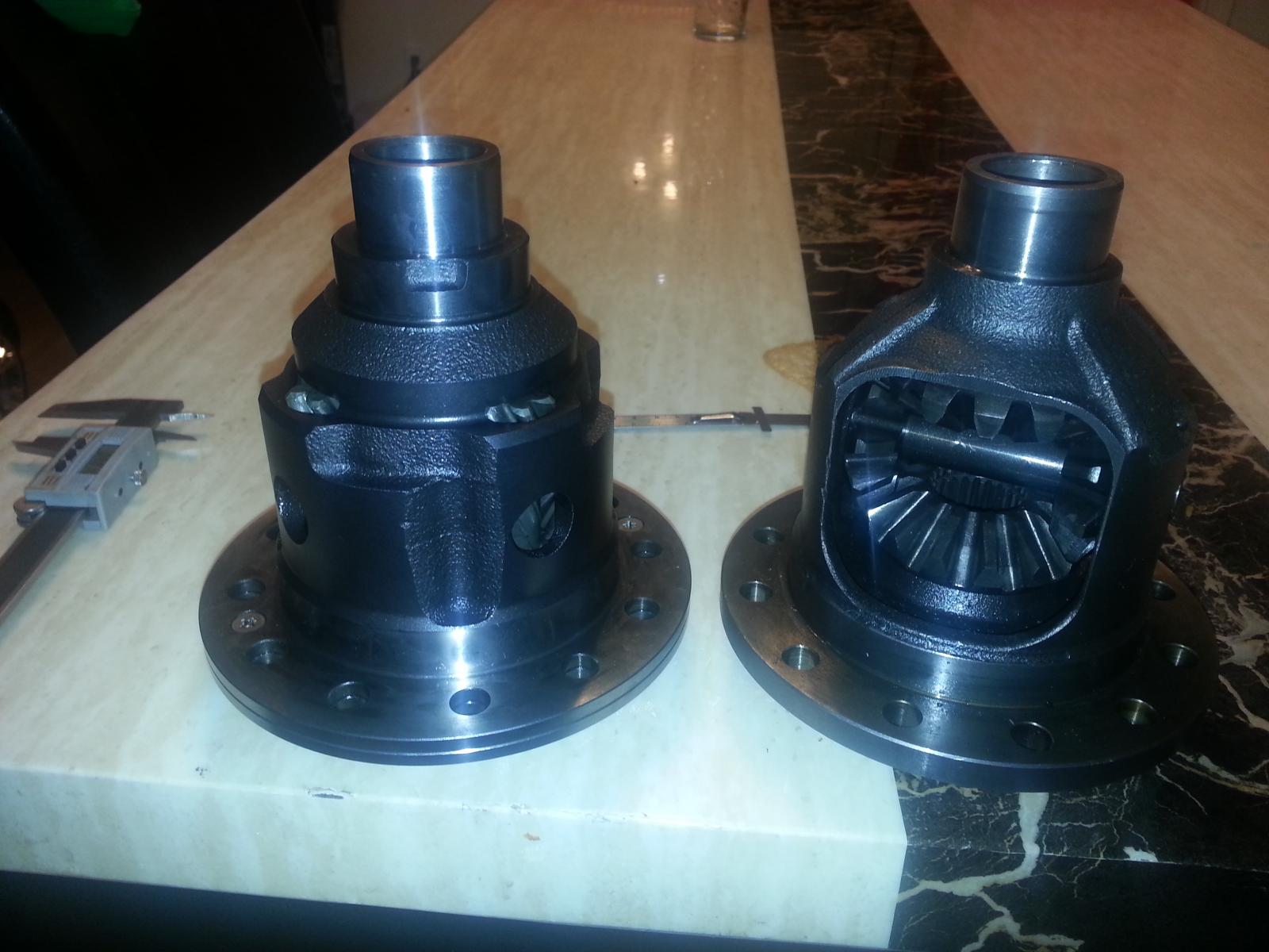

My box builder said stock scoob gear sets wouldn't have a chance with 300bhp too, hence my comment.....but then I cut it short as didnt want to advise on something I personally had no experience of, and to not look like I was putting subaru gears down as that wasnt my intension.

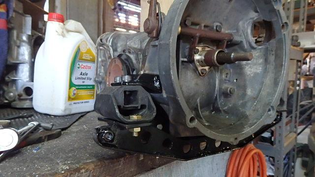

They are some beefy mounts like them!
I planned to link mine when reducing the depth of them at the same time making into a cradle effectively. But all been working well and despite their size not causing any clearance issues at the height I run the car.
Your right tho it may well be worth triangulating from the horns to the shock top mounts for additional support.
This is how my horns are currently tied into the cage
It looked like this originally but had to be modified when went from type1 to scoob Smile

I run a 2.90, 1.86 ,1.26 , .89 with a 4.56 diff through 205/50r16 Yoko AD08 tyres . the tailer first /second is great with the torque of a 2.6 type4 . It is a bit low for extended highway cruises 110kmh is about 3900. the engine is happy ,gives good mpg but the drivers ears suffer after an hour or so Very Happy
I couldn't see on the videos how well the motor/ trans/tuning forks are braced to the car to stop wheel hop . A traction bar works really well , it would take a bit of fabrication to extend your mudguard/wings sub frame to also incorporate a traction bar ,I think it would be worth it .
Big Al ,here are some ideas on trans mounts . The rubber mounts are GM transmission mounts , they were too soft so I fabricated some mounts similar to these .
http://musclegarage.com.au/index.php?route=product/product&path=80_66&product_id=103
route=product/product&path=66&product_id=88
