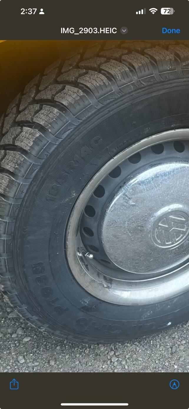

PostPosted: Thu Jan 11, 2024 7:05 pm    Post subject: Re: 14" Tire Options Reply with quote
My buddy is running these on his 76 Westfalia. He likes getting muddy and long walks on the beach Wink He has a couple buses and probably only puts 5000 miles on each bus. These are only 6 months old so time will tell. They are winter tires so not going to last long but he loves them so far. Very quiet and comfortable. Oregon rain and beach sand has not been a problem. He’s had all the usual 14” tires. Just something to look into. They cost him less than the Vantras. Cost wasn’t the reason he bought them. He manages a fleet of trucks similar to UPS trucks. The guy they use for tire replacements recommended them. Again just something to look into, I’ll update in the future. YMMV.
Petlas full grip pt935 185r14c
https://www.petlas.com/pcr-detail/full-grip-pt935
Keep on Busin'

i ran a bunch of General Altimax Arctic snow tires, at least 12 mebbe more, on various vehicles and experienced 2 sidewall blowouts like that photo. it was a totally different tire but had the same explosive blowout and put me off of those tires for the current term. they went out with a shotgun-like report. something ain't right at General in the Altimax line.
How long ago did these failures happen? Where the tires "standard load" or "extra load (XL)"
