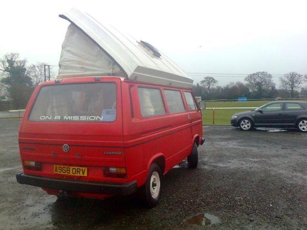

Chazz79, is this the type of conversion you've got in mind?

chazz79 wrote:
If someone where to use that for a basic model for a pop top but more of a roof over a roof (leaving the b and c pillars intact) this could work. That set up with a dormobile style top and maybe an air mattress to keep everything low profile? It would be nice to have something that can fit in normal garages and still camp a family of four.
I'm thinking the same thing, I think.
Are you saying use the existing metal roof as the lid of the dormobile-style conversion (like in the picture,) meaning cutting the roof, reinforcing the pillars and converting the C pillar to more of a Westy C pillar style, OR
leave the entire roof intact (excepting the cutout for roof access) and fabricate or source a camper shell similar to the dormobile conversions? In that case, you'd need some sort of frame to mate the bed platform to the tin top. Would this defeat the purpose of being able to fit it in a garage?
There's a thread here: http://www.thesamba.com/vw/forum/viewtopic.php?t=583436 where someone did that with a Wesfalia.

That's not for passengers, it's for selling crap out of. The passenger side drops down to the belt line-flopping out like a shelf. The only seats in it are in the front like a single cab. It's a professional hack job it was in the selling stuff out of your bus thread awhile ago. There's more pics of it posted somewhere around here. I think it got used as a coffee shop.

chazz79 wrote:
There's added bracing in the roof and the hatch is welded shut. I'd say they thought about structure enough. The body has to be as strong and safe as a single cab.
But you don't carry passengers in the back of a single cab.
To be clear, I meant that I'd have a brace going side to side to connect or I guess mimic the C pillar, just like Westphalia did. I see that they did brace the roof and I assume the rear hatch is welded up as a reinforcement measure.

AMT wrote:
But the C pillar completely with no reinforcement? Shocked Shocked Shocked
I know that is probably a trailer queen, but I think I'd reinforce that area. A rollover would be disasterous for anyone in the back.
