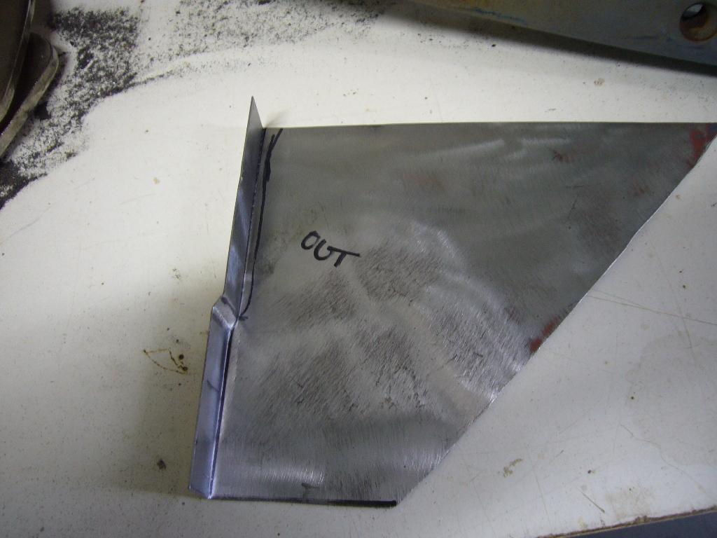

PostPosted: Thu Oct 23, 2014 2:33 pm    Post subject: Reply with quote
Then is with the replacement panel. I really need a little reciprocating saw. Really hard to get in there with the grinder.
Now just to clean up the welds.

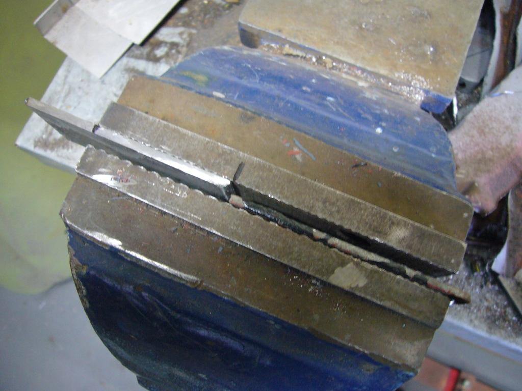

PostPosted: Thu Oct 23, 2014 2:30 pm    Post subject: Reply with quote
So I made a really simple tool using the bench vise, the replacement panels came up a treat!

PostPosted: Thu Oct 23, 2014 2:29 pm    Post subject: Reply with quote
These areas should look like this. Note how there is a joggle in the flange to accommodate the side of the heater channel. This is what needs recreating as removing the heater channel buggered up these sections.

PostPosted: Thu Oct 23, 2014 2:26 pm    Post subject: Reply with quote
So moving onto some other repairs. The lower firewall section in front of the heater channels were rusted through. I'd done one earlier that I still was not happy with. But now that I have good access, time to get it right.
