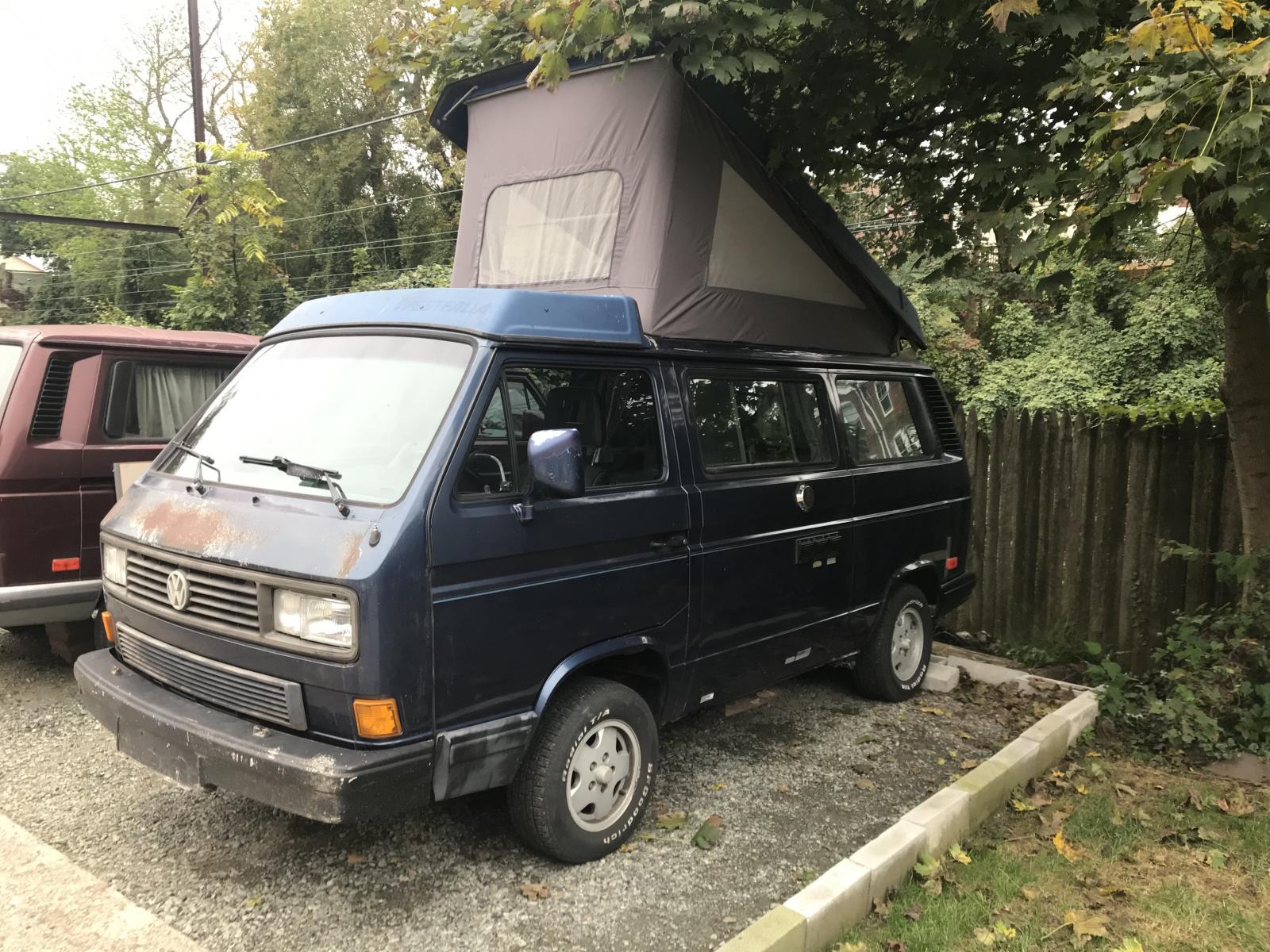

i installed my BD tent in place. i started with the front top center and worked to each corner, then did the rear top center and worked to each corner. then i did the front bottom center out to each corner and then the rear center putting two screws in on either side. then i worked from the front to the back on each side and finally worked on the rear bottom corners.
it was a PITA and i never want to do it again, but in the end it looks good.

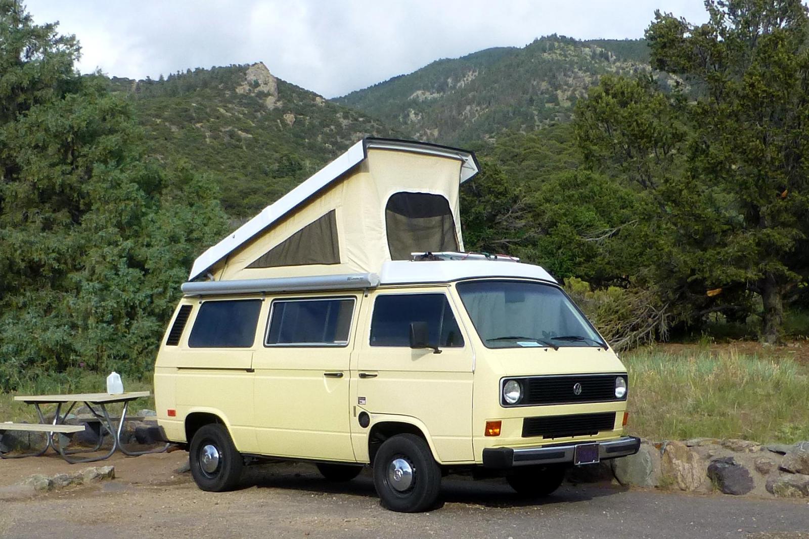

Ahwahnee
Joined: June 05, 2010
Posts: 10304
Location: Mt Lemmon, AZ
Ahwahnee is offline
PostPosted: Wed May 08, 2024 11:54 am    Post subject: Re: Bus Depot's Pop Top Canvas "In House Brand" Reply with quote
I suppose you shouldn't take advice from anyone unless you've seen how their install looks.
Original/Factory:
Replacement:

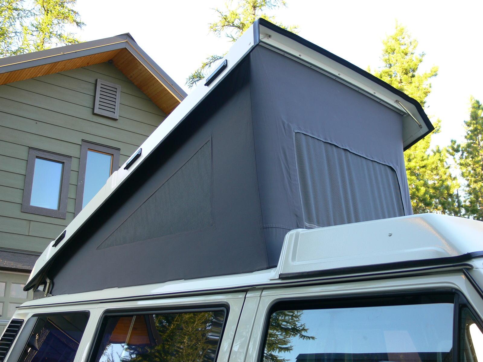

PostPosted: Tue May 07, 2024 1:30 pm    Post subject: Re: Bus Depot's Pop Top Canvas "In House Brand" Reply with quote
Depends on how you want it to look. I like the factory look of a smooth finish so worked our OEM brand of tent to get it tight.
I was a little worried about wear from being so taut but the above picture was taken in 2013 and here it is ten years later;
No problems with any tears. Also seems to me a tight tent is gonna flap around less in windy conditions.
