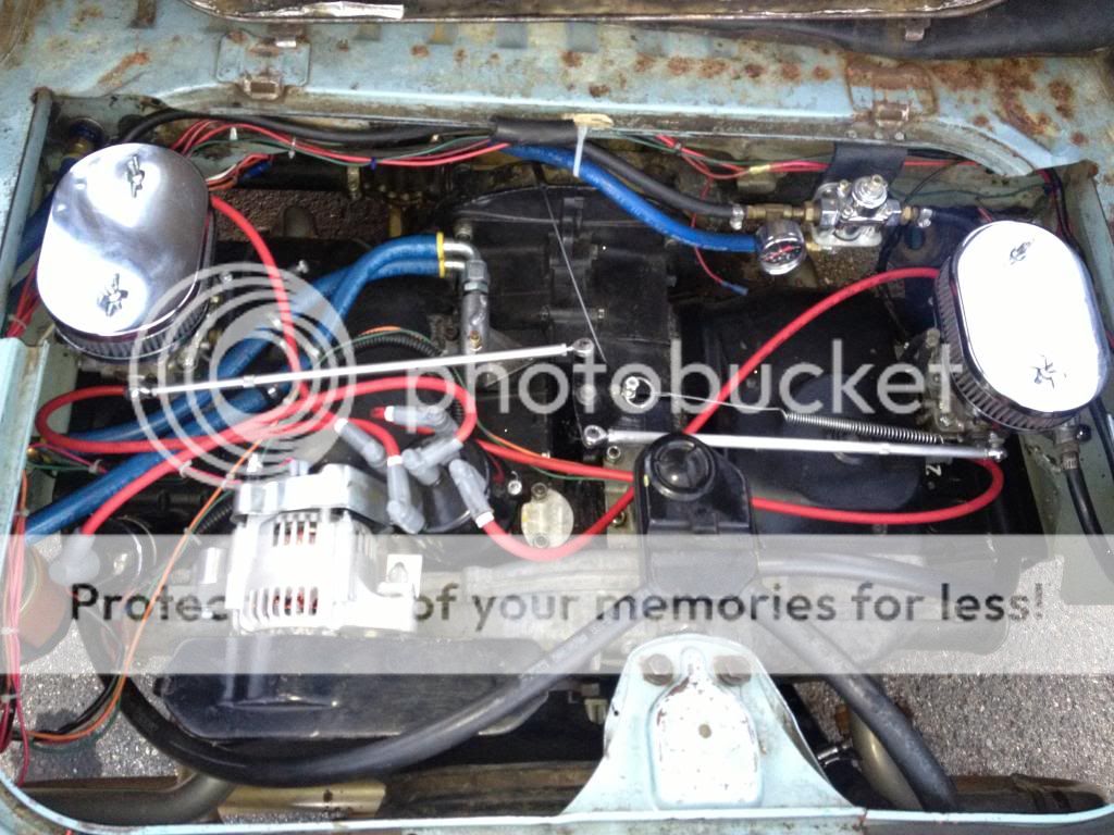

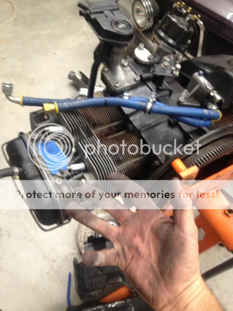

I made reeds for my draw through Ra Jay Martin Turbo using spring steel and shoulder bolts from Mcmaster. Remember that reeds do wear out!
