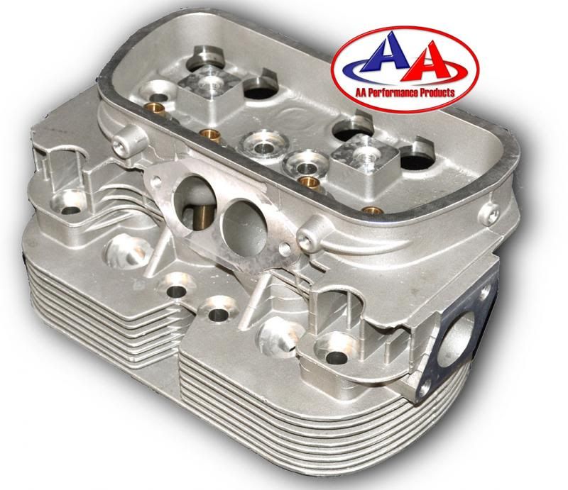

how do you see them as the same castings?& I wonder just how much revmasters did as far as "developement",
57baja
Joined: April 15, 2008
Posts: 1166
Location: Kaddie Shack Temple City
57baja is offline
PostPosted: Wed Nov 20, 2013 2:18 pm    Post subject: Reply with quote
Yes. They are using the same casting from the same foundry, from what I've been told. AA Performance Products has them, too. Who knows who else will be using them in the future, as the people who made them were at SEMA this year showing them. It looks like EMPI has ground off the "049" symbol, whereas the AA version still has remnants of the ring in the casting.
On the one hand, it's a shame for Revmaster if they developed a product and the people who manufacture it for them are now selling it to other distributors. On the other hand, it does make the product available to more consumers through the various dealer networks out there, which will likely drive the price down for the end user.

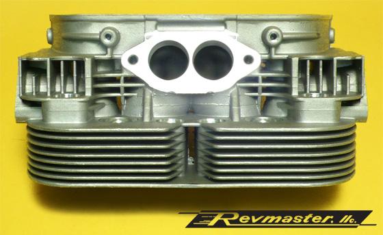

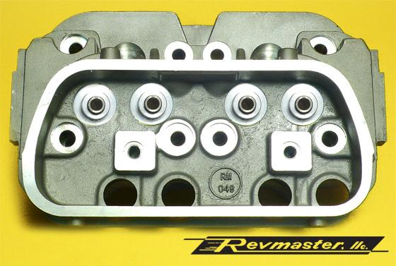

Any other experiences or input from anyone on running the Revmaster 049 heads?
mark tucker
Joined: April 08, 2009
Posts: 23950
Location: SHALIMAR ,FLORIDA
mark tucker is offline
PostPosted: Fri Oct 11, 2013 7:58 am    Post subject: Reply with quote
it's a shame they didnt "D" port the exhaust,add more material under the ex seat&heart the chambers& cast to where little to no porting work is needed. it can be done.
