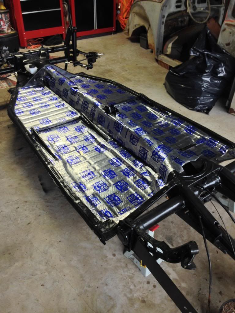

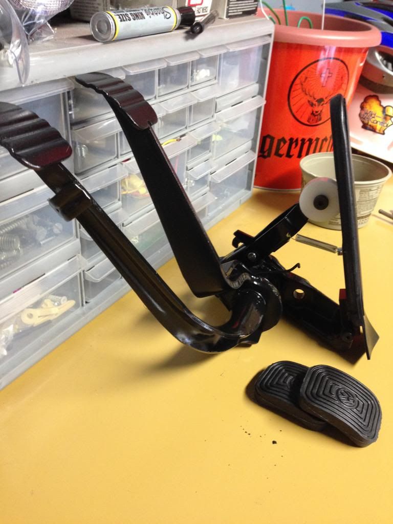

I got to spend some time in the garage today because it was way too cold for cycling today. Spent a few hours installing FatMat (Dynamat alternative) on the floor and tunnel. Overall the stuff is pretty easy to install - and hoping it will cut down on some of the road noise. I also plan on installing inside the doors, trunk area and roof.
Also took the pedal assembly apart, re-greased everything, painted gloss black and installed the Unique Parts Speed Ball conversion kit. This thing really does make a difference on the pedal action.
Next up will install the pedal assembly, start plumbing the back brakes and hopefully get the steering / front brakes finished.
