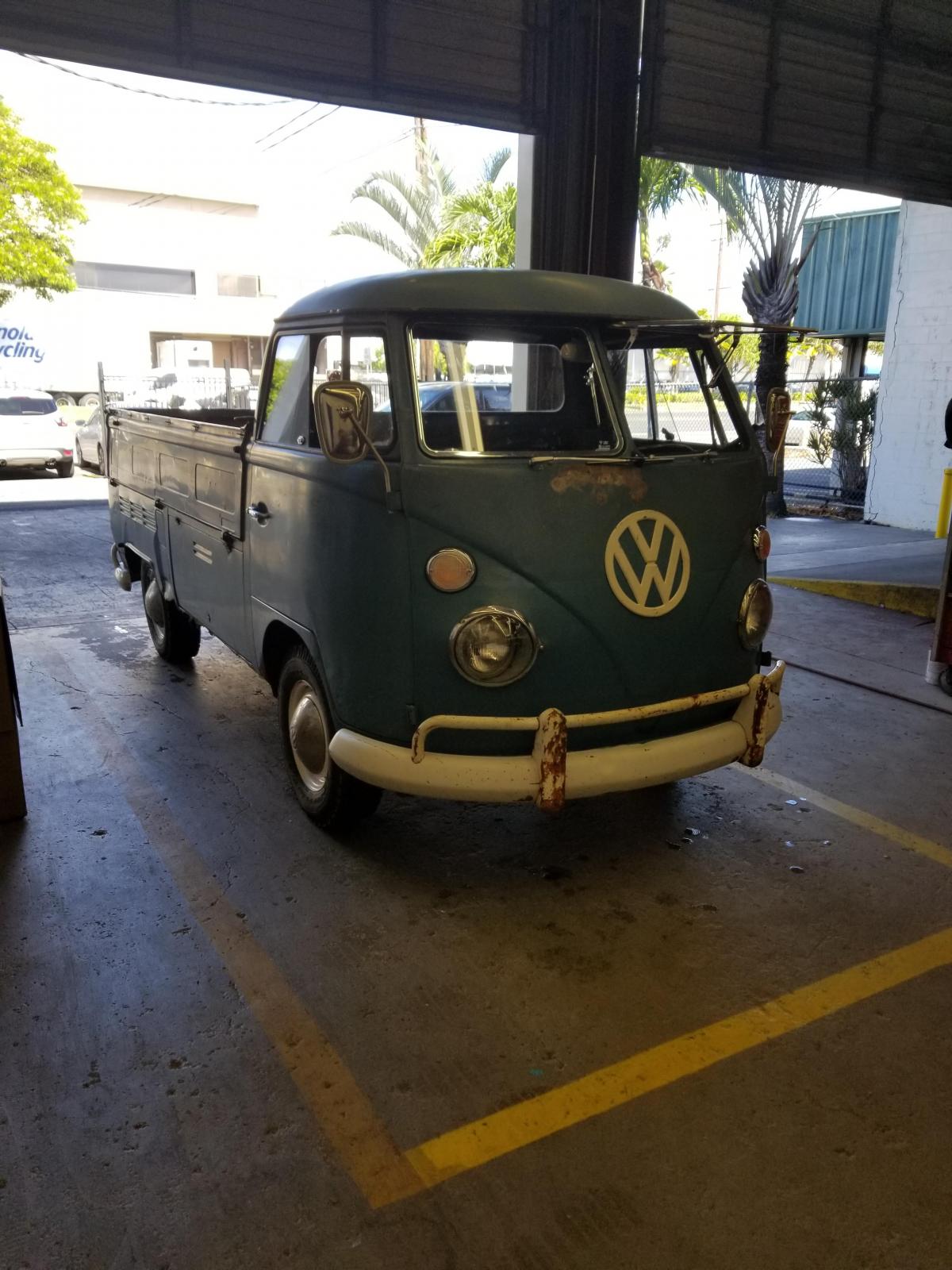

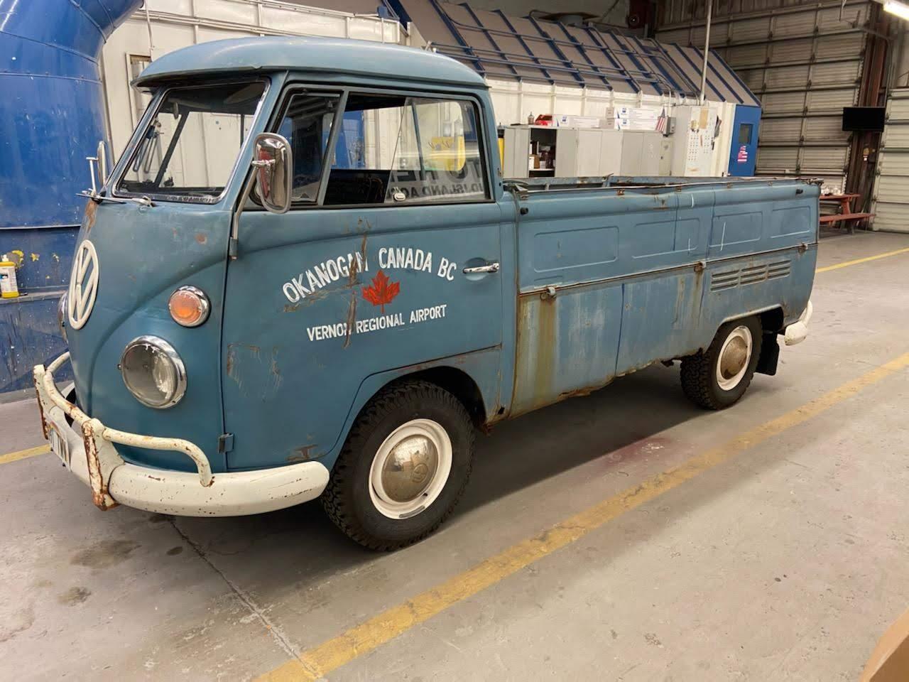

PostPosted: Sat Oct 19, 2019 2:41 pm    Post subject: Re: Advice on Single Cab Purchase Reply with quote
Well it is getting there. Decided to leave the patina and just drive it. The old crusty look is appealing. All 4 rusty hub caps for $5.00!
Found a used pointed front bumper, installed the safari's. At the shop getting a safety inspection, next plates.

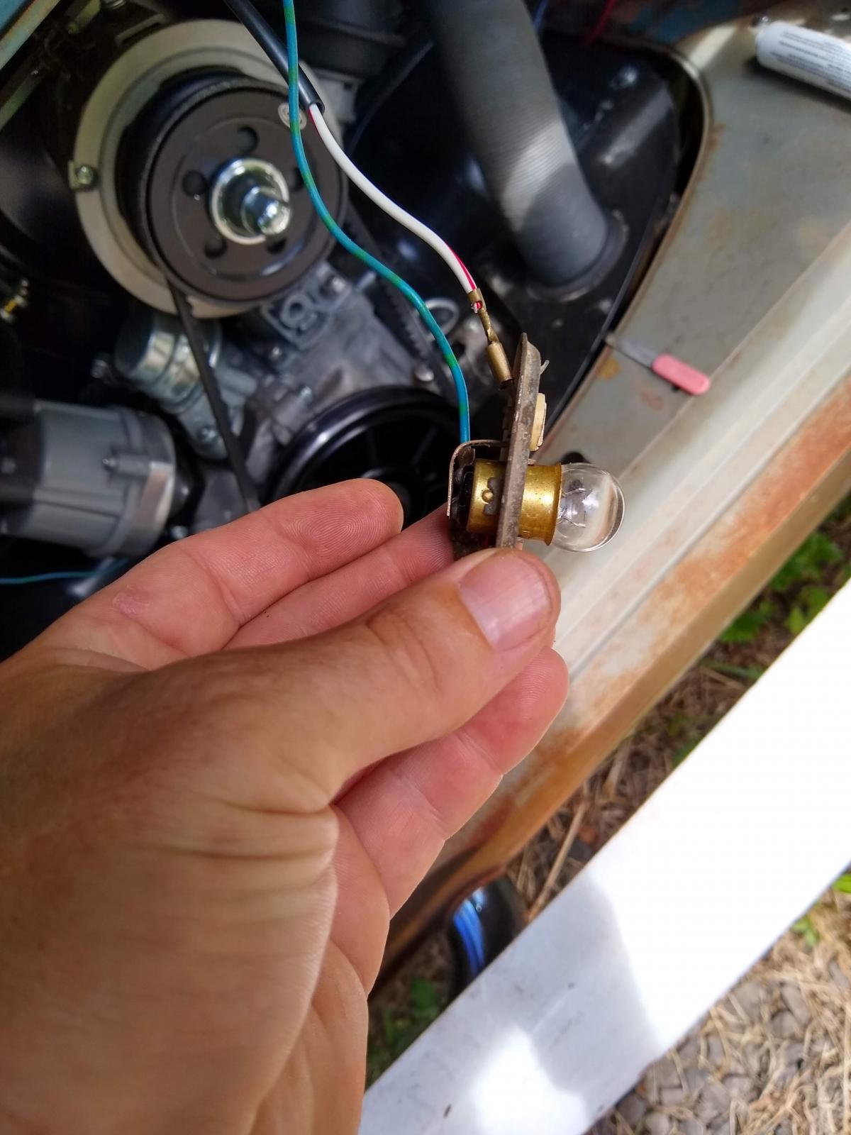

PostPosted: Wed Oct 10, 2018 7:36 am    Post subject: Re: Advice on Single Cab Purchase Reply with quote
Generally the Blue with green wire goes to the oil pressure switch, the white with red wire should go to the + (bottom) of the bulbm and the bulb holder is grounded on the decklid itself.
I know you said you have it worked out so the light works, but does the oil pressure switch work?

PostPosted: Mon Oct 08, 2018 6:42 pm    Post subject: Re: Advice on Single Cab Purchase Reply with quote
Eric&Barb wrote:
nice dad wrote:
Is that a single filament bulb??
If it is, that type of bulb needs a ground to one of the bottom contacts, and positive to the other to work. Does not need positive or negative to the brass base.
Yes it is a single filament bulb with two contacts at the bottom. Someone before me had placed the wrong bulb for the license plate light. I just took it down to the auto parts store and got a replacement. Unfortunately the wrong replacement. I returned the bulb for a single filament/single contact bulb and all is well. Now I just need to ground my taillight buckets and I am all set.
Thanks
1967 Single Cab
Eric&Barb
Joined: September 19, 2004
Posts: 25948
Eric&Barb is offline
PostPosted: Mon Oct 08, 2018 4:35 pm    Post subject: Re: Advice on Single Cab Purchase Reply with quote

PostPosted: Mon Oct 08, 2018 2:49 pm    Post subject: Re: Advice on Single Cab Purchase Reply with quote
easy e wrote:
nice dad wrote:
Well, I am stumped! This darn bulb won't light up. Should this bulb only have a single contact on the bottom? This one has two, just like the original I pulled out to replace.
6 volt = VW# N177191 .... auto parts store # 1156 (6v 10 Watt BA15s)
12 volt = VW# N177192 .... auto parts store # 1156 (12v 10 Watt BA15s)
Thanks very much. I read your thread on license light holders, very informative.
1967 Single Cab

PostPosted: Mon Oct 08, 2018 2:44 pm    Post subject: Re: Advice on Single Cab Purchase Reply with quote

PostPosted: Mon Oct 08, 2018 2:04 pm    Post subject: Re: Advice on Single Cab Purchase Reply with quote
Well, I am stumped! This darn bulb won't light up. I have power and ground with a new bulb. ? Should this bulb only have a single contact on the bottom? This one has two, just like the original I pulled out to replace. Each contact on the bottom is receiving power. I cleaned the corrosion from all the grounding contacts.
Idea's
Thank you

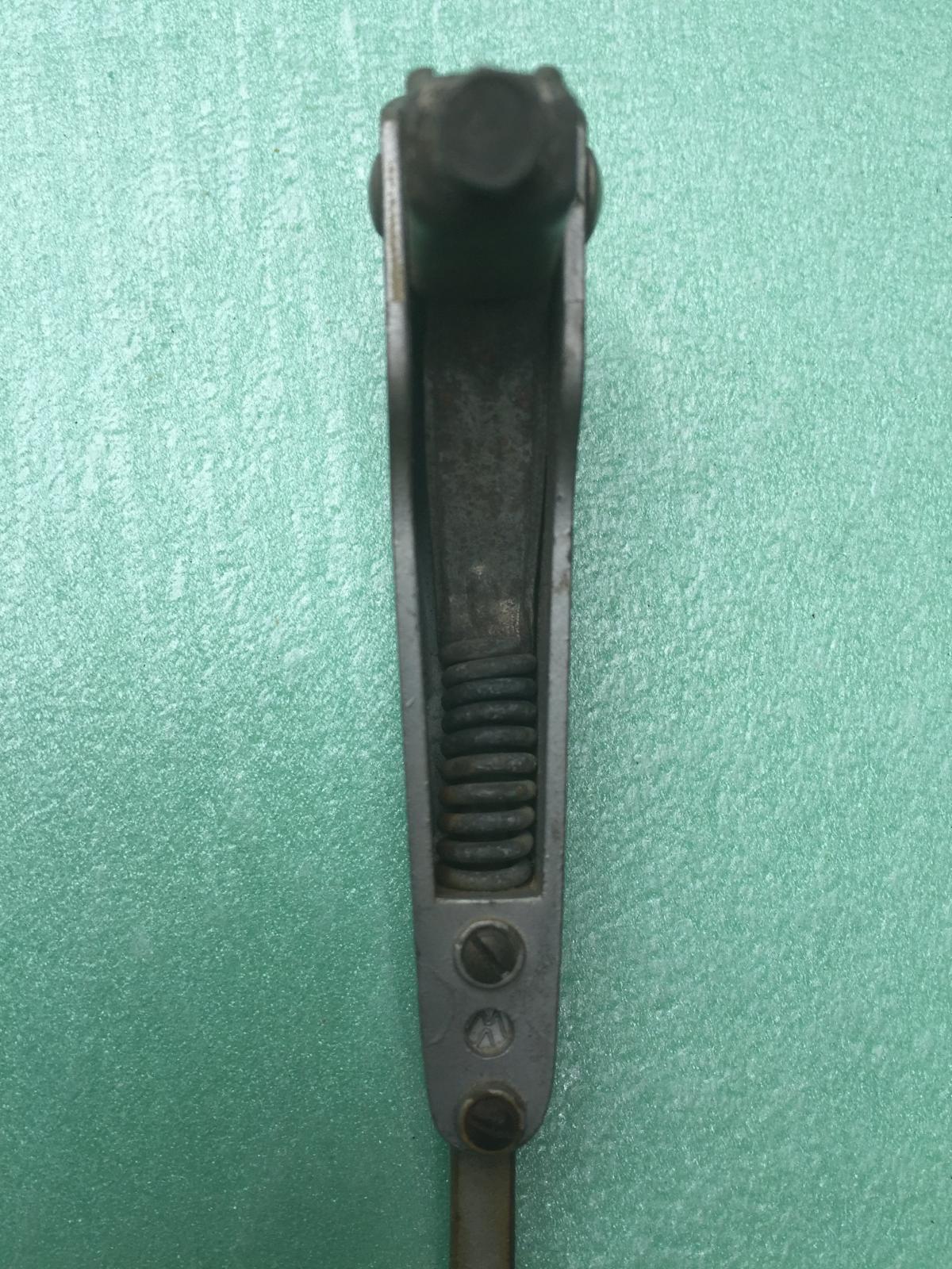

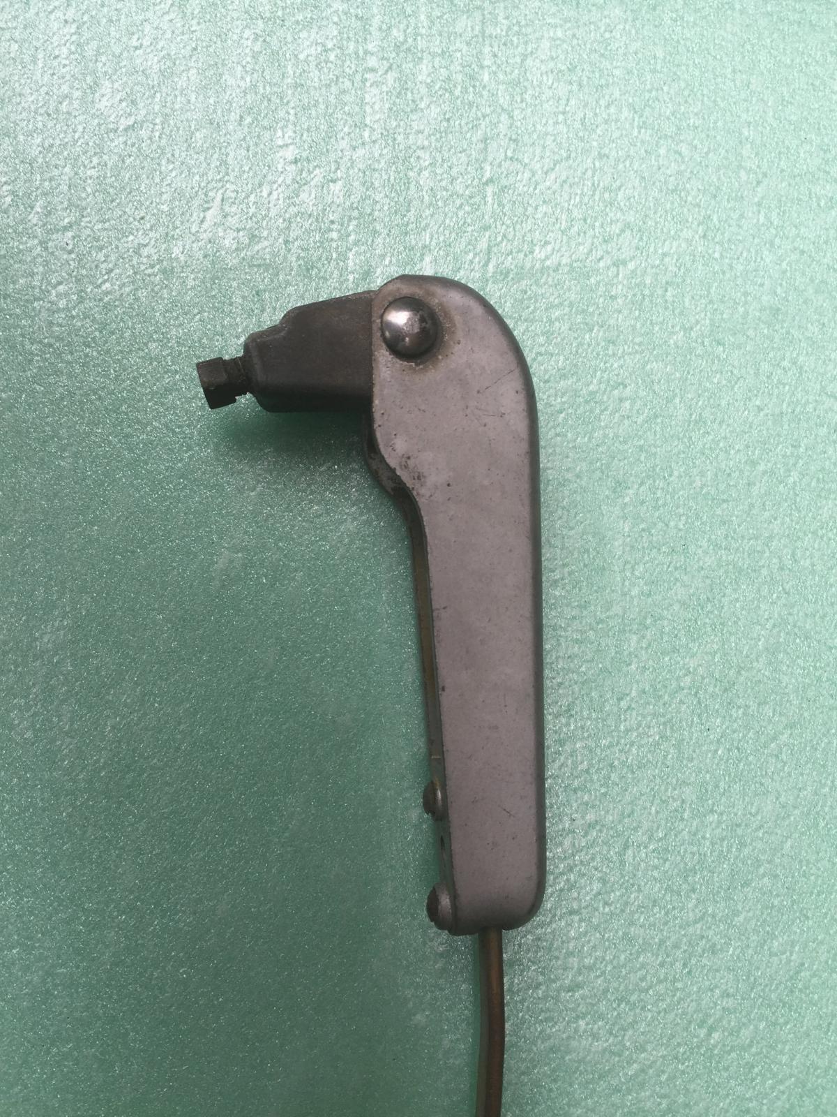

PostPosted: Wed Jun 06, 2018 5:00 pm    Post subject: Re: Advice on Single Cab Purchase Reply with quote
It looks like a 66-67 long-base wiper arm except for the bent end.
Normally the arm is complete flat too - it sort of looks like round stock where it's bent into a curve

PostPosted: Wed Jun 06, 2018 3:08 pm    Post subject: Re: Advice on Single Cab Purchase Reply with quote
Eric&Barb wrote:
Did a search of the split bus forum for "Wipe Arm". Search box feature near upper left of the forum web page. Checked the "Titles Only" to keep the results from being pages and pages.
Got these:
https://www.thesamba.com/vw/forum/search.php?searc...=titleonly
The hook on the first image is a mystery...
Thanks for the search input. Someone may have bent it to fit a more conventional type blade. There was a goodyear plastic wiper on it.
1967 Single Cab

PostPosted: Wed Jun 06, 2018 1:41 pm    Post subject: Re: Advice on Single Cab Purchase Reply with quote
Got these:

PostPosted: Wed Jun 06, 2018 1:19 pm    Post subject: Re: Advice on Single Cab Purchase Reply with quote
Can someone please confirm that this is indeed a 1967 wiper arm and is correct for my SC. This is the only one that came with the SC when I bought it. I have seen some in the classified section claiming to be 1967 but don't resemble what I have.
Thanks!
1967 Single Cab
