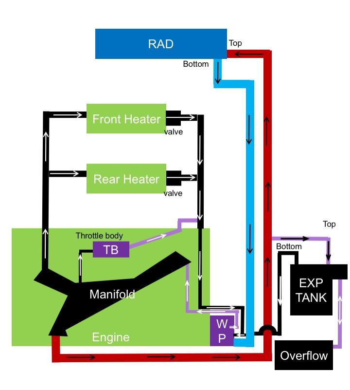

PostPosted: Tue Jan 16, 2018 1:22 pm    Post subject: Re: Syncro + Subaru Cooling Issues Reply with quote
Thanks for that! Yes I use a similar approach to remove air but I use some ramps that I have and the smaller incline in my driveway Smile
Here's the latest system diagram:
Makes sense that all flow would go towards the WP/Thermostat! I've updated the arrows. I think the rest is correct based on what I'm seeing/feeling Smile
Everything is tight and running well so far. I need to make a trip up the mountains though before I'm ready to call it good! Maybe later this week for a little ski day, we'll see.
Thanks for the posts/help! I'll update on how things go up the mountain!

PostPosted: Mon Jan 15, 2018 5:39 pm    Post subject: Re: Syncro + Subaru Cooling Issues Reply with quote
On your diagram the purple line from the manifold to the WP might flow the other way if this is the feedback to the thermostat. After filling mine,I drive it around getting it up to temp,then park it nose down and check the expansion tank after it cools a few times. In between, I'll park it nose up,rev it a bit then open the bleed at the rad. Luckily,I have a slope in my front driveway.

PDXSyncro
Joined: August 25, 2010
Posts: 135
Location: Portland OR
PDXSyncro is offline
PostPosted: Mon Jan 15, 2018 12:55 pm    Post subject: Re: Syncro + Subaru Cooling Issues Reply with quote
Quick update as I'm working through this now!
I changed the hoses out from top to bottom so now my current system diagram is this:
So now with the changed hoses at the expansion tank at start of engine I'm seeing flow into the expansion tank from the top tube coming from the line that goes from the coolant manifold to the rad! The other direction lines I've added but I'm unsure of as of yet. I'll go back and once cool feel around to see which go hot first!
I also ran a pressure test and found a few small leaks. One of which was at the coolant sensor on the expansion tank!Shocked It was small bubbles but slowly losing pressure. So I pull it off, cleaned it up and and put some new gasketing on the threads and re-installed. It's holding now! Smile I tightened up the few areas that were showing some drippage and reran my pressure test holding 11 PSI for 30 min. All good!
Next filled it up and went for a drive and got it up to running temp. However the temp gauge is sitting only about a 1/4 up. It's halfway between the LED and the low end blue area of the gauge. After driving for a while and getting heat from the front heater I brought it back and checked temps at various areas. I found 193deg at the coolant manifold just before it goes to the hose heading to the rad. The next reading was 185deg at the coolant temp sensor on the coolant manifold. All seems quite low to me! No??
It's cooling now and I'll check for more air and refill.
Thanks again for the comments and please keep them coming! Very Happy

PostPosted: Mon Jan 15, 2018 11:31 am    Post subject: Re: Syncro + Subaru Cooling Issues Reply with quote
One way to confirm the direction of flow is to start with a cold engine and then place your hand on the heater lines until you notice which one is getting warm first.
Dave O
The Western Syncro build
PDXSyncro
Posts: 135
PostPosted: Mon Jan 15, 2018 9:36 am    Post subject: Re: Syncro + Subaru Cooling Issues Reply with quote
Thanks for chiming in! So if I were to swap my top and bottom then it sounds like I’d have your design equivalent, is that right?
Also do you know if that heater circuit that runs from the WP up to and on top of the right side of the engine is going to the heater core or returning from? I always that it was the return and going to the heaters was from the manifold but I’m unsure!
Many thanks!!!

Not sure if it makes any difference for you, but my expansion tank has hot coolant from the manifold entering thru the top and out the bottom (in my case to my heater circuit). In other diagrams I have it's the same flow including the JHA diagram I have on file for a SVX. (pdf only so I can't upload it). Also check that all your clamps are tight.
