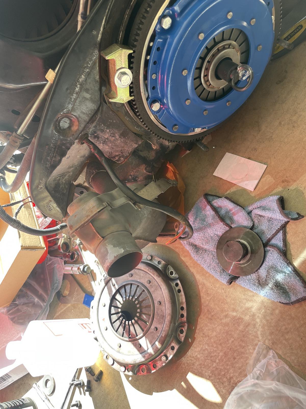

PostPosted: Sat Nov 08, 2025 3:44 pm    Post subject: Re: Official Mexican / Brazilian Beetles - All years Reply with quote
Well, finally had time to work on the clutch and alternator. Friends have been helping and we've run into a problem.
1. The OEM alt pulley doesn't fit the new alternator since it has the fins. Hopefully a normal one will be okay. It's on order.
2. See clutch pic. New clutch has insert that old one( silver) doesn't. However, considering how I couldn't get the engagement point to go below the very top 3rd of travel of the pedal, I'm thinking maybe that's why? Loosened the clutch nut and the clutch would slip, tighten and it would grab more but the engagement point wouldn't go down very much. Most I got it to lower was maybe 1/4 of the way from the top of pedal stroke. All my friend's bugs clutch engages at the very bottom of the pedal stroke. old clutch and new clutch seem to be about the same thickness though, but there was a ton of black dust inside and some oil at the bottom. also, those fingers I'm guessing here, should not jet out past the plate right? Or is that normal? Should I leave that ring on there or take it off? If so, how? seems to be clamped on.
3. fuel lines are pretty shot so got some new stuff...5/8 seemed the closest size.
4. Geez this thing is a pain to take apart compared to cars with carbs. Razz
I'm dreading the reinstall.
some pics from summer time included.
