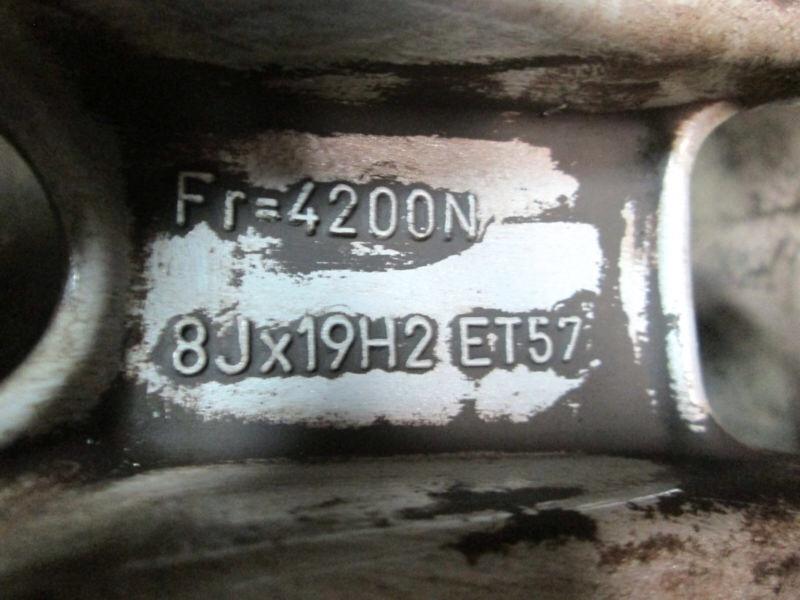

PostPosted: Tue Dec 02, 2014 5:38 pm    Post subject: Wheels for Cayenne brake project Reply with quote
Luckily Chris and I discussed the brake kit in detail via email. We both agreed it should be designed in a way that would be able to accommodate any wheel with out having to redesign the whole kit each time. If I understand correctly only 1 or 2 parts need to be modified to place the brakes more inboard or outboard for different wheel offsets as well as bolt patterns. That being said my cayenne 18x8 were not 100% satisfactory to me as they would still catch the inner fender lip on occasion and stuck out a tiny bit too much for my liking. I sacrificed tire rotation, and ride comfort for looks. I have yet to hit 40 years old so maybe I'll regret that in a few years Smile
This is another guys van pictured below. It has the actual wheels that I purchased from him off of the Seattle CL. These have the highest offset ET57 of any stock 19" Porsche bolt pattern wheel you can find in the 8" width. This allows the rim to be tucked into the fender significantly more than the 18x8 size on previously because the upper A-arm is cleared by the extreme diameter. This allows for less "thickness" of spacer/hub assembly required. The fronts also have a convex "dish" that allow plenty of room for the brake parts. They are also some of the lightest factory 19" wheels you can get:
19x8 = 22lbs
19x9.5 = 24lbs
14x6 factory vanagon alloys = 18 lbs
This compares to hollow Porsche cup twist wheels and drops 5 lbs per corner compared to solid Porsche cup twist wheels of an inch less diameter and for only $700! $2000+ is the cheapest you will find a nice flawless set of hollow spokes.
Hollow 18x7.5 = 20.8lbs
Solid 18x7.5 = 26lbs
Hollow 18x10 24.5lbs
Solid 18x10 29lbs
T3 has an an air cooled single round headlight van sporting them on his web site and is the one who suggested them.
This is a photo of a real Porsche with 19"x8" lobster claw wheel with 'similar' brakes I'm guessing
Offsets/size
rear
Front
I've got the vanagon fever
