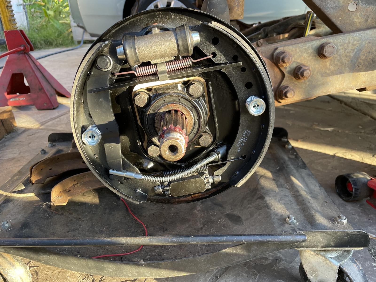

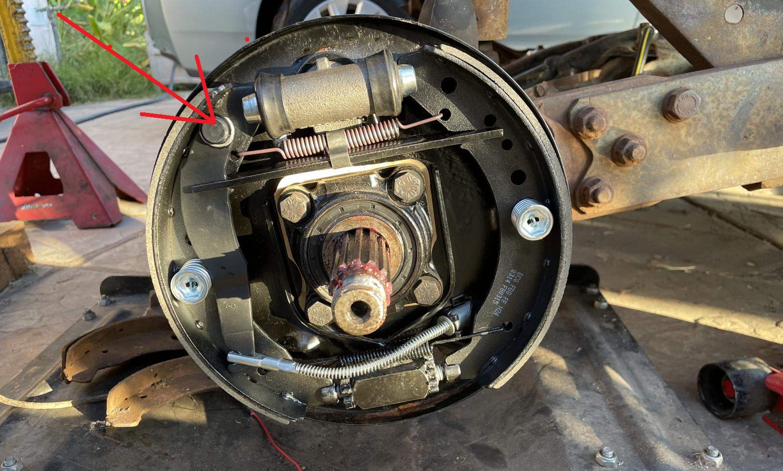

PostPosted: Thu Jun 26, 2025 7:36 am    Post subject: Re: The Stupid Question Thread Reply with quote
EVfun wrote:
Look at the ebrake lever attached to the left brake shoe. See the pin at the top? Your part goes on the back side of that pin to keep it from falling out of the brake shoe. It is pinched together at the ears slightly to hold it into a groove on the pin.
That "horseshoe clip" goes on the hidden side of the pivot pin highlighted with red arrow in this photo.
These clips typically get re-used every time one installs new rear brake shoes. The clips and giant cotter pin do not come with a set of rear brake shoes, unfortunately.

PostPosted: Thu Jun 26, 2025 7:03 am    Post subject: Re: The Stupid Question Thread Reply with quote
NachoCar wrote:
what/where in rear stcok brakes does this sucker go? Fell out as I was using BFH to switch drums out.
Thanks
Look at the ebrake lever attached to the left brake shoe. See the pin at the top? Your part goes on the back side of that pin to keep it from falling out of the brake shoe. It is pinched together at the ears slightly to hold it into a groove on the pin. (picture from 70'DerpyDerby)

PostPosted: Thu Jun 26, 2025 6:47 am    Post subject: Re: The Stupid Question Thread Reply with quote
Thanks
