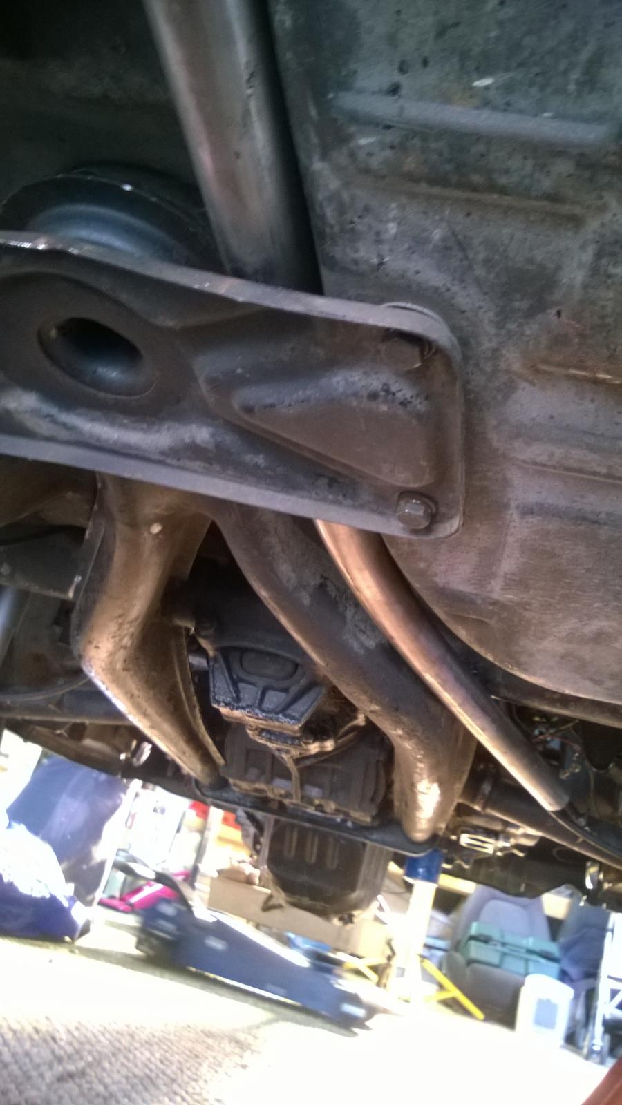

Here's my shortened sump. It's a stock sump shortened and budged. Holds the stock amount of oil and the dipstick reads true with no modifications.
My sump is a blatant rip off from ricola racing. Click on the beetle, then engine fitting and half way down the page is the sump build.
http://www.ricola.co.uk/
Mines got a turbo by the way Smile
