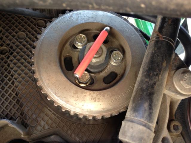

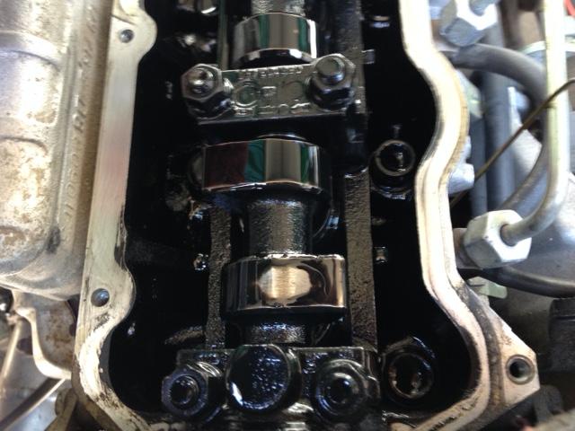

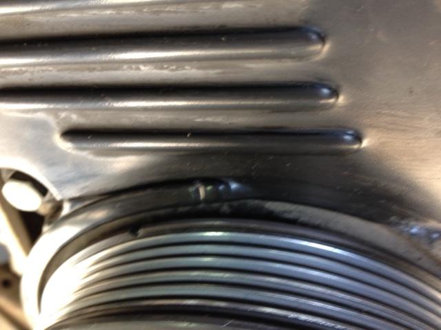

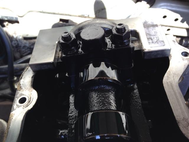

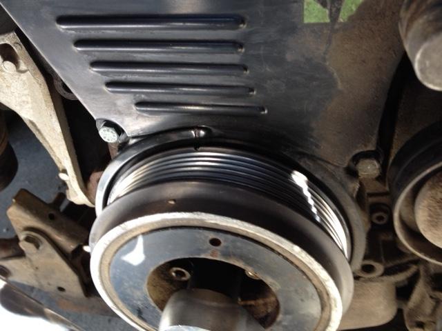

Ok, so I finally dug into this project today.
For future reference, here's what the mark on the harmonic balancer looks like when lined up with the corresponding mark on the lower timing belt cover:
As I feared, however, when the camshaft and injection pump are locked in place, this mark is way off, possibly a tooth or two off:
Mark when cam and IP are locked:
#1 lobes up:
Camshaft lock in place:
IP lock in place:
I have pulled the #1 cylinder glow plug, and am trying to find TDC using the old school method described elsewhere in the thread. I'll be interested to see if the marks actually line up at TDC.
I have no reason to believe that anyone who worked on this vehicle previously had the slightest idea what they were doing, and I would not be at all surprised to find that the timing had been a tooth or two off.

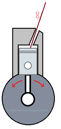

When the belt has been of for some reason I've done it like this several times with good results.
  1. Everything is referenced with the first cylinder. Remove the glow plug or the even better the injector for the first cylinder.
  2. Use a long metal rod (welding rod is perfect) and let it rest on top of the piston. Turn the engine slowly until you reach the point where the rod is standing still and starts moving down again. Vision is good but with a finger resting on the rod you'll be amazed how accurate you can be.
  3. Turn the engine back and forth a few times to find the two points where the rod stops moving and the point where you have the smallest movement noticeable again.
  4. You have now found the two points that are the entrance and exit points for the crest of the TDC. This means, right in between these two points you have TDC.
  5. If you can you should now mark it up with a drill mark or similar on the flywheel.
Actually, the TDI tools used to find TDC comes with pretty bad tolerances (the locking pins that are used can make the TDC float several tenths, over a degree in flywheel angle) and a tuning workshop or performance tuner always measure the TDC each time to make sure they are spot on.
