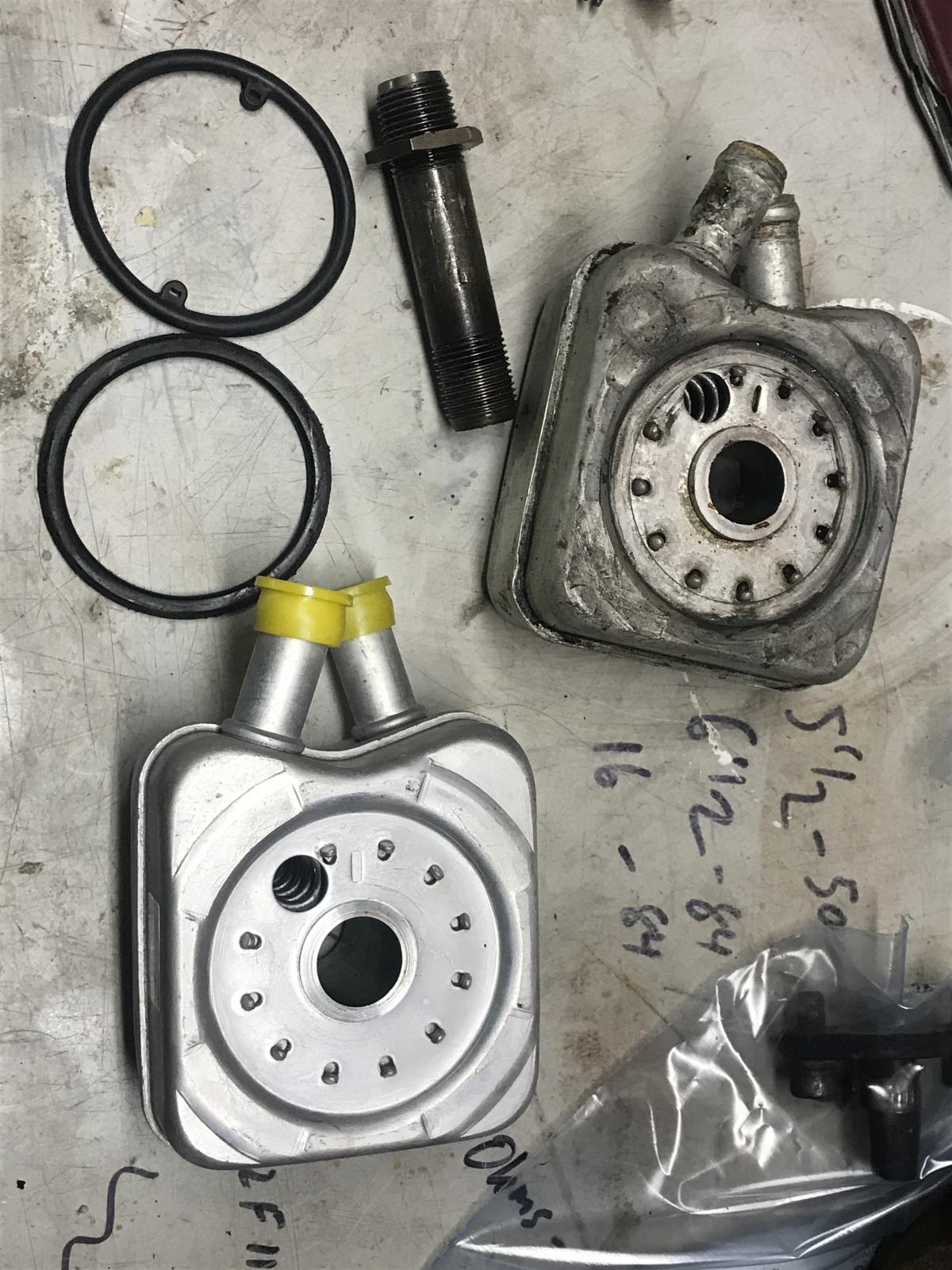

PostPosted: Sun Feb 07, 2021 2:29 pm    Post subject: Re: Quick and Easy WBX Oil Cooler Seal Replacement Reply with quote
Here is a photo of the old style and new style oil cooler Orings.
The new style has the little eyes molded on to hook onto the oil cooler before you install it.
Dave

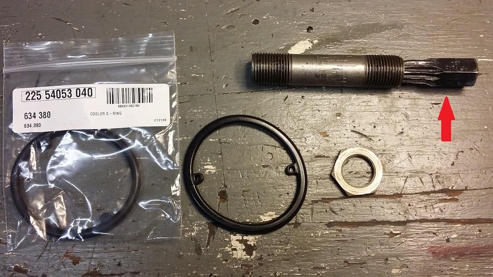

PostPosted: Sat Feb 06, 2021 6:05 pm    Post subject: Re: Quick and Easy WBX Oil Cooler Seal Replacement Reply with quote
I just did this today in the driveway. Might have been the quickest replacement of anything on my GL, in 23 years of ownership.
A mechanic loaned me the GM heater bit when I bought the $4 seal from him.
I had to taper the end of bit slightly w/file to fit ID of pipe, tapped it in...sort of went in crooked a few mm & used a 5/8 socket on the bit. The double threaded pipe came out easily.
Popped new seal in w/mini inner locating index's on the seal with the circular barbs, after cleaning area, tightened everything up, though I just went by feel, not by torque specs, as it felt loose when removing.
Probably should have used a torque wrench, but didn't.
I bent the old flattened seal in half & it cracked after bending it maybe 20 degrees.
Thanks 61scout for posting your solution as I just changed the oil/filter & then noticed the leak ugh, but only lost a few ounces removing the oil filter only.

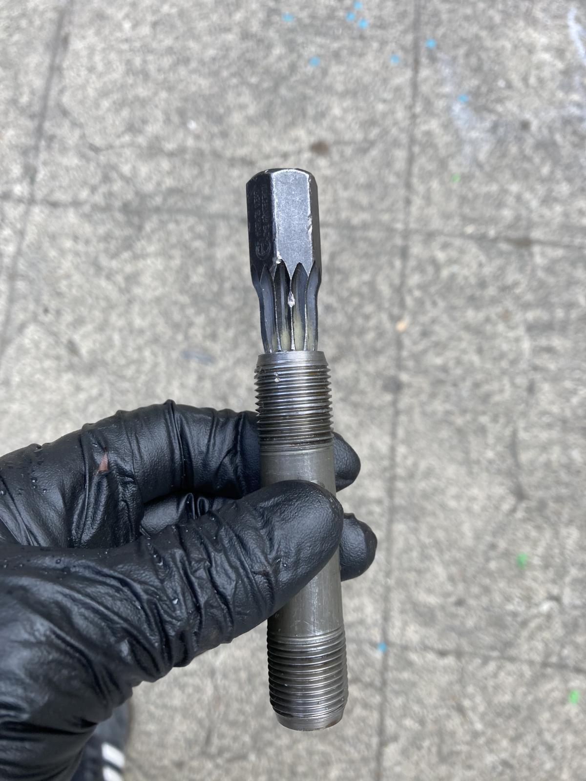

PostPosted: Wed Jun 14, 2017 9:33 pm    Post subject: Re: Quick and Easy WBX Oil Cooler Seal Replacement Reply with quote
Hi everyone. So I had to do this job today, but I found my Cornwell T55 wouldn't catch the inside diameter of the tube. So I rummaged through my drawers and found a solution I thought I'd share with everyone. Especially since the photos are gone from this thread. Think
In any case, the tool I found that works is designed to remove heater fittings from the intake manifolds on Chevrolet V8s. They commonly will break off. I'm sure I bought mine from one of the tool trucks when I was wrenching on the line, but I also found that Lisle makes one. I would assume it's the same size since it's made to remove the same fitting. It's Lisle #62200. Looks like Dorman makes one too, their number is 800-408.
https://smile.amazon.com/Lisle-62200-Heater-Couple...ol+remover
I did have to slightly modify this tool. The one I had has a definite step to it, which didn't allow the tool to grab the ID of the tube. But the tip itself could go in, so I simply tapered the step away at the grinding wheel. Now the tool works like a champ. The best part is that it has several teeth and is also designed to be hammered into place.
Proof:
So if you're looking for an alternative to the SnapOn T55, the GM heater fitting removal tool also seems to do the trick.
-Kevin
