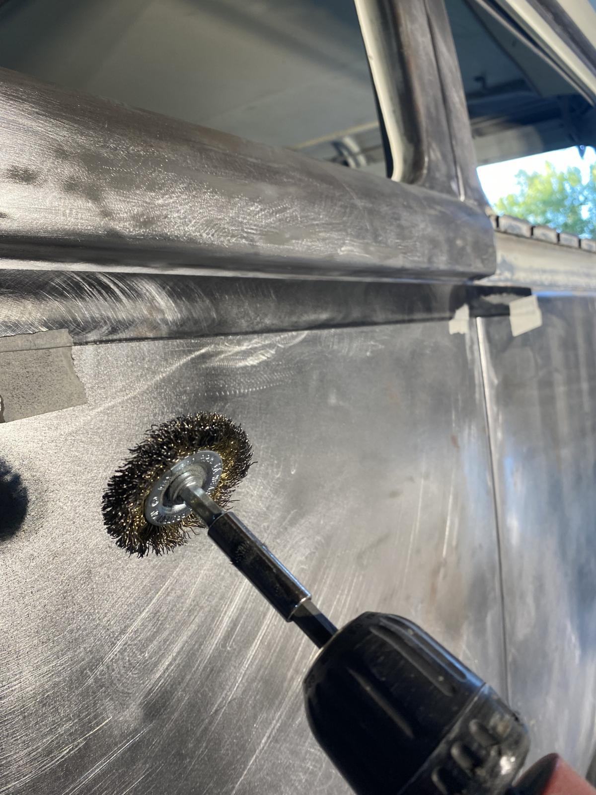

i used a wire brush on a drill for stripping paint in places,I found that the hub of the wire wheel disc was marking the sheet metal,so i used a peice of crate straping to protect the panels

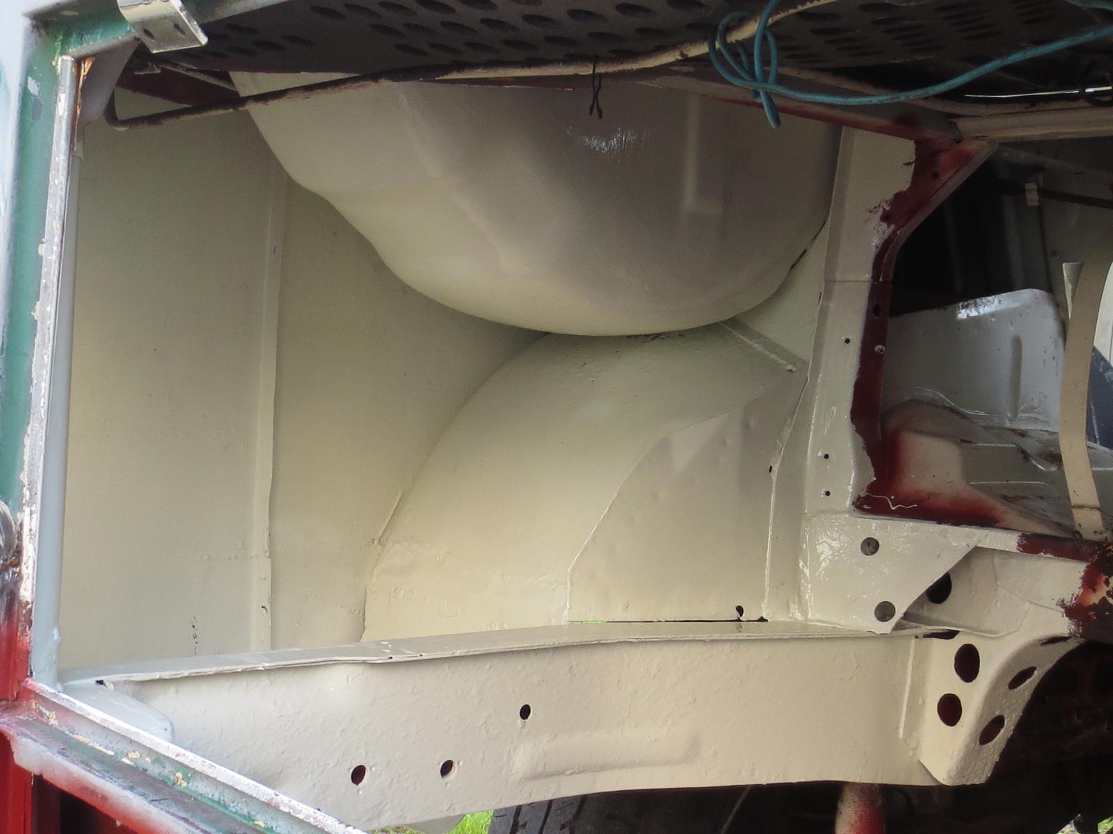

key word slowly lol, i may get some paint on it soon,my plan is the treat it with rust mort and epoxy primer,do the filler work then paint,and get it put back together ,and i have to pull the dash again to treat the front where i had welded it.also planing to close those two utility holes,

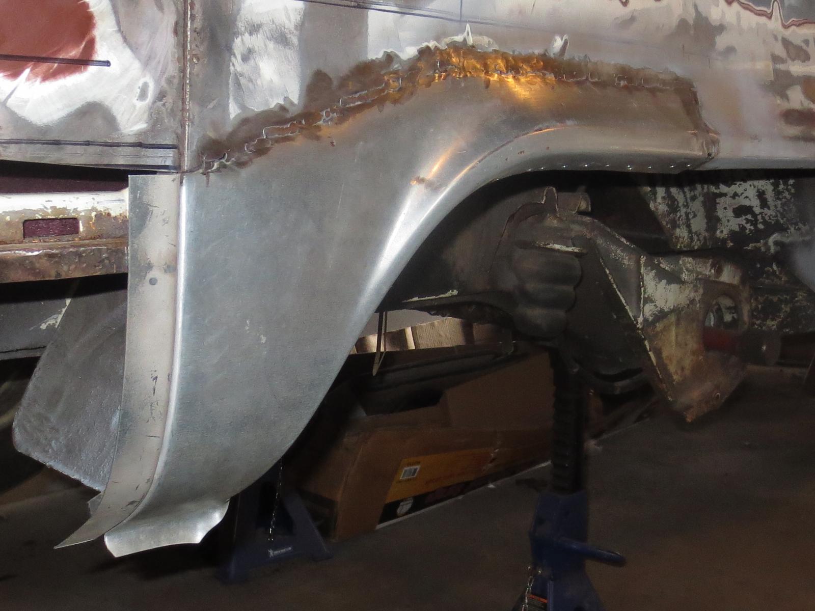

PostPosted: Tue Aug 12, 2025 1:45 pm    Post subject: Re: 74 bay window campmobile rocker rust,corner rust Reply with quote
lil-jinx wrote:
ran it for about 30 minuits,that the longest it as ran in 15 years blowing a little smoke,but it seems to be clearing up,been working on getting it ready for paint
https://youtube.com/shorts/Z-ikGjzIa84?si=fcjZ-SuJKDEYt-Ya
Very encouraging to me to see a van with all the same issues as mine, and it slowly coming together. Thanks for the great pictures, especially the wheel arch repairs.

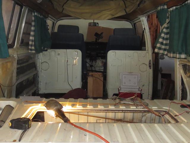

PostPosted: Sun Aug 03, 2025 8:20 am    Post subject: Re: 74 bay window campmobile rocker rust,corner rust Reply with quote

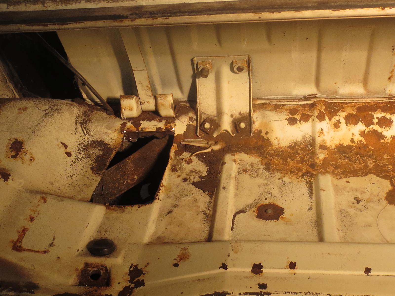

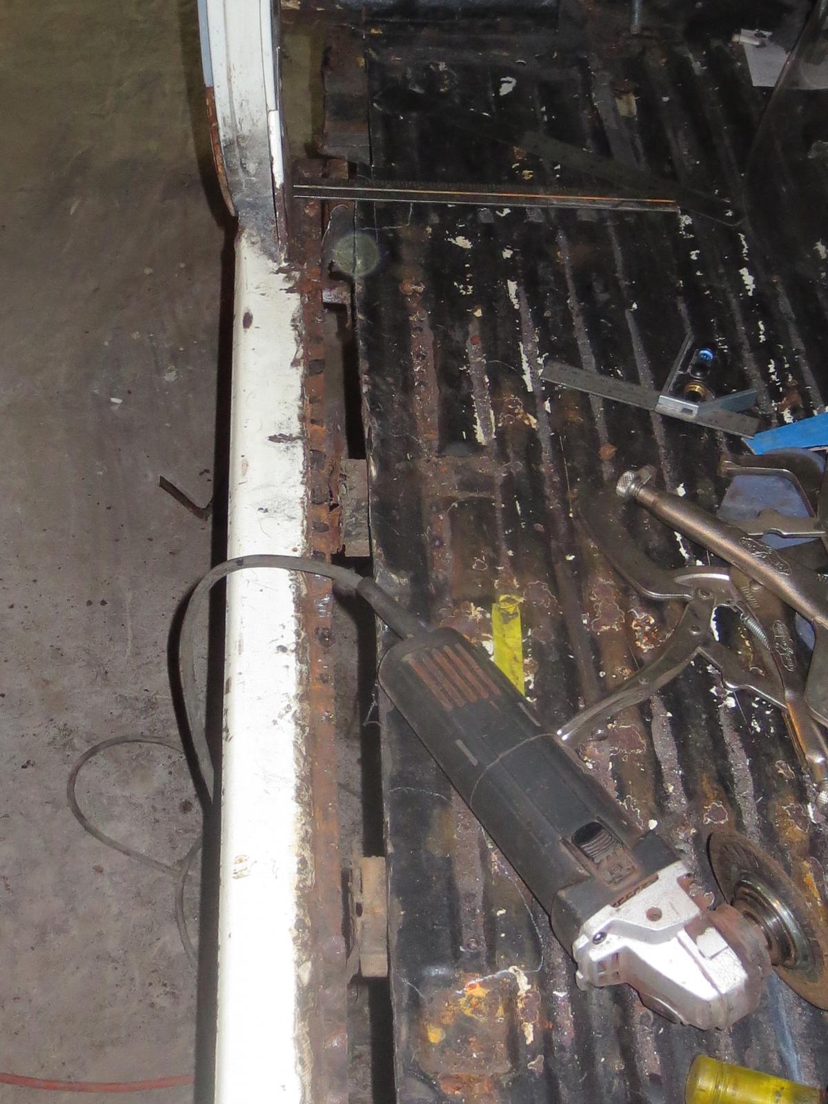

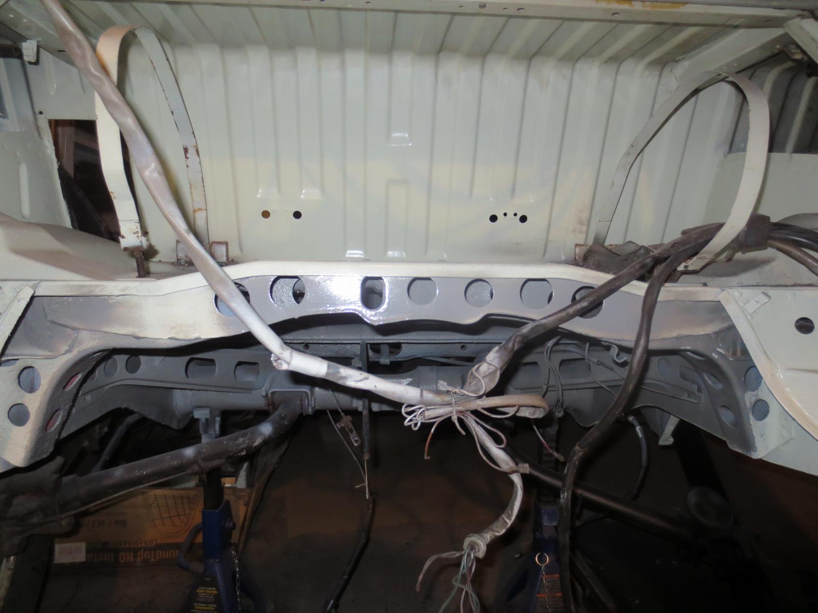

PostPosted: Tue Mar 04, 2025 10:22 am    Post subject: Re: 74 bay window campmobile rocker rust,corner rust Reply with quote

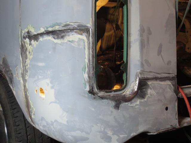

get to the last of the rust,finally rear hatch window frame and the bottom of the hatch needed work,
a little more caution with the grinder is needed,
it appears i have a hatch from a 72

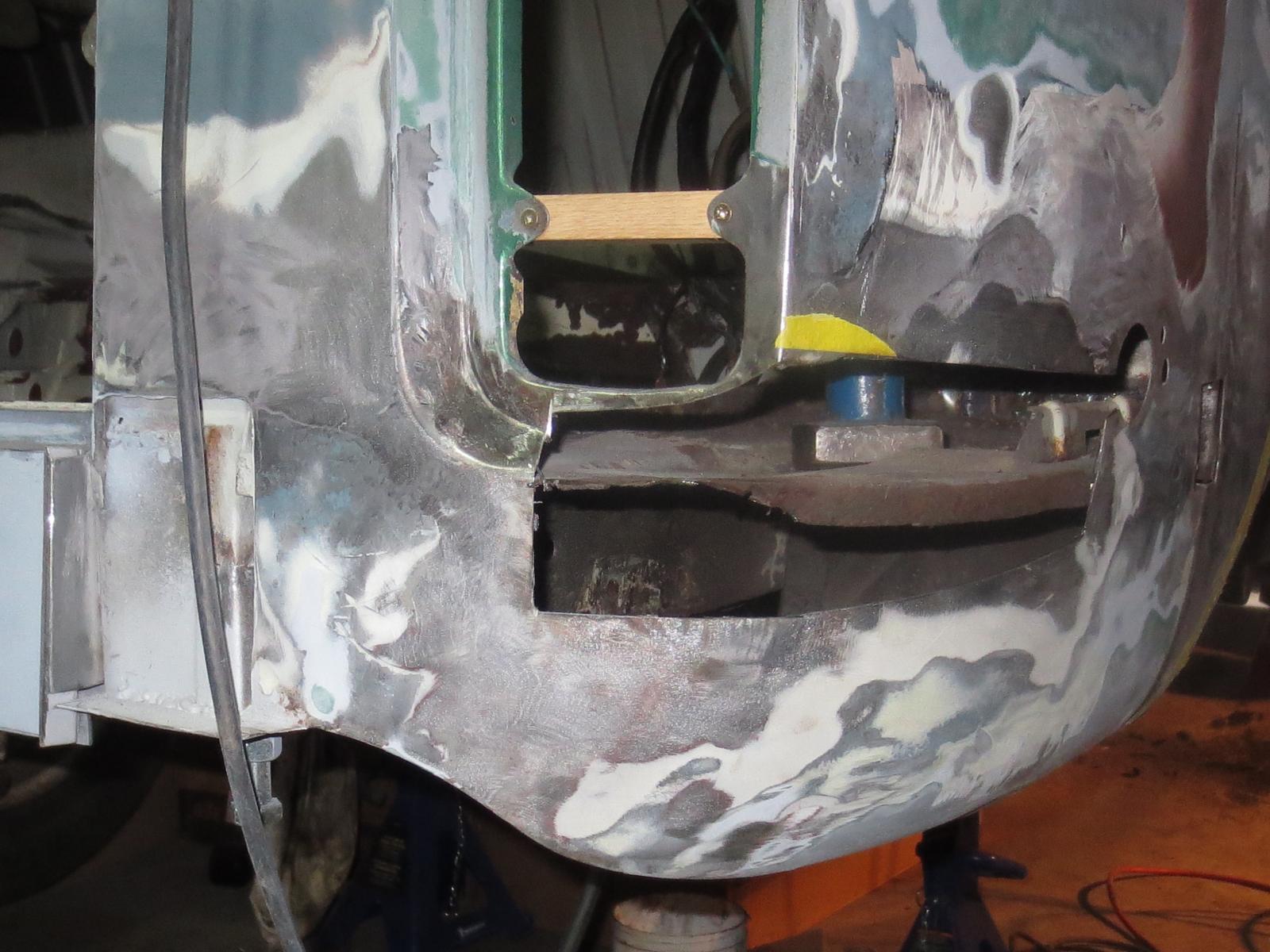

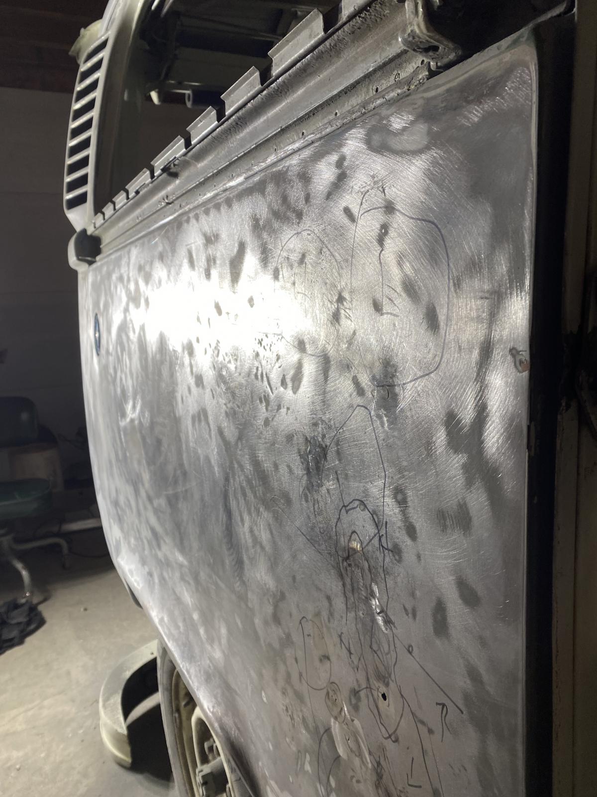

PostPosted: Fri Feb 14, 2025 10:34 am    Post subject: Re: 74 bay window campmobile rocker rust,corner rust Reply with quote

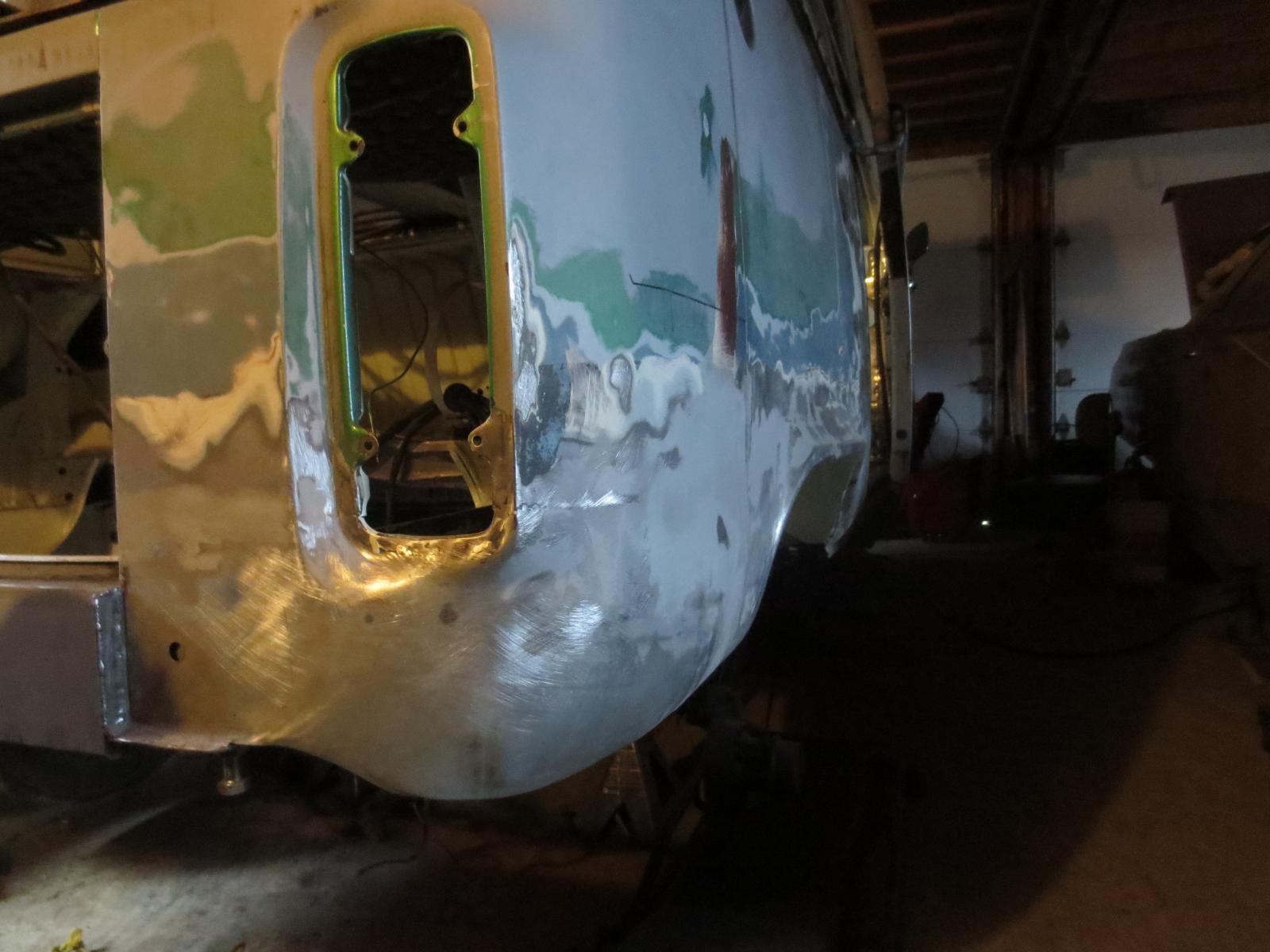

sanding and trying to straighten the panels,bus has had 3 color changes and the white was done twice,looks like she was involved in 2 accidents on the right side,first one seemed to have hit the door ,took out the B pillar and destroyed the sliding door,resulting in a replacement door from a earlier bus,then she was hit again damaging the slider and the quarter panel,i have chipped off the body fill and worked the panels into a more flat shape.
I plan to take it to bare metal,apply ospro to all the metal,then when the warm weather comes i will skim coat it and single stage paint,may use rustolem,we will see,have not settled on a color yet,thought about staying with the L90 buy I like the aqua blue,with white

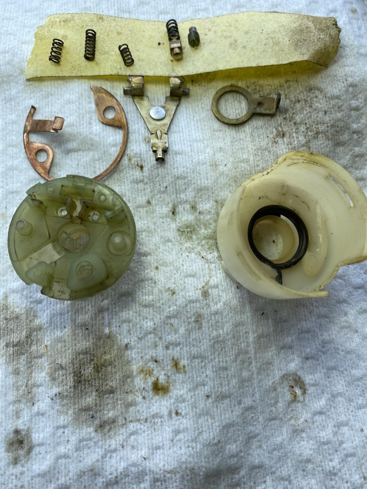

Plan B--- took the ignition switch apart,found the plastic had melted a little around the terminal for cranking and the terminal was sunk a little in the housing,I pushed the terminal in some and cleaned off the melted plastic,bench tested and it is working.
now to install it,this ignition is from a july 74 bus ,my bus is oct 73,the ignition is a little different,on Ethel you have to push in on the key to turn it,on the july one you don't need to push it in,but after a crank cycle you need to turn the key off to start another crank cycle,so I'm debating if I need to also change the complete unit or just the electric part.

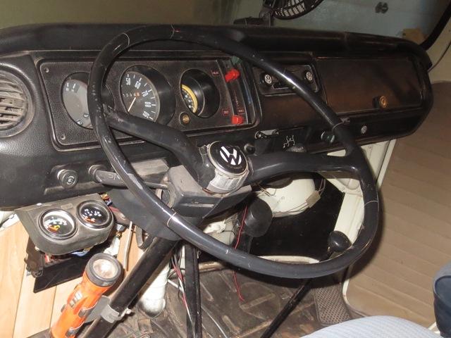

PostPosted: Thu Sep 12, 2024 5:17 am    Post subject: Re: 74 bay window campmobile rocker rust,corner rust Reply with quote
I think i found my problem with the coil power,suspect ignition switch,I have another switch without the key,I tried my bus key in it and it fit ,happy happy,plugged the new/used switch in and it supplied power to the coil while in the crank position,not so happy,it don't crank the bus.
thinking of installing a push button start switch,
1968 Dune Buggy sold dec 2024
1974 parts bus
lil-jinx
Joined: August 14, 2013
Posts: 1792
lil-jinx is offline
PostPosted: Tue Sep 10, 2024 2:21 pm    Post subject: Re: 74 bay window campmobile rocker rust,corner rust Reply with quote
started it up today,first time in a very long time.run into a hitch when starting,it cranked good but no go,checked and it had no spark,a couple of times it started right at the end of a crank cycle,found I was losing power to the coil when cranking,so I'll have to check that out.
But it was a happy day,got to drive it around the yard (1st gear only with a little reverse,first time i have seen it move on it's own power,and the first time I ever drove or even rode in a bus,big smile.

4 years later and I'm getting back at it,started with sorting out the wiring and put the dash top on,engine cranks with key,still have a bunch of odds and ends to do,and rechecking that which i have done or half done,first on list is make it mobile.

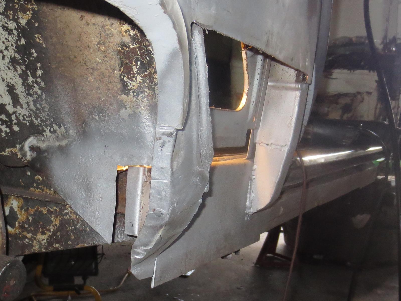

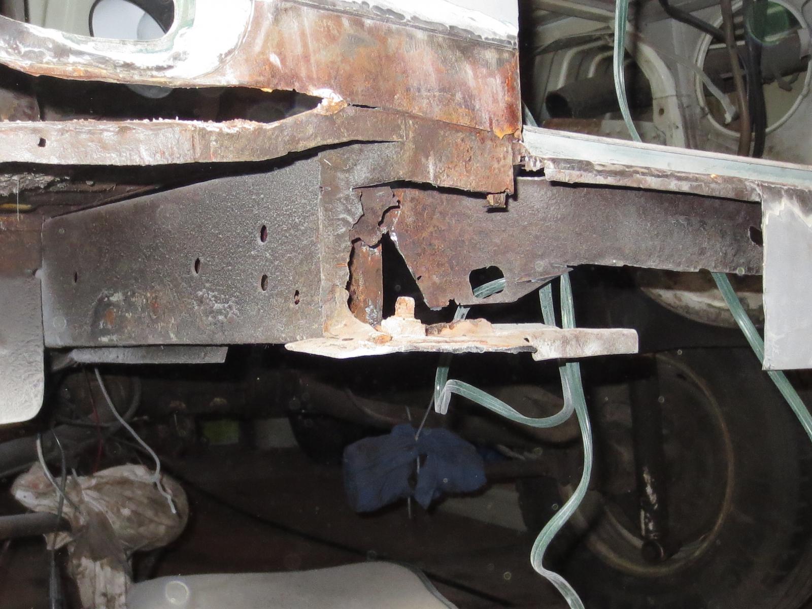

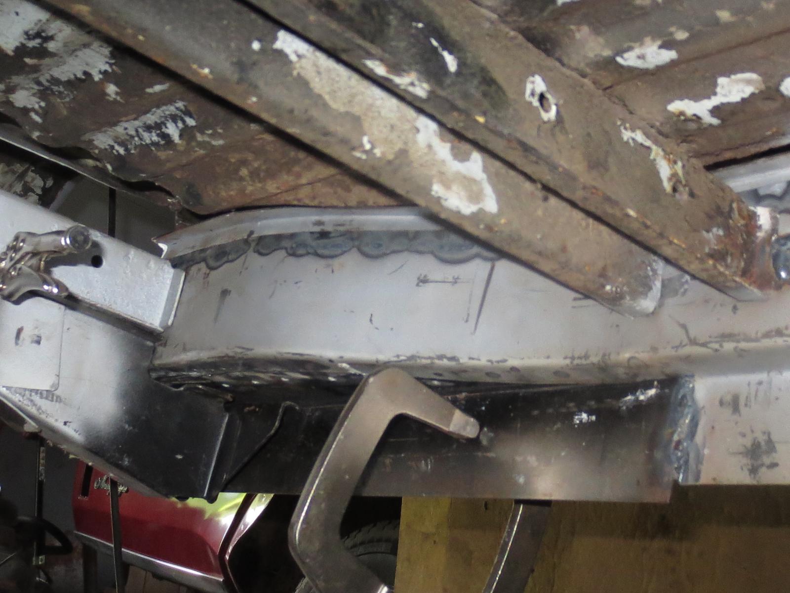

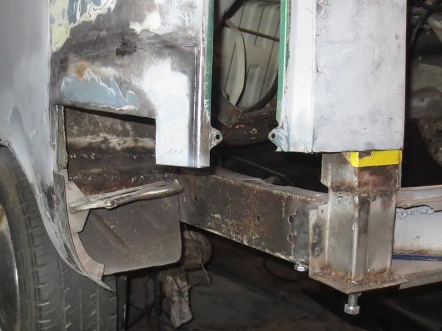

PostPosted: Thu Mar 07, 2019 5:48 pm    Post subject: Re: 74 bay window campmobile rocker rust,corner rust Reply with quote

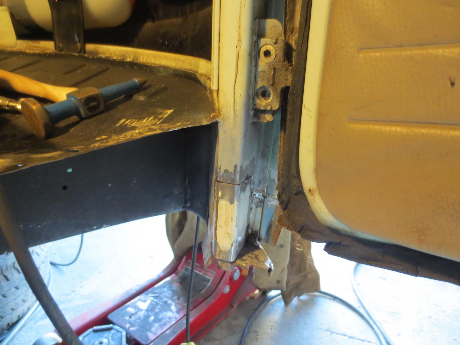

Installed this floor patch,,and finished welding the b pillar before welding the patch,The block of wood is the pattern of the bottom of the pillar,I cut it out before starting and used it to ensure the new piece went back as it was.

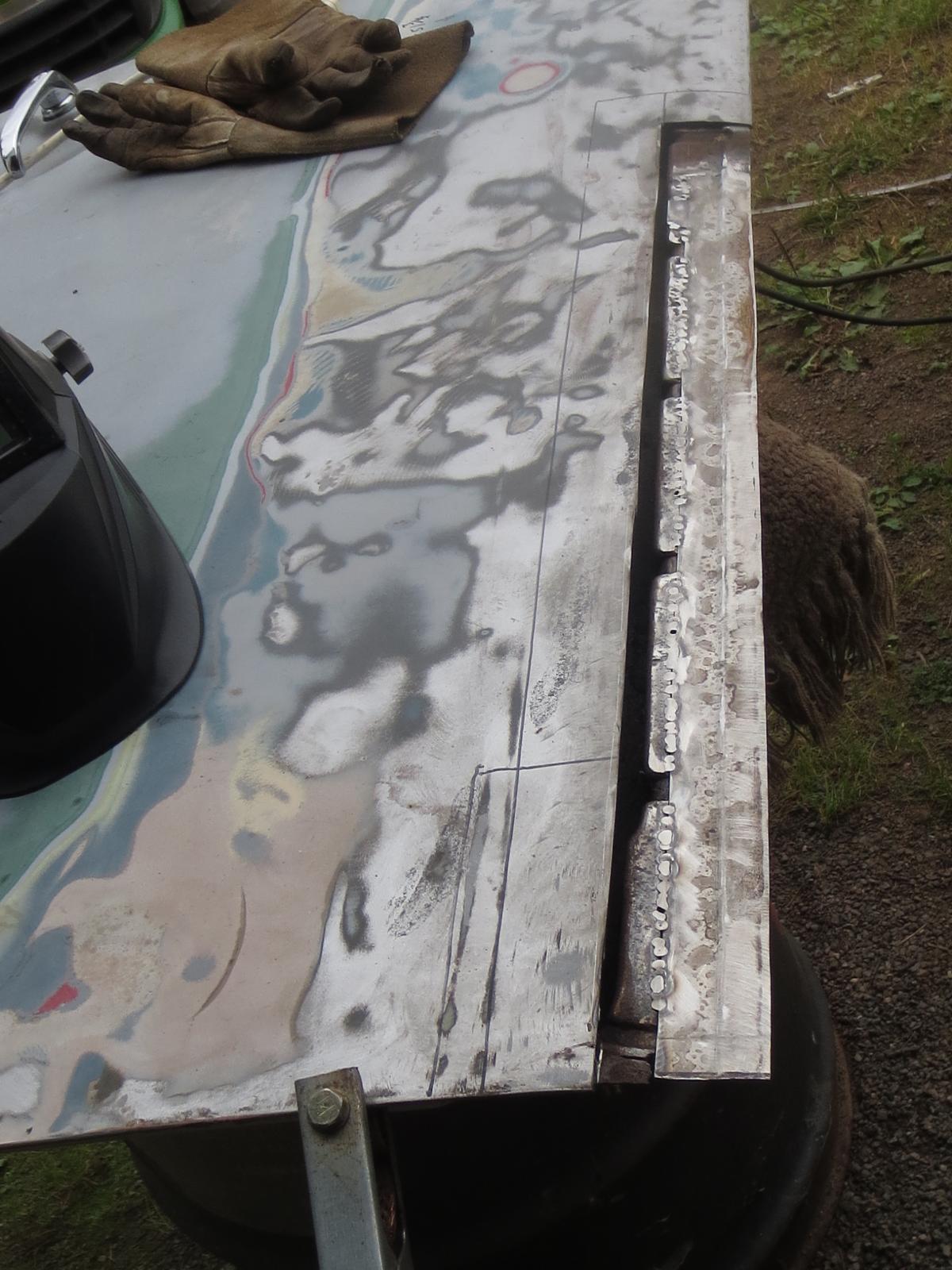

PostPosted: Wed Dec 13, 2017 3:19 pm    Post subject: Re: 74 bay window campmobile rocker rust,corner rust Reply with quote

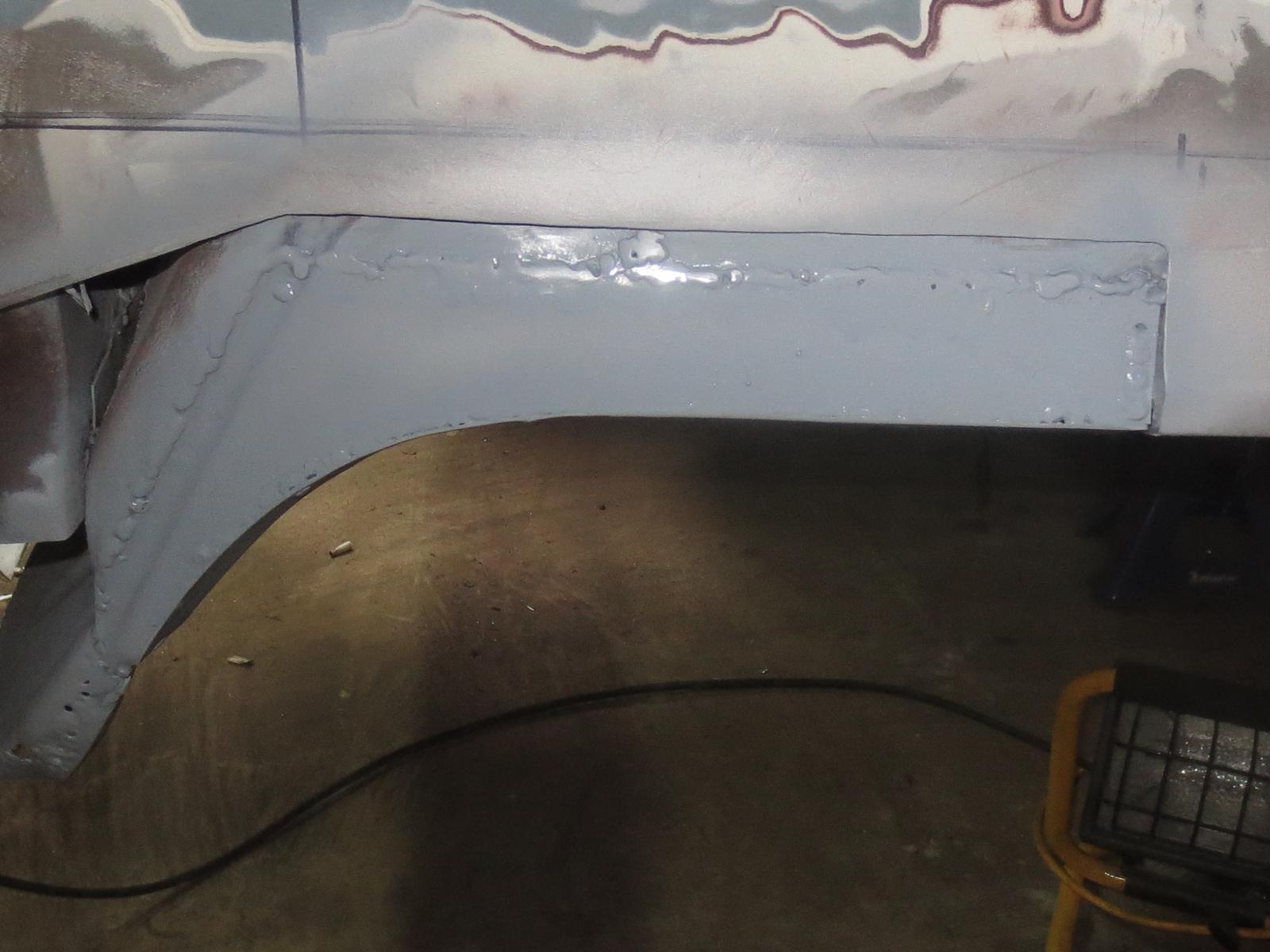

Welded in the door patch.

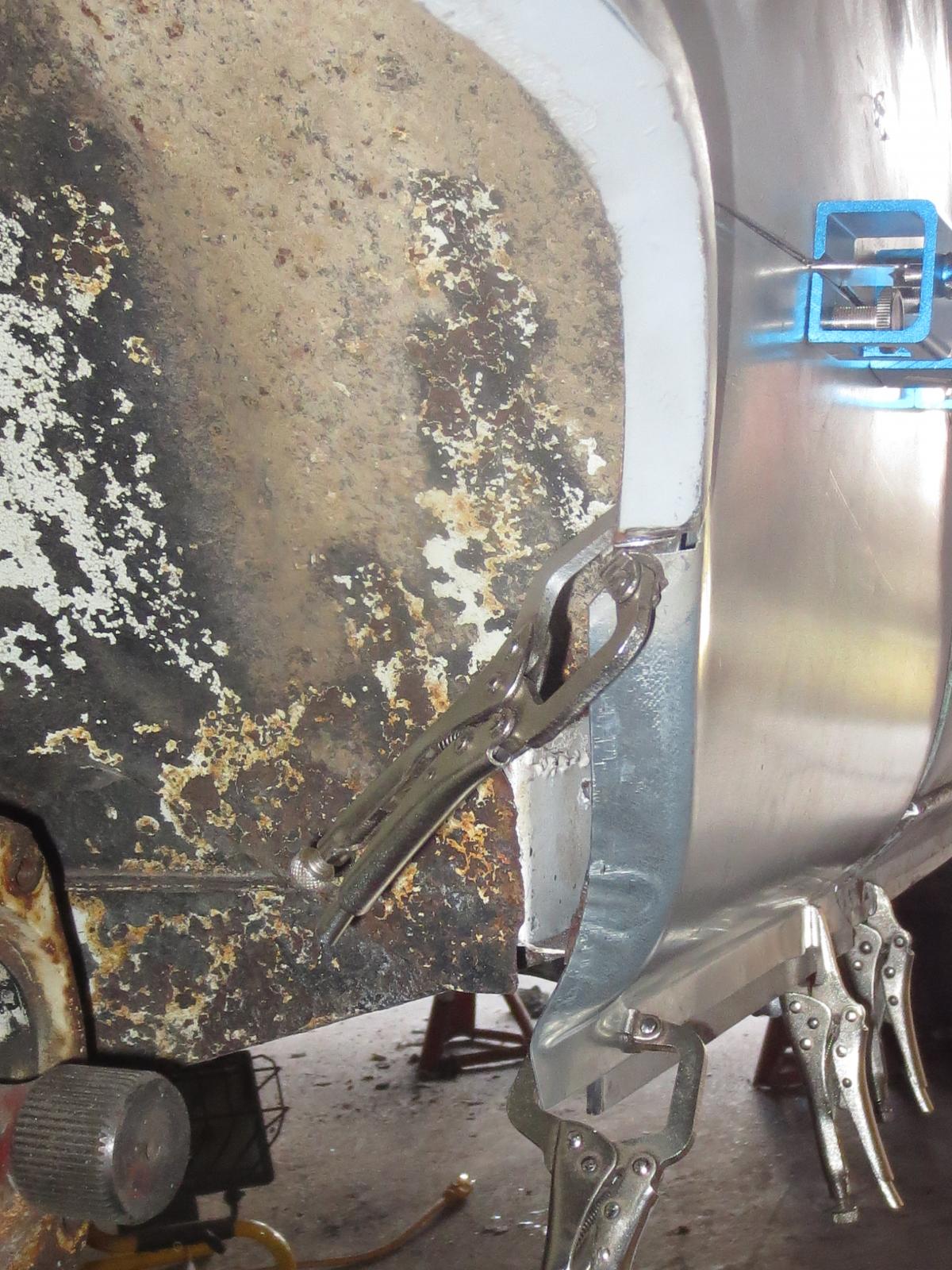

lil-jinx
Posts: 1792
lil-jinx is offline

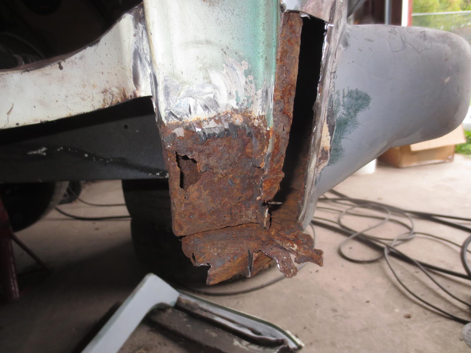

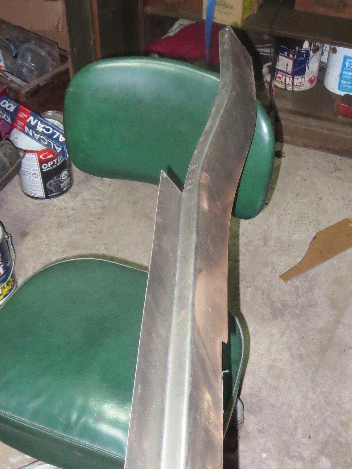

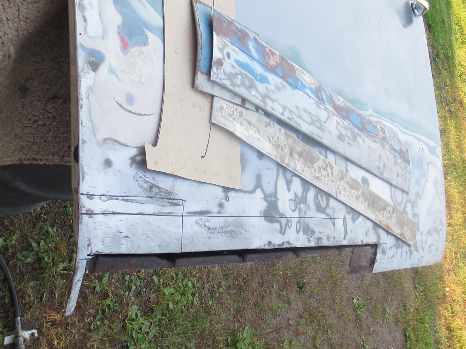

PostPosted: Sat Dec 09, 2017 2:25 pm    Post subject: Re: 74 bay window campmobile rocker rust,corner rust Reply with quote
Orwell84,I live just outside of Moncton,on the road to Fundy Park.
Yarkle,I know how you feel about welding,I have to plan every tack,and go thru the motion each time before pulling the trigger,I space the tacks out and grind them down after I do 4 or 5 of them that gives it time to cool,thing that really makes a mess is the under coating, behind the panels, that I can't clean up.
You may notice that I left a small piece of the corner in place,I left it there as a guide when I get it all fitted up I will remove that small piece.
Good luck with your project.

PostPosted: Sat Dec 09, 2017 10:58 am    Post subject: Re: 74 bay window campmobile rocker rust,corner rust Reply with quote

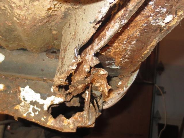

The channel patch picture!!!!! Now i see how you did it. Ive got to practice some welding first, but then im going to try and ressurect the doors i thought were solid enough to install, I was just having trouble visualizing how you did it, but now i see outside and inside, i think i can handle it.
