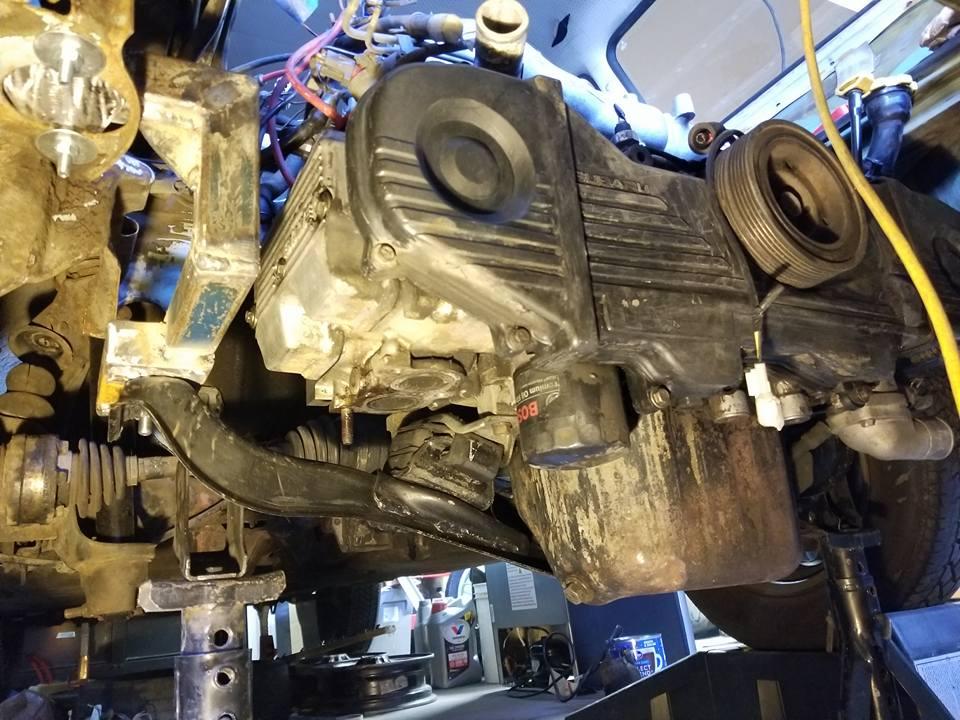

gm4lnch wrote:
Lol. yeah It took a bit but after 2 years I figured out it needed coolant to cool. Completely joking here. Yes I could have done a T4 or 911 engine and it would have still been old school air cooled, but back then they were cheap. you could built a 1776cc for around $800, now days here in the Denver are that engine is almost $2k, a stock 1600 rebuild will still set you back $1800. A type 4 engine might be around 90hp, more if you build it but of course then the price goes up. Long lasting, like 300k miles long lasting? No maybe 100k if your lucky. I was able to get 140hp, reliable power with zero maintenance (no more adjusting carbs and valves), air conditioning, tons of torque, no issues with cooling in slow low RPM traffic. If we were back 10 years ago where air cools were cheap to build then I probably would have left it, but I could do 2 Subaru swaps for less than 1 air cooled engine with even close to these advantages. I can't say i would ever own another VW with an air cooled engine after driving this one. Nothing wrong with them for others, I just like to drive my VW not work on it.
I would do some very good research first before you spend all that time and money in a subaru engine transplant. Just a note : the older your engine the longer it will last. Good luck with it and I hope you will get decent miles out of it before you have to repair it. Do not forget : what you do not have - can not break!
A good quality built T3 VW aircooled engine will last at least as long as a subaru engine. Sure you will not have 140hp, but you will have lots of torque and not have to worry about many things. Good for 75 / 80mp/h, that is all you need anyways. Adjusting valves every couple thousands of miles does not kill me, because that is all I have to do.
Good T4 engines were never cheap to built. Even back in the 90's we did spend up to 10k US $ just for the T4 engine / long block alone. Everything was made in germany by known big manufacture which also supplied the big car companies. Next to no trouble with supplied parts back than. Cheap crappy parts did not exist.
911 engines and Porsche 911 were only cheap in the US, but never cheap in Europe. By the time you had a 911 engine + trans + your brakes updated for the power and made it street legal we are talking 15k - 20k Shocked which was a lot of money back than!
Piece now

PostPosted: Wed Apr 03, 2019 2:08 pm    Post subject: Re: Subaru engine in a Squareback? Reply with quote

PostPosted: Wed Mar 20, 2019 9:39 pm    Post subject: Re: Subaru engine in a Squareback? Reply with quote
gm4lnch wrote:
Yes this is a 4 speed car. I used the Legacy engine mounts and cross member bolted to a custom cross member mount. It bolts where the original engine hanger mounted and to the frame by the shock towers.
You know the engine needs water to cool , right ?! Shocked Why all that trouble ??
We at least did put big T4 or 911 engines in Bugs back in the 90's with everything else you need to make the bug slow down / stop also. That is at least a good engine and it does not need water!! Plenty of power , long lasting and good for cruising at 120 mph + Very Happy Laughing Just good ol times

PostPosted: Mon Mar 18, 2019 1:21 pm    Post subject: Re: Subaru engine in a Squareback? Reply with quote

PostPosted: Sat Feb 16, 2019 12:29 pm    Post subject: Re: Subaru engine in a Squareback? Reply with quote
Do you have a pic of the bar you used for the rear support? Thanks

GM4inch
Is that a manual tranny car? Did you have to fab a rear engine mount to hang that motor? Thank man!

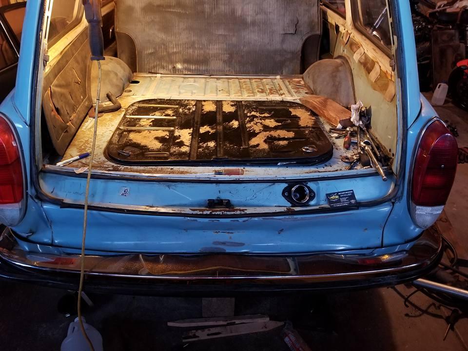

gm4lnch is offline
PostPosted: Tue Jul 03, 2018 9:13 am    Post subject: Re: Subaru engine in a Squareback? Reply with quote
Can be easily fit under the lid with the stock intake.
