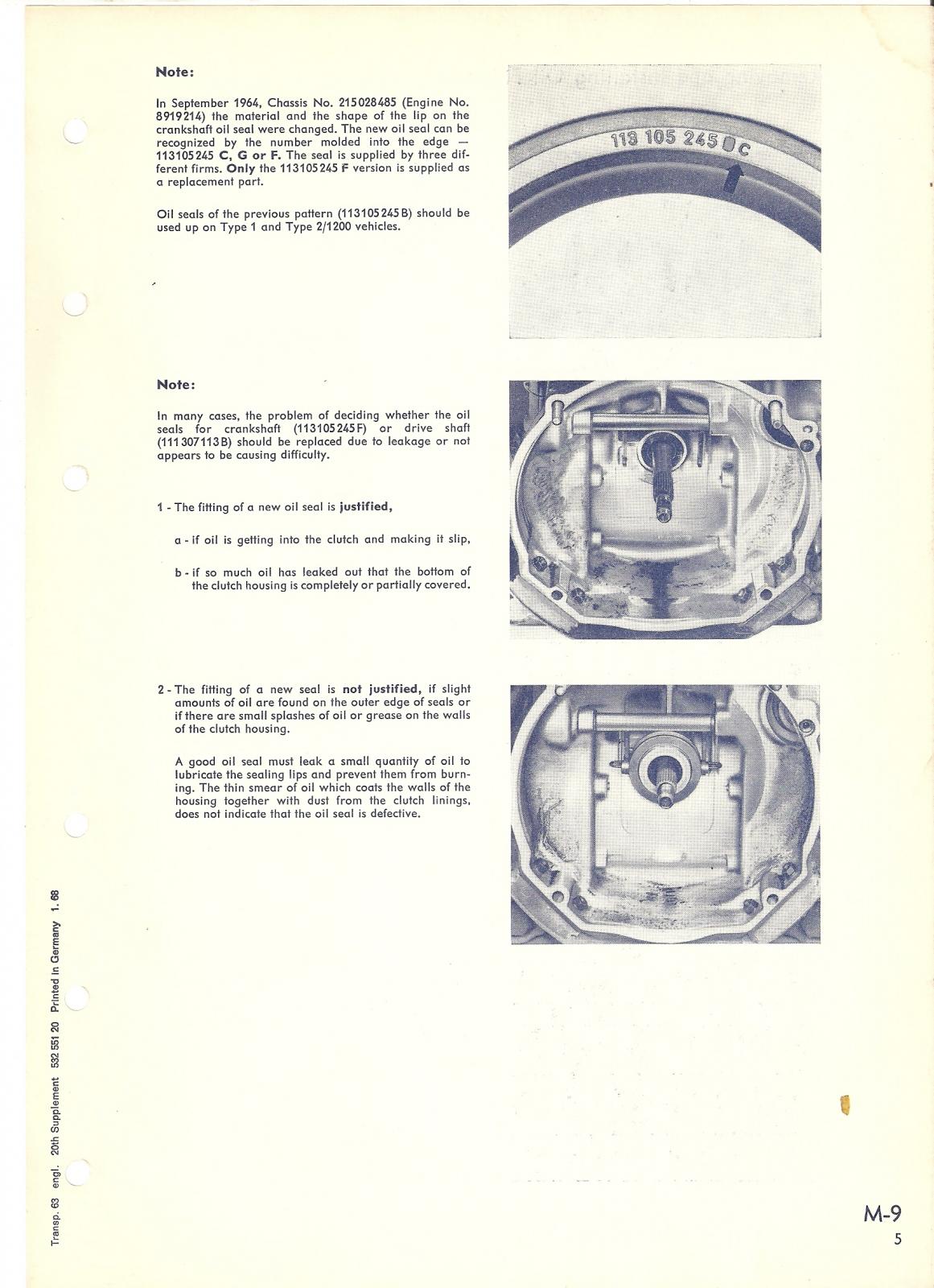

Eric&Barb wrote:
Those cast tabs that hold the oil cooler are pretty weak as is. DH ones are cast beefier. Better to install 6-8mm studs.
Lots better to use household door foam tape to seal up the DH exhaust steel and tube tins. That duct tape just makes a mess when you have to take that apart.
Flywheel is going to always leak, the workshop manual shows that. So the question is how much. If one wants to reduce how much it leaks drilling a second drain hole for that area back into the case is a must.
okay okay good info thanks for sharing! hopefully the tabs hold up. that's why i drilled them 8mm exactly to match the studs.

Those cast tabs that hold the oil cooler are pretty weak as is. DH ones are cast beefier. Better to install 6 to 8mm studs instead.
https://www.thesamba.com/vw/forum/viewtopic.php?t=523735&highlight=oil+drain+hole

PostPosted: Mon Nov 18, 2019 7:22 am    Post subject: Re: "Helga" Matt's 65 bus restoration thread - Austin TX! Reply with quote
pulled the motor to swap over to a doghouse oil cooler
the studs on the adapter were too big so i drilled the holes out with a 8mm bit
all back together, pretty fun doing this over a weekend but..
figured my rear mail seal was leaking and found my gland nut was messed up. something was squeaking in big bend i think this was it.
confirmed, it's leaking.
