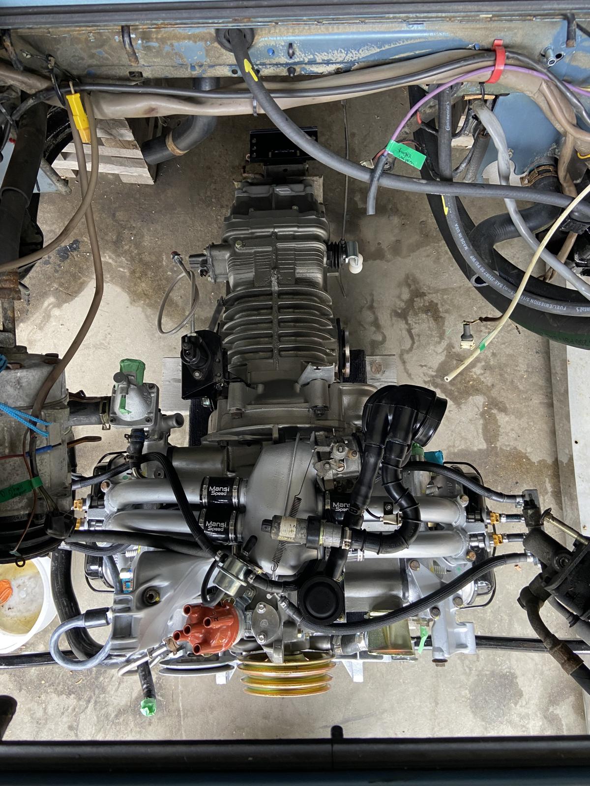

Mine was fairly well balanced with that chain bolted to the engine lift eyes.
In your case, I would still use the engine lift points, but you will need some type of jack to support the trans.
Just go slow and keep an eye on things as you go up.
Engine looks great BTW

PostPosted: Mon May 27, 2024 5:52 pm    Post subject: Re: Gravel driveway engine install Reply with quote
tjet wrote:
Just thought I post a few photos of what I did today. I finally installed this used 2.2 wxb I bought from Surfy Murfy about a year ago (who is a very cool dude). I used a cherry picker I got from AZ a coupe of years ago. One 4x8 sheet of plywood under the engine/trans, & two 2x4 sheets under the AZ ramps. I also had a couple of 2by2's that I used to set the engine on the legs of the crane. I rolled it under & re-grabbed the chain. A little wiggling & I got it in. The 2x2's also come in handy to leverage the engine in when mating it to the trans.
My biggest problem was the heat. In the 90's & the humidity around 80%
I'm done with bolting it up. Tomorrow I'll hook it all up & hopefully off to cape cod for a week tomorrow night.
HI!
How balanced is the engine; I am wondeing if you used both lifting kugs or how the weight was distributed? I ask because I will use the same method but my engine has the transmission attached which adds weight toward the front of the package.
Appreciated
Bill

Just wanted to say I got the engine fully installed yesterday evening, after which I departed on a 5 hr road trip to Cape Cod. It ran great. I upgraded all the ground straps & also install a Jay Brown 4 gau alt wiring upgrade. Next week I will install a Van Cafe oil pressure gauge kit.
Anyway, we are off to rent some kayaks

Can I leave the fuel pump block (pushrod guide) in place & just put the wbx cover on it? It's sealed on pretty good

Doug/Dave, good catch. It was a dual carb engine. Here's a photo of the actual engine when it had a pair of Weber's on the aircooled.net site. I can't find the build thread though from Surfy.
http://vwparts.aircooled.net/Waterboxer-Dual-40-IDF-Carburetor-Kit-p/waterboxer-dual-idf.htm
