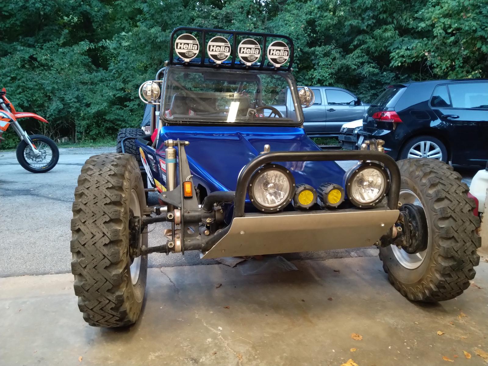

Even more Yikes was me trying to vinyl wrap this hood blue. It went not amazingly, so much so that my wife and I yanked the vinyl back off and flipped it 180 to hide the screwed up part behind my front bumper. Laughing I can't believe that worked. Good quality automotive films are forgiving enough to make up for me being not great at it. I will never call this car "done" but it has been all over the country, been shaken down and gets driven almost daily, and now has a complete color matched body with fully restored fiberglass. It burns and leaks no oil, and gets 26 miles per gallon, does documented wheelies on hot asphalt, and can fall out of the sky without exploding. like I said, I won't say "done" but I will say "happy."
I'll re-wrap the hood one day but now I'm busy with, like, uh... "stuff." Cool

PostPosted: Thu Aug 14, 2025 9:24 pm    Post subject: Re: Given (probably) a Chenowth 2lw, a few vintage buggy questions Reply with quote
The Jamar chromoly spline hubs you may recall I used to restore my Neal brakes have a little play on the axle. I ran an indicator on the axles and they were straight to the .001". I just took off the axle nuts and clocked the discs around until they were under .005" rotor runout. FYI you can't really feel .004" runout at the rotor edge in a buggy if that's useful to anyone.
Random pics keep popping up and people tag me on Facebook. Very Happy
Finally as a little treat to my car for being invincible I forced myself to finish fixing the everlasting gobstopper area on my hood and the paint is on. Not perfect, but not bad. Just how we like it.
I also spent 6 hours brushing the loose fiberglass chopper gun finish inside the hood, block sanding down and blending my repair areas, and then stippling the inside with a new thin layer of fiber matt to blend and tie it all together with very minimal extra epoxy. It was agonizing but now is done.

Good progress on the wrap! Everything I know at this point is from the experience pictured, or the Canadian guy I found on YouTube. All things considered it's going well. Everything but the hood is done and on the car!
Next I thought to try to attack the spider crack on my hood without sanding out all the gelcoat like you're supposed to. Laughing I really hate bodywork and I had this feeling I was setting up to make something worse than it already was. So, I gouged out the cracks with a razor, and vacuum-extracted them with this lil pneumatic vacuum generator thing I had from a few jobs ago. Then I sprayed some 2K epoxy primer on WAY thick, and started using the vinyl squeegee to smash it down into the cracks. It purged the cracks full and eventually stopped taking any more. Then I let it cure, sanded it, and primed the hood! You almost can't see it. Very Happy

PostPosted: Wed May 28, 2025 9:40 pm    Post subject: Re: Given (probably) a Chenowth 2lw, a few vintage buggy questions Reply with quote
Thanks man! I had a sample of Vvivid Neptune Blue Pearl vinyl wrap from a vendor booth sample at the Diode Dynamics open house 2 years ago. I tried poorly to teach myself how to do this real quick. No doubt the workmanship is rough but I'm in love with the color. Blue it is for the whole car. I'm not joking, I'm 100% sold on this. Already ordered more wrap.

PostPosted: Wed May 28, 2025 7:29 am    Post subject: Re: Given (probably) a Chenowth 2lw, a few vintage buggy questions Reply with quote
I got my carb protector panels trimmed, sanded, primed and painted with 2k single stage paint and now they're quick-release with DZUS fasteners. I perfectly matched the horrible orange peel on my other stuff I painted too, since I'm an expert. Embarassed The gold heat tape actually works really well that close to the exhaust, and now I finally get to do the art project! Graphics and sticker time! I got some name stickers with the flag, but they're kinda small. Sad I also designed some little filler brackets to secure the firewall out of .060" SS and printed prototypes. (See the yellow bits) I am going to have them dimple-died which I think will look tasteful.
Next I pushed forward on the hood which is a horrible incredibly time-consuming task. Laughing
