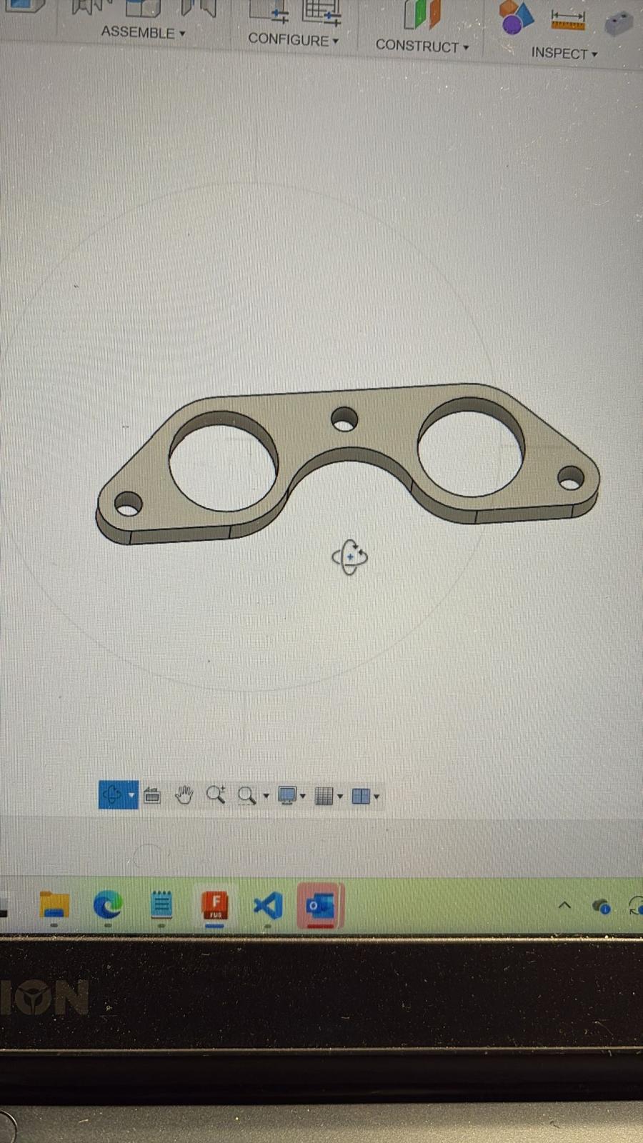

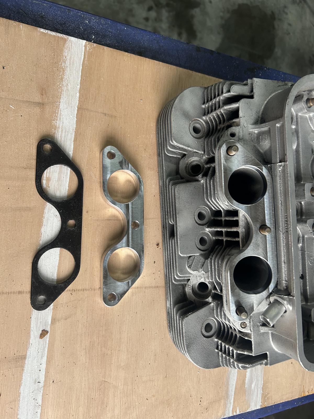

When we have testfitted the engine we found out that the combination of 44 weber and CSP manifolds caused the aircleaners to touch the backlid.
Since this is a driver, removing the aircleaners just isn't an option.
We have testfitted the CSP intake manifold for porsche-cooling, which out of the box interferes with the stand-up cooling. Testing with washers we found out that 11mm spacer would do the trick. Like this we gain 50mm in height.
below picture, on the right with the shorter manifold, this should to the trick.
Asked my machineshop if they could model a spacer from a cylinderhead I supplied.
After the modelling they have 3D printed a mockup.
After this they have programmed the CNC machine and have milled the spacer in aluminium.
one small step forward Very Happy

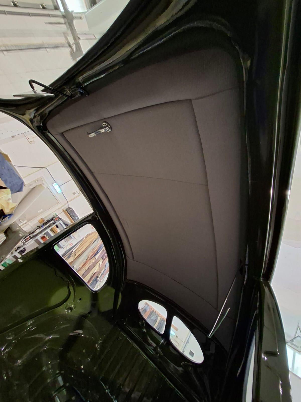

small update, got my ragtop and headliner installed.
Really happy with the result.

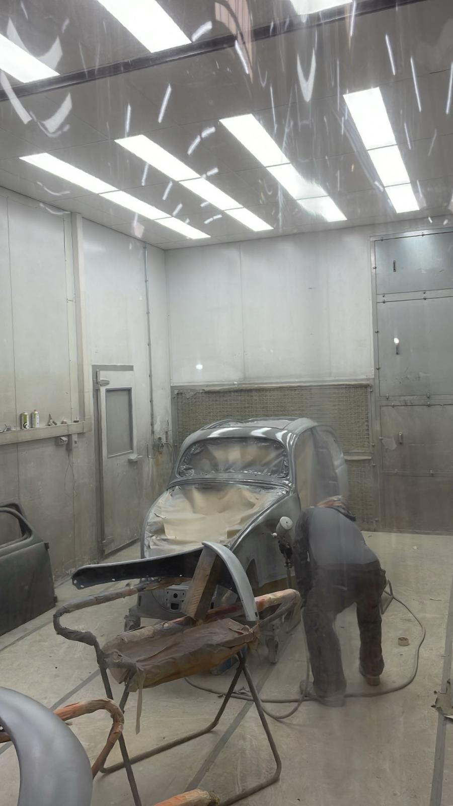

After some testsprays and multiple different clearcoats from high gloss to semi to matt I have decided the car will get a high gloss clearcoat. This for practical reasons, it is not going to be a museum car but a driver. So a scratch left and right is more then likely to occur. Getting this repaired is just way easier.
Besides this: the misses has a very strong preference for high gloss. Very Happy
we have 2 coats of green and 2 coats of sealer on, first time in the sun, love it!
The color seems to change depending on the sunlight. Can't wait to receive it back and start assembly. Upon return and after wiring loom install it will be transported on the dolly to upholstry-shop for the ragtop install.
