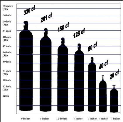

raygreenwood wrote:
67ctbug wrote:
I think 40-80 is good for me. I don't need a huge tank and I don't want a 20. I'll give them a call Monday.
What Dr. Stockpiler is getting at is that even on the best units with the best gauges...you will rarely find yourself working at one might consider "gas conserving" levels...down under about 12-15 CFH...because you have to set up the gas shield to actually work for the metal, wire and current combo...as well air cross air flow disturbance (your results will vary in other words)...and even the best regulators do not function well down below about 10 CFH. So...you usually use more gas than you think unless conditions are perfect.
Also....on the other side of the gauge set....the high pressure side....working down under a couple of hundred PSI of supply pressure on a very small tank usually makes for a very inaccurate flow regulation so you can rarely get all of the gas out of the tank and make good welds.
Also....you probably actually use as much gas advancing and cutting off wire after a nozzle or tip issue...than you do actually welding. If you have to to change a spool or change a tip..having the presence of mind to shut off the gas can help with gas usage.
But just for the record....even a 40 CF tank ...as an amateur welder ...I would consider simply a "jump tank"...small enough to drag out to the middle of somewhere.
Just for reference....here is a chart of bottle sizes. There is some small manufacturer variation but in general they are standardized.
My 80 CF bottle is right at 44" to the top of the protective cap and 7" in diameter.
The 40 CF bottle as you can see is just 10" shorter ..topping out at about 34" tall.
Ray
Ditto on what Ray says. Years ago when I first started learning to weld, I started with a 40CF bottle. Any little project at all would use it up, then back to the store for the next project. So trying to be frugal I moved up to an 80CF. One round of that and I realized (look at Ray's chart) that a 125 is only slightly taller and only 1/2" larger OD than the 80. One of those "Duh" moments.
As mentioned earlier, once you are in the system, you just exchange. And for my experience above, there was an upgrade charge as I went from one size to another. I just had my 125-(100% argon) refilled the other day, $35 including tax at airgas.
Usage: You use more than you will think. I refilled my 125 bottle 2 times during this TIG welded project. So total of 300+CF:

raygreenwood wrote:
67ctbug wrote:
Ok well if that's a ripoff, the local airgas said 140 for a filled 40 cf. is that too small? I think an 80 might be better but I don't know how much it'll cost.
Ask them. Prices will vary with labor costs and taxes from city to city....but....
I think you will find the cost is within about $20 for either bottle.
I went all of this same route four years ago when I started out. Bought a 40 cu ft bottle at HF...and I take it to Praxair....and they nicely said "we cannot and are not filling that POS...wrong DOT stamps and markings.
I asked what a 40 cu ft bottle would cost outright and filled...and they listed about $98.
The 80 cu ft bottle was $125 outfight and filled (and its not a new bottle. A new one was about $165 and.... they had none in stock cause no one wants one).
I asked what a trade out 80 cu ft bottle costs....and its $125....like they said.
Here is the TOTAL gist:
Buying a new bottle outright will cost you $150 or better.
If you own your own bottle....it will cost you $45 to fill up when its empty...at their convenience. And...every few years YOU will pay the cost of testing and recertifcation, new valve (required by law) and blowout seal.
If you use your local gas suppliers bottle...it will cost you about $125 (sounds like $140 in your case)...ONE TIME ONLY....and it will cost the same $45 to fill up when its empty....except that you NEVER have to pay for bottle recertification, new valve, new blowout seal etc.
The cost for a hydro test is only about $20-30. Bottles usually are every 5 years and some can be 10 years depending on design and whats in it. Valves get replaced when inspection finds a bad one.
See what I am saying here?
When your local gas supplier quotes you $140....ask them if that is a swap out cylinder and what it will cost to swap out an empty for a new one.
You may also be getting caught in the trap of sales being generated from a "newbie". If you come in wanting to BUY a NEW cylinder.....they may just be giving you EXACTLY what you ask for....wanting to buy a new cylinder so YOU can own it....which has no benefit.
You want to get into their bottle exchange program. Its going to cost you about $125...give or take....to get into that loop.
When the guy quotes you $140 for an 80 cu ft cylinder....ask him...'Thats an exchange cylinder right?"....and if he says "yeah"....ask him..."OK...what does it cost to swap for a full one when I bring this one back empty?"
Chances are...you will get an answer of between $45 and $60. Wink
One warning.....if you do not weld much.....like just a few inches of bead here or there every few months....get a 40 cu ft tank. And...pay attention to the expiration dates on the exchange bottle you get. If they are less than a year....you may end up keeping the bottle until after expiration date. A very few welding supply houses I have heard of...will whack you for that $20-30 testing few when you try to turn the bottle back in. Most do not.
Ray
In the world I live in if you don't own your own tank there is also a monthly rental fee.
I have never waited to have a tank filled, you also have the option of swapping your tank for one of theirs
A 20 or 40 pound tank will give you many hours of welding time, which is more then enough to repair or restore your own car. I mention buying a co2 tank which will have the proper DOT stamps and will allow it to be filled up to 90% of the stated pressure.
If this is your business then that's another matter entirely.
