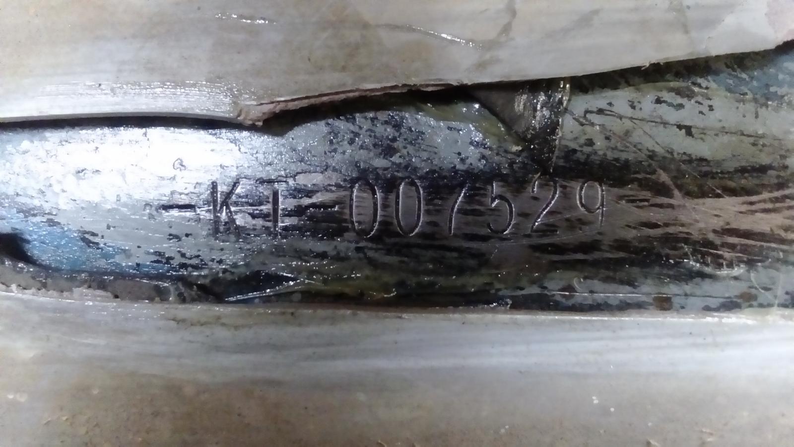

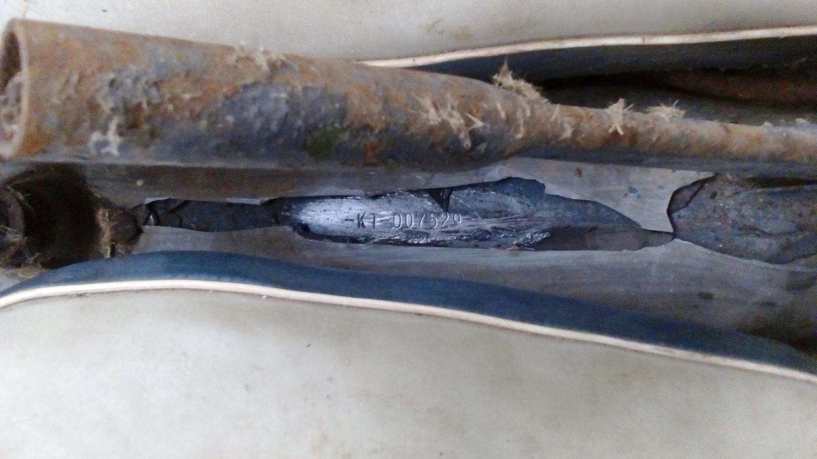

It looks like the KT number is stamped in the same place as the welded on tag for the VIN number would go. It makes me wonder if they all have KT numbers underneath the VIN tag that's welded on.. Has anyone ever had reason to remove their tag for a look under it? Doubtful I guess!

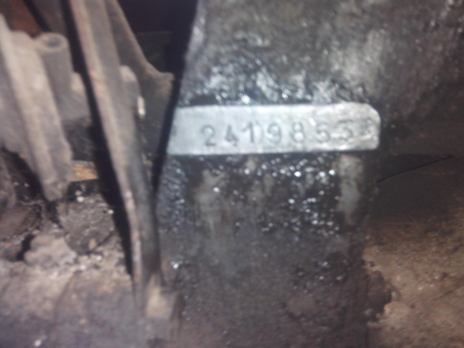

usariemen
Joined: August 28, 2004
Posts: 1745
Location: Germany
usariemen is offline
PostPosted: Sun Feb 12, 2017 4:07 pm    Post subject: Re: Vw beetle 1946-1947 with tunnel number like -TK- 005... Reply with quote
The engine number is not original.
That looks selfmade.
The chassis seems to be an exchage one, swapped out by VW for some reason and got the KT exchange number in front and the original number of the old chassis in the rear.
With better over all pics of the floor it might be possible to put a date on it.
Does the car has the small tank and the metal glove boxes still?
A 1947 body is a rare thing. No matter if the chassis is younger.

Joined: February 08, 2017
Posts: 8
Location: Greece
starstam is offline
PostPosted: Sun Feb 12, 2017 1:04 am    Post subject: Re: Vw beetle 1946-1947 with tunnel number like -TK- 005... Reply with quote
Engine number
gear break
Maybe these help

usariemen
Posts: 1745
Location: Germany
PostPosted: Fri Feb 10, 2017 6:18 am    Post subject: Re: Vw beetle 1946-1947 with tunnel number like -TK- 005... Reply with quote
OK
So that means the original chassis was swapped for an other one wich got a new number. the KT one.
Would be interesting to see if the current chassis is of the same age.
Master of my domain!
virtanen
Joined: January 08, 2006
Posts: 1495
Location: Finland
virtanen is offline
PostPosted: Fri Feb 10, 2017 2:59 am    Post subject: Re: Vw beetle 1946-1947 with tunnel number like -TK- 005... Reply with quote
It's like this one:
http://www.thesamba.com/vw/forum/viewtopic.php?t=4...;start=100
Mika

starstam
Posts: 8
Location: Greece
starstam is offline
PostPosted: Fri Feb 10, 2017 2:46 am    Post subject: Re: Vw beetle 1946-1947 with tunnel number like -TK- 005... Reply with quote
The number with the TK is stamped on the tunnel between the gear lever and the hand break. Hope this helps. It does not have number under the rear seats.

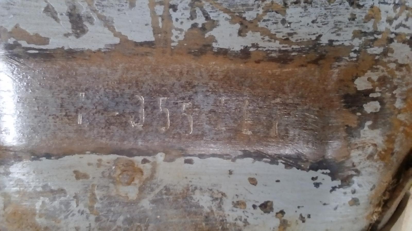

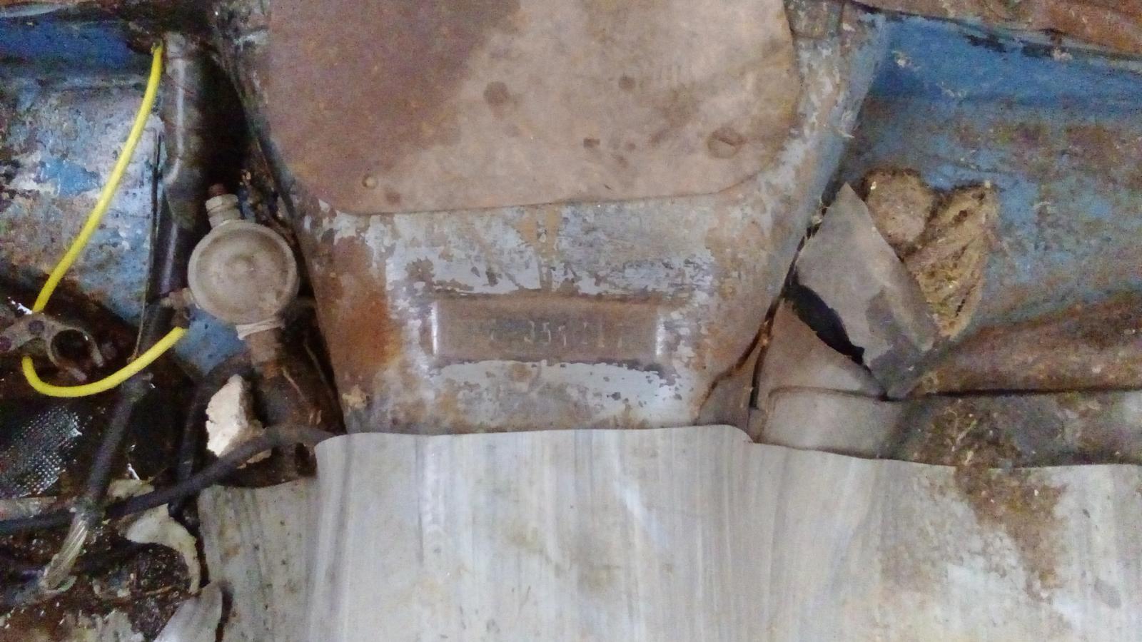

usariemen
Posts: 1745
Location: Germany
PostPosted: Thu Feb 09, 2017 11:15 pm    Post subject: Re: Vw beetle 1946-1947 with tunnel number like -TK- 005... Reply with quote
The rivets on the tag in your front end look unmolested.
So this should be the original one to the car.
The 1-055147 would be then the VIN number of thje car.
That is a number that would be from 1946 if we look at the records.
This tag obviously is stamped in 1947.
Those where unsteady times. You will not find out but it is possible the car got the number in 1946 but was for what ever reasons finished in 1947 and got the tag finally then.
The same number should be found on the tunnel inside the car as well.
Below the tag there should be the body number stamped directly into the metal panel. Is there something?
Where exactely is the -KT .. number located?
virtanen
Posts: 1495
Location: Finland
virtanen is offline
PostPosted: Thu Feb 09, 2017 11:12 pm    Post subject: Re: Vw beetle 1946-1947 with tunnel number like -TK- 005... Reply with quote
KT numbered is a spare chassis.
Mika
Split beetle restoration panels
Oval beetle restoration panels
New projects
starstam
Posts: 8
Location: Greece
starstam is offline
PostPosted: Thu Feb 09, 2017 4:30 pm    Post subject: Re: Vw beetle 1946-1947 with tunnel number like -TK- 005... Reply with quote
No there is no number under the rear seat. I read that so old beetles werent supossed to have such a number. Correct me if my wrong.
I guess i can say its an original 1946 beetle is there anything else i can check??
Guys i realy appreciate all your help till now!
nlorntson
Crazy VW Lady
Joined: March 13, 2004
Posts: 3856
Location: Twin Cities, MN
nlorntson is offline
PostPosted: Thu Feb 09, 2017 12:21 pm    Post subject: Re: Vw beetle 1946-1947 with tunnel number like -TK- 005... Reply with quote
starstam wrote:
These are the 2 numbers described above!
Why are they different?? Do they have to match??
No. They don't have to match.
Is there a number under the rear seat on the tunnel?

starstam
Posts: 8
Location: Greece
starstam is offline
PostPosted: Wed Feb 08, 2017 4:21 pm    Post subject: Re: Vw beetle 1946-1947 with tunnel number like -TK- 005... Reply with quote
usariemen
Posts: 1745
Location: Germany
PostPosted: Wed Feb 08, 2017 4:19 pm    Post subject: Re: Vw beetle 1946-1947 with tunnel number like -TK- 005... Reply with quote
Any picture posted of the numbers will tell soon what it is and if it is something original.
