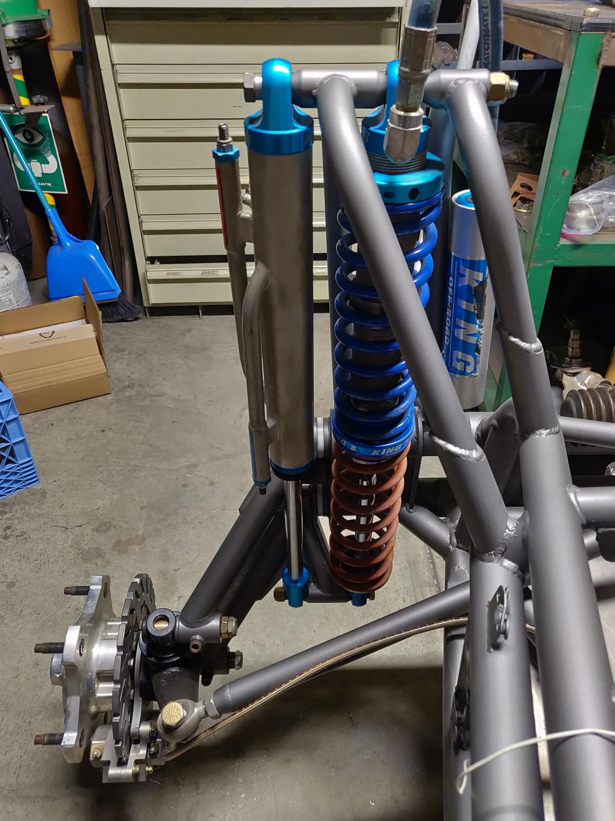

fordfreak
Joined: September 21, 2009
Posts: 58
Location: Orange County, CA
fordfreak is offline
PostPosted: Thu Oct 24, 2019 10:59 am    Post subject: Re: Latest Rage combo spindles Reply with quote
Thank you. Yea this thing has A LOT of rework and added tube.
So you dont have any shims on the bottom then?
Rockwood
Joined: January 25, 2008
Posts: 133
Location: San Diego
Rockwood is offline
PostPosted: Thu Oct 24, 2019 10:56 am    Post subject: Re: Latest Rage combo spindles Reply with quote
fordfreak wrote:
Where do.you have your shims? On the bottom or top?
On top.
Nice buggy, btw. Just had to retire my 4LWD frame (torsion housing cracked beyond repair) and moved everything over to a Bugpack 2+2 frame (back seat area is now where the radiator, UMP, fuel tank, etc sit for better weight distribution).
"And another thing, when I gun the motor, I want people to think the world is coming to an end." - Homer Simpson

fordfreak
Posts: 58
PostPosted: Thu Oct 24, 2019 10:25 am    Post subject: Re: Latest Rage combo spindles Reply with quote
Rockwood wrote:
fordfreak wrote:
You cannot adjust camber with shims. The camber is built into the spindles by the angle of the link pin holes in the king pin. If you try to go against this even in the slightest you will oval your bushings and ruin your king pin and link pins.
It doesnt matter what arms you use with the latest rage spindles. Camber will always be the same. The shims are there to take up gap from the differences in the arm widths and nothing more.
The angle of the link pin holes takes into account the vertical angle of the entire spindle as well. If you mount a spindle designed for arms spaced evenly, you will oval the link pin or beam bushings because they are no longer parallel with the holes in the arm.
Without adding shims to the top arm, I had to run the link pin nuts loose to allow it to cycle, which resulted in 6* of negative camber.
