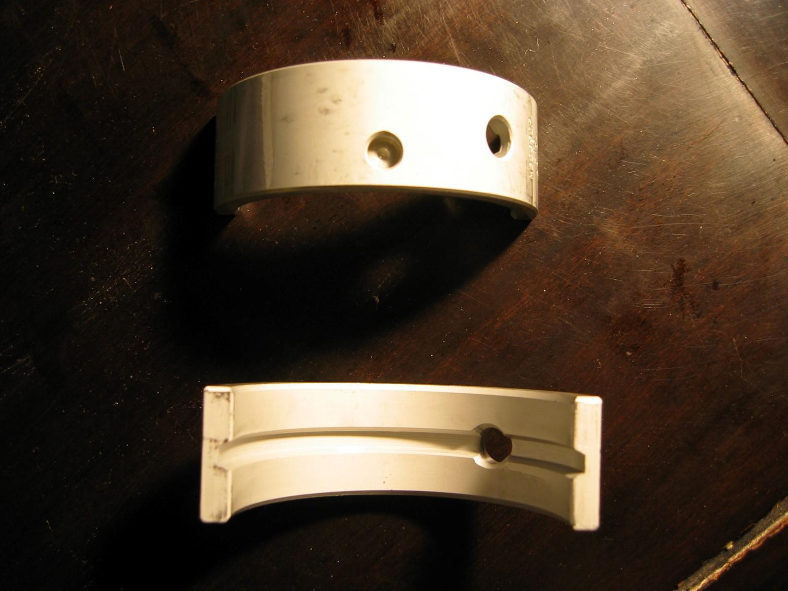

They're not worn. Glycos had exposed copper. Doesn't mean it's bad. Probably some of the best ever. Put em in your case, torque it, and measure. Like everybody is supposed to do...

They're not worn. Put em in your case, torque it, and measure. Like everybody is supposed to do...

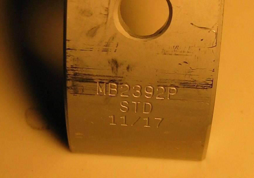

Clevite made in china WHAAAT? Shocked
The latest clevite catalog does list oversize OD main bearings for the first time ever. There are numerous mistakes in the specifications.... which really made me wonder..... what they were UP to. Now I know. Looks ok from here.
THANKS for the pics.

Got the bearings today, havent measured them yet but thought Id post pics for you all. Pretty disappointed that they are made in china vs. mexico but maybe it means the rod bearings could come back? In the hand edges feel rough compared to regular mahle or KS, weird copper sheen under certain lighting but overall standard aluminum color. #2 bearing is still steel backed fortunately.

Mmmmm.....not a very accurate answer you got from that "tech"....but thank you for going back to it! The outer coatings they typically put on bearings.....tin or lead/tin.....would not simply oxidize away without leaving considerable white residue. And....if there were oxidizing going on....the copper would not have been anywhere near that color. It would have been at best.....dark penny colored or going green.
But I do agree that if they were still the right size there was probably no reason you could not have used them. There are bearings made with outer copper layers.
I am betting as you noted that there was some visible gray coating....that they were simply not coated completely and they got missed by QC. Ray

Bugsy, Thank you for the tip, your right that would be a quick way to measure the clearance.
I already installed that copper bearing in the case (torqued)and measured with a dial bore gage and the crank with micrometer and it has a clearance of .002.
I decided to buy a new set of main bearings as pictured above and move on with the build and those bearings all measure .002-.0025" clearance, perfect for me.
