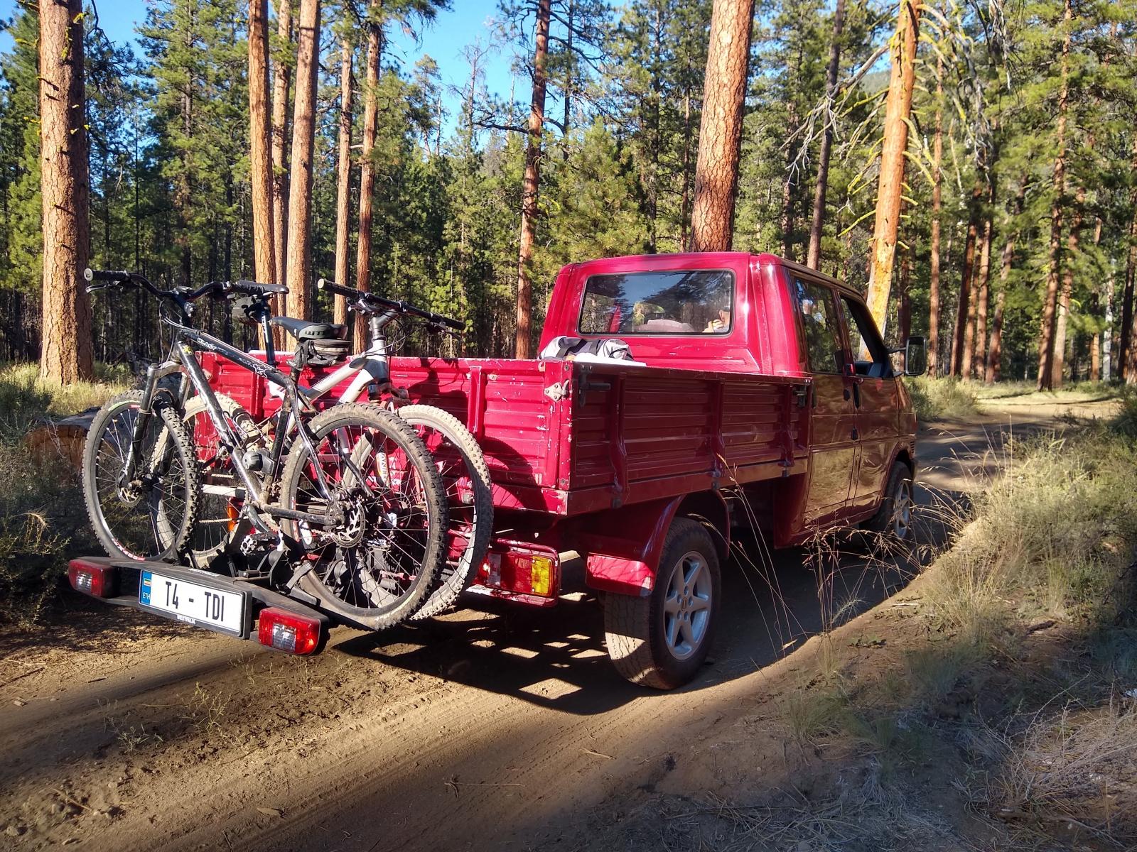

I haven't updated this in a while. I've been daily driving it and it's doing well. I still need to finish the interior side of the Air Conditioning addition though. I finally found the last couple pieces two weeks ago. I need to get on that.
Anyway, this past weekend we got out and enjoyed part of Central Oregon with it. I thought this picture looked pretty cool. Very Happy

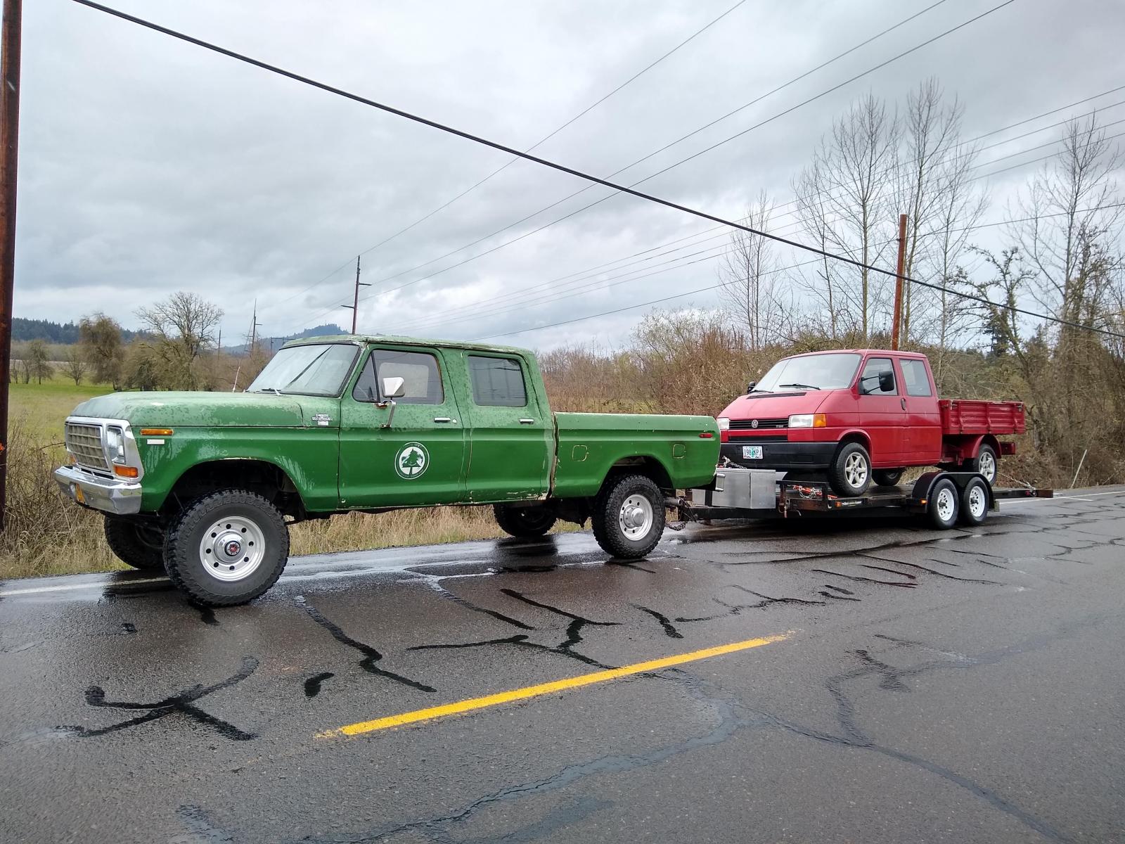

This weekend I took it in to get aligned. The shop couldn't align it. Sad They said they needed a special tool to adjust the camber. They also said that they couldn't adjust the toe in the rear because it was missing the eccentric bolts. What fun.... This shop has aligned my Eurovans before so I'm not sure what the deal is. Maybe they never adjusted the Camber on my vans before? I guess I'll be trying a new place. I still need to poke my head under the rear and see if there are eccentric bolts in there or not. I'm guessing that the raising of the rear caused the needed adjustment there. I wouldn't think those bolts will be too hard to find if I need them. We'll see.... anyone have any experience with these alignment issues?

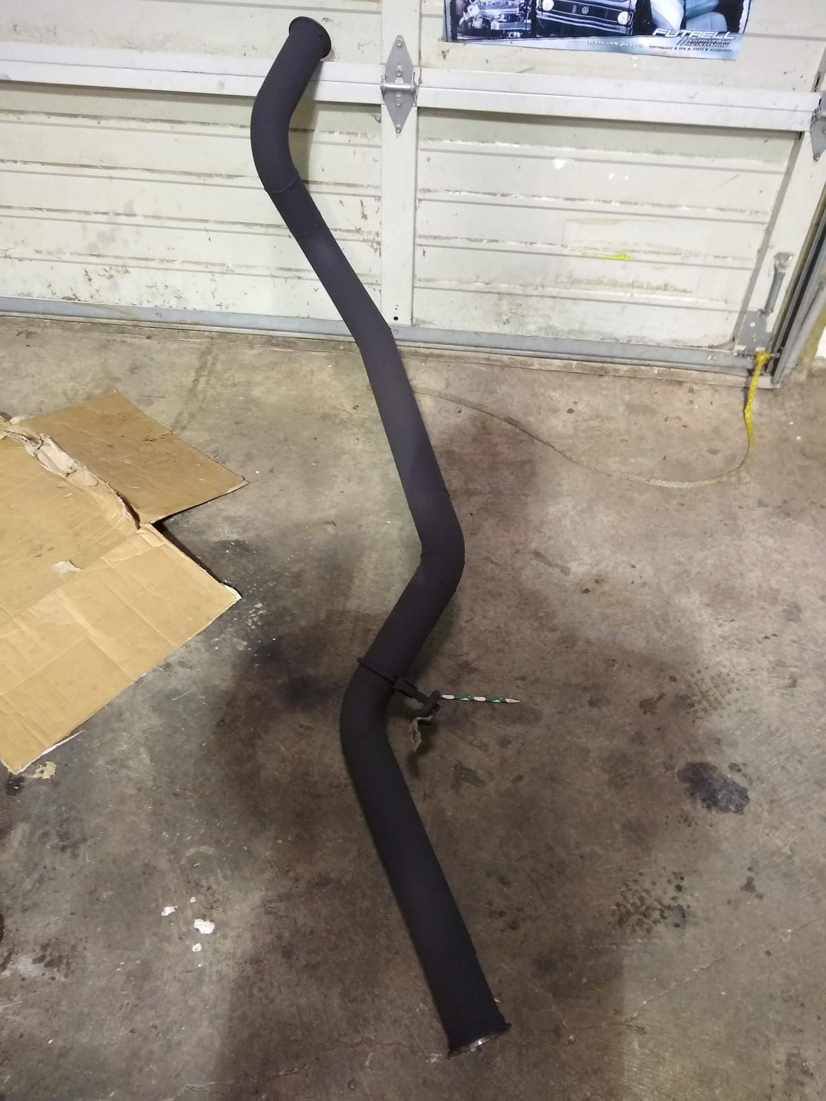

On a positive note, I drove it! It was a short drive because the exhaust still isn't done, it's dumping at the back of the cab right now, but it was done enough to do a spin through the neighborhood. I have a 99 Westy that was a good running VR6 but I swapped it to 1.9TDI. I have a 93 Eurovan with the 5 cylinder gas engine. I think I've found a new favorite! Smile The 2.5 TDI is a lot of fun! I'm excited to finish up the exhaust (Amazon delivers my last v-band today) and take it on longer drives!
And because everyone loves pictures:
On the way home for the alignment (I didn't want to sit in the waiting room so I just dropped it off and left)
Part of the exhaust. This goes from back of cab to about middle of the axle. I have chosen to go up and over the rear axle area like an American pickup rather than the standard factory route because I am looking for the parts to make it a syncro. 3" pipe is too large to route the factory syncro route and since it's a Doka, there is some room between the frame and the bed to hop ABOVE that rear axle area. I will still exit in the same location in the rear.

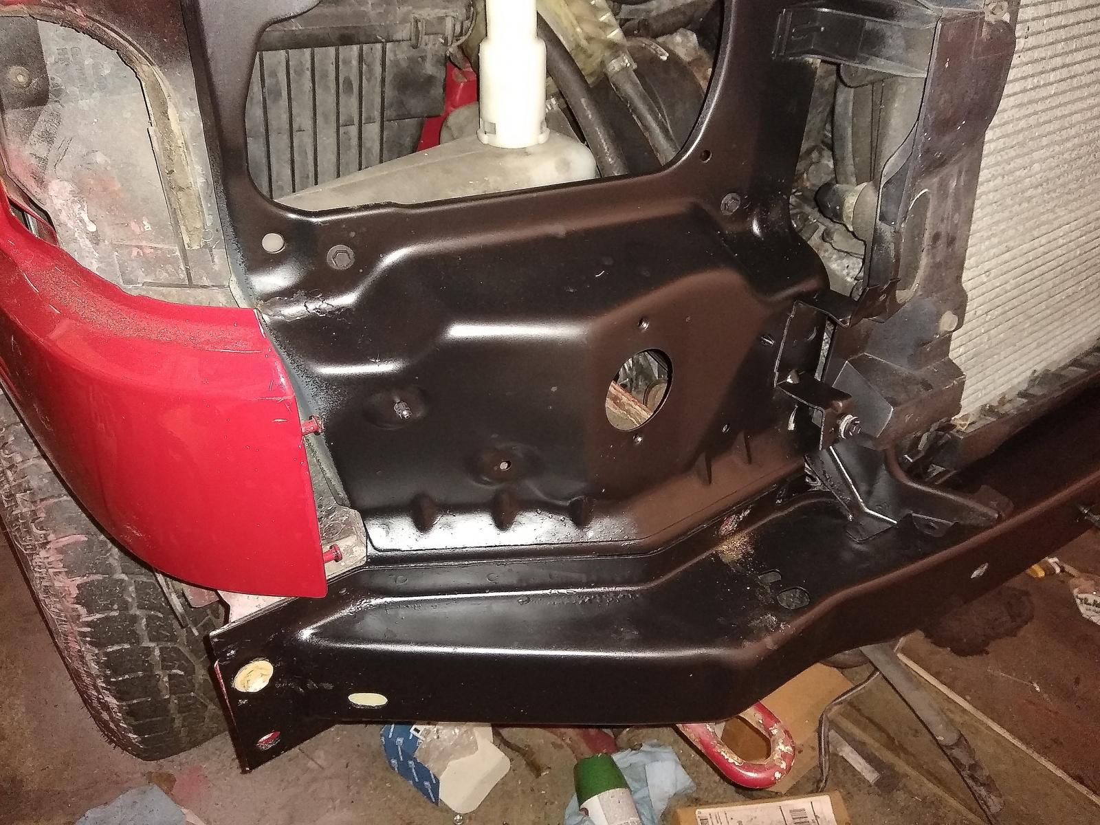

I surprised myself and found a little time last night to sneak to the shop.
I got the core support mounted temporarily to check for headlight to ECU clearance. It felt really good to see a portion of the front sheet metal on again, even if it temporary.
Unfortunately, the ECU and the motor for headlight adjustment were in conflict. I was able to bend the ECU mount bracket slightly so they would get out of each other's way. Very Happy As I said previously, this is the factory location on the 97 (donor) but since the sheet metal on this 91 is different, I had to do a little guessing. Regardless, it's done and everything fits now!
Lastly, a couple pictures of the rust repair on the front core support. On both sides, the ends where it bolts to the body was rusted. Actually pretty badly. the rust started between the two pieces that are spot welded together and worked it way out. I cut out the rusted metal and replaced it. I just did one side at a time so that I could maintain where the bolt holes should be. It turned out decent. The pictures aren't the greatest but here they are.
Next up is to pull the core support back off, run the new wiring harness for the AC/Cooling system! Then hopefully the core support can go on for good!
