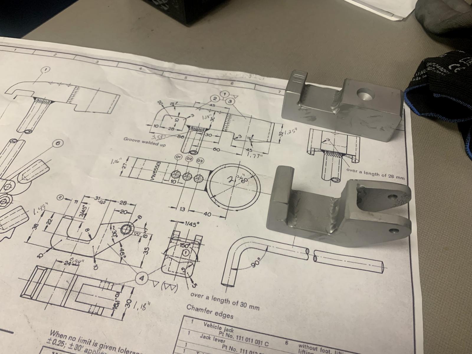

I would be happy with those welds because they will work. To quote an old mechanic friend of my dad's who is now deceased, " a blind man would be glad to see it". Good work!

With an extra jack and a tool blueprint.. I maed dis
I skipped a couple design features on it, all I really want it for is the spring plates in the back. On the bonus side I got to brush up on TIG, which is way easier than I was expecting but my welds still look janky. “A little grinder and a little paint, make me look like the welder I ain’t!”

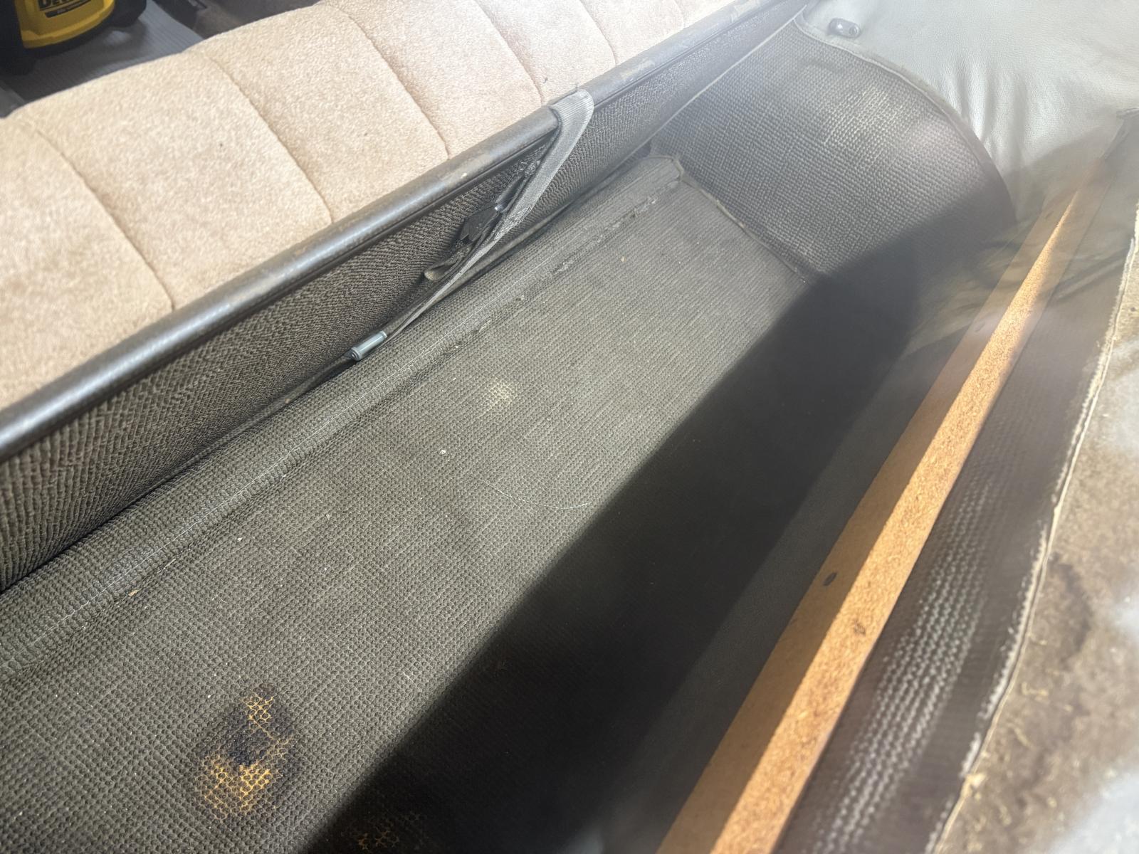

The carpet you’re holding looks exactly like mine, if that helps. Same color, same place for the strap hook. I’m 99.9% sure that my luggage compartment carpet is original, so the answer is very likely yes, that carpet was original for your car.
Here are a few pictures of mine. Someone screwed a board to the back firewall to keep the carpet in place. Pretty sure that’s not original. Haha. Someday I’ll fix it.

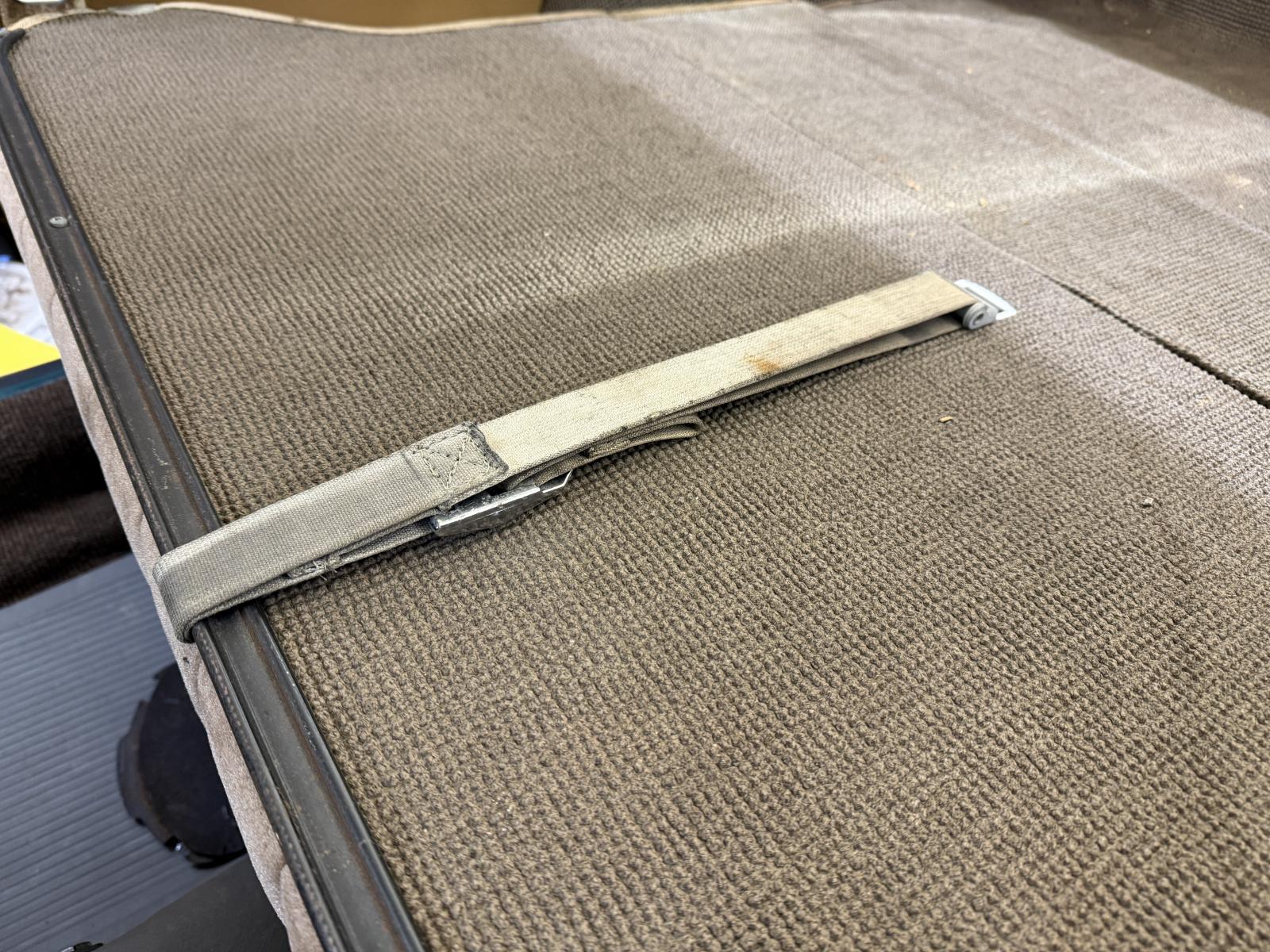

I have a question that I hope someone can shed some light on. Having just ordered carpet from Wolfsburg West today, I pulled out my original rear seat panel for inspection and noticed it still has an intact square weave carpet or matting attached. It looks stock, just like this photo from Mike’s ragtop restoration:
It’s identical to his.
Here’s what I have:
Is that a stock covering for the back seat and luggage tray/firewall? I assumed there was carpet back there to match the front, like all the suppliers sell.
Any info would be quite helpful.
