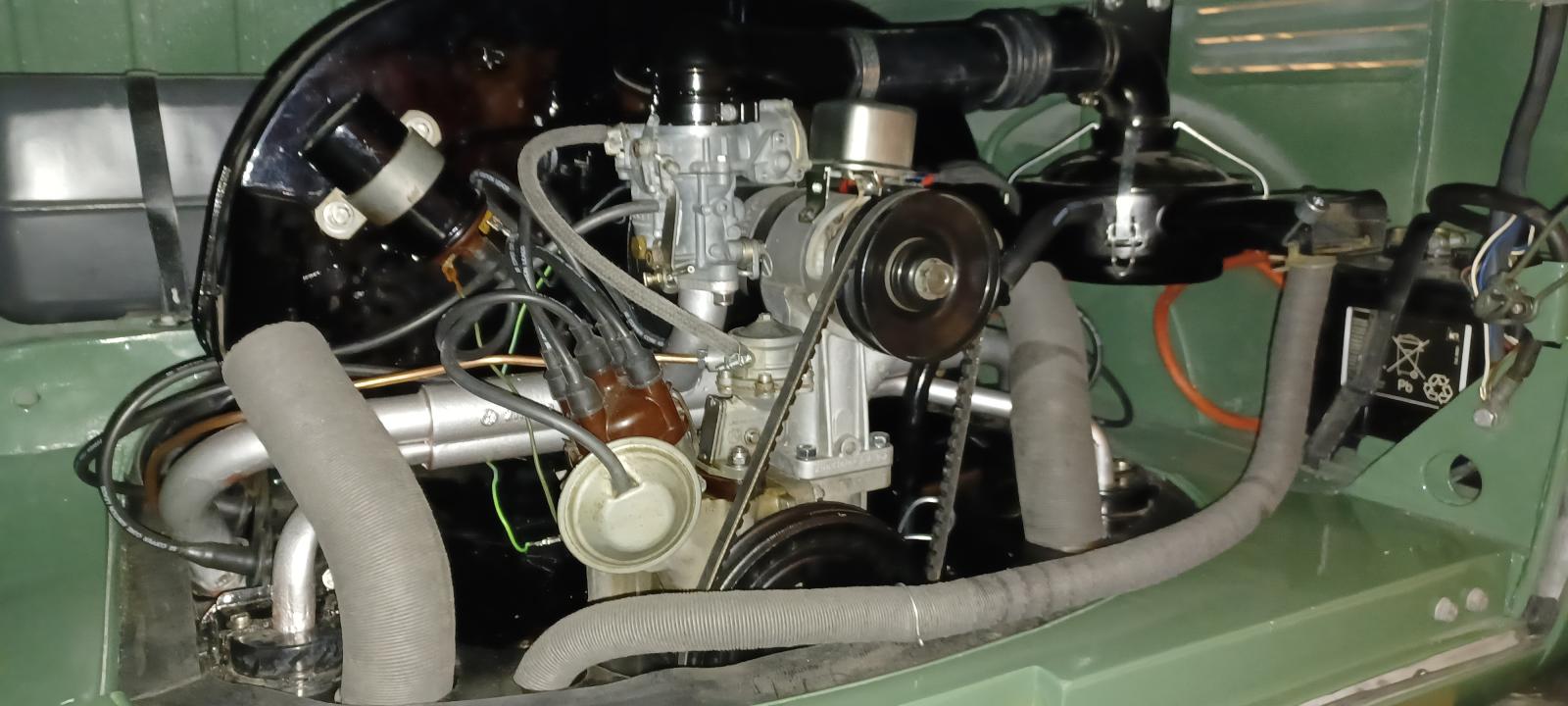

PostPosted: Thu Mar 27, 2025 7:59 am    Post subject: Re: Osku's Vans Reply with quote
I suspect I have to open the bots on the thin ware and move it arund a bit and re thighten or then take a bit of the sheetmeta and paint the grinding spot. The sheetmetal is from an other engine so that could be it or itsjust slightly bent or something.

PostPosted: Tue Mar 25, 2025 9:24 am    Post subject: Re: Osku's Vans Reply with quote
Its a brand new orginal oldstock.

PostPosted: Mon Mar 24, 2025 4:58 am    Post subject: Re: Osku's Vans Reply with quote
Is the crank pulley from another motor?

PostPosted: Sun Mar 23, 2025 3:17 am    Post subject: Re: Osku's Vans Reply with quote
This started today and moved under own power 10cm front and back under own power all gears seem to be there and the only issue was that the crank pulley seem to be rubbing the engine thin slightly on the left side on the engine blocks side.
