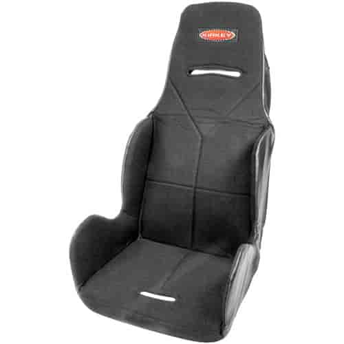

PostPosted: Wed Dec 11, 2024 2:09 pm    Post subject: Re: Vokaro project car Reply with quote
Have you looked at the padded Kirkey Racing 16 Series seats (or similar)? They're available in 15.5" and 17.5" width. Being aluminum, you could plate and fixed mount them to the floor. And they would fit right in with the style of your car.

PostPosted: Tue Dec 10, 2024 5:36 pm    Post subject: Re: Vokaro project car Reply with quote
I have looked at a few production seat, the 914 being one of them....
have never seen Saab seats in real life.
As I do not have a normal tunnel I do have more width room and quite a few seats fit into the area.
The problem is the height of base. The original kit seats sat flat on the floor in the rear foot well area and had a 2 inch block of foam on top and then was wayyyyy laid back with knees way up. So the total seat thickness was the 1/4 fibre and 2' foam measuring from floor board to butt.
I did not like this seating position, I like to be more upright. My chassis effectively has very dropped floors so I can sit more upright, but the seats have to be thin thin on the bottom. The poly seats are thin bottomed and I barely fit.
So whatever seat that may go on it..... I can handle a little more width than a std VW..... but the total thickness from bottom mount points to top of cushion has to be 2" or less. The 914 seats looked to be way to thick. So far the best thing I have seen is Razr side by side seats..... they are thin and firm but not as hard as poly with slip on covers

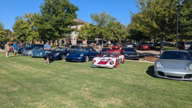

Went to Euro Fest this past weekend.
A couple hundred miles no problems.
Rolled into the "legends" area.... the drive it there cars
Parked in the middle of the "Porsche corral"
Spent most of my time a little bit away from it.
Folks had a big time trying to figure out what it is

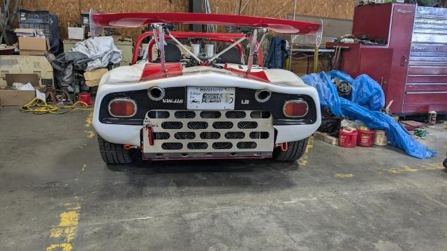

PostPosted: Mon Sep 30, 2024 6:20 pm    Post subject: Re: Vokaro project car Reply with quote
oprn wrote:
Looking awesome! The rear changes, though small definitely make that end if the car look much more finished!
I am very curious to see how the cooling system performs on the highway.
I would not call rear changes small.....
The air flow seems ok so far.
No ribbon testing and have not set up the go pro.
It is supposed to ground effect air up off the end of floor into the engine bay.
The scoops on top are not direct cooling by design.
Actually supposed to let air out to vent the header heat. Seems to work going by the amount of hot air blowing out of them and into the back of my head.
I spent a day and a half back roading, sub 60.
As a side note it likes to go down the twisty back roads with a posted limit at 30.…... but at 60 without knowing/feeling it.
The fans do run a lot at the lower mph and I can not hear it they are running above 45-50.
No overheating, full time at thermostat temperature.
After getting more comfortable with it I did a short highway ride. Did about 20 miles away and the 20 back at 75mph..... and the fans seemed to shut off and the temperature went down about 5 degrees.
So I am supposed to have positive pressure in the engine bay..... and it seems to be true.
And supposed to have negative pressure behind..... and it seems to be true.
I am not well versed in fluid dynamics in an open system.... I do quite a bit in closed (pipes, ducts, ect)
