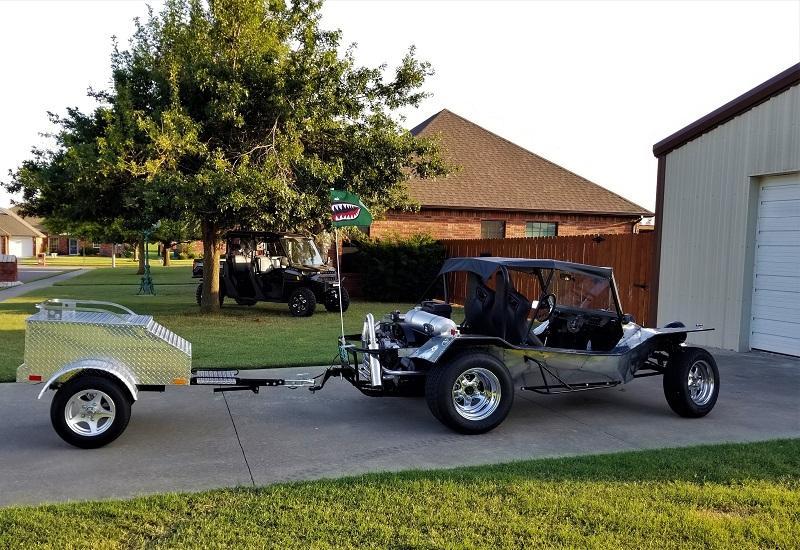

Posting up an update for the Burro. We added a hitch tube receiver so a cargo rack or trailer can be used. The trailer is for a motorcycle and has a rotating coupler. It's really light and works well.
Finally got the CJ bimini top the way we want it. Added a bar to the middle of it for more head room.
Still running great and having loads of fun with it.

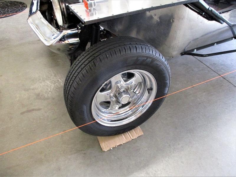

I searched the forums for "beetle front end alignment" and found lots of DIY string methods.
This one is thorough, Post #4 drscope on this link https://www.thesamba.com/vw/forum/viewtopic.php?t=295861
The toe was the only thing I was concerned with and I copied this method. My rear tires are wider than the front. A string was stretched around both back tires (in the center horizontally) past the front wheel on each side, about 10' in front of the car and tied to jack stands. Adjust the jack stands so the string touches the rear of back tire and barely clears the front side. With the steering wheel turned straight you can immediately see if the toe is out one way or another.
Using the string to measure off of, measure the front side and back side of the front rim which gives you a measurement to work with.
The front measurement from the string to the rim should be about an 1/8" further in than the back side of the rim.
For example, if the back side of the front wheel is 2-1/2" the front side should measure 2-3/8". I'm not claiming it to be perfect, but good enough for my Burro.

My first attempt to perform a front-end alignment on the Burro went surprisingly well.
When standing back from the Burro in the front, it was easy to see that the toe was different from side to side. Used jack stands and a string as explained by others in the forum to do some adjusting. It may not be in perfect alignment specs but it looks and drives better.

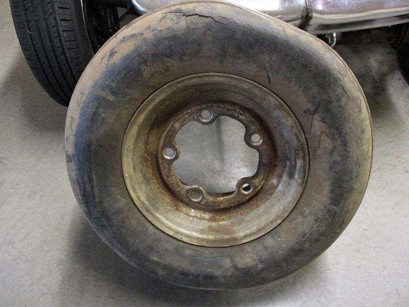

PostPosted: Sat Jan 30, 2021 1:22 pm    Post subject: Re: Need help please... grandfather / grandson project Reply with quote
Was wondering why the original wheels only weighed in at 20 lbs. each, I didn’t pay close enough attention. Figured out they are 14 in. x 10 in. with a 2" backspace (not a 15-inch 5x205). The Atco farm implement tire is a 11L-14 - 29.6 x 10.6 inches.
The buggy originally had 14” rims on the rear and 5x4.75-14 Cragar SS rims on the front using an adaptor. So, back to the drawing board for me.
Looking to find some 14” smoothies, maybe for a bus?? to use on the front.

PostPosted: Fri Jan 29, 2021 9:03 pm    Post subject: Re: Need help please... grandfather / grandson project Reply with quote
Found the missing rear wheel (widened 5x205 with OE implement tire) today at my Uncle's place. I'm pretty stoked about it.
They have large valve stem holes for tubes, so I need to find out how to correct that for tubeless tires. Any ideas?
Now, I need to find two smoothies for the front and get all of them powder coated.
Still don't know what color yet.
