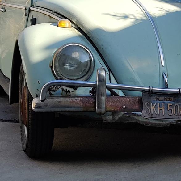

PostPosted: Wed Apr 20, 2022 7:30 am    Post subject: Re: 66 Bahama Blue Father/Son Project Reply with quote
Maybe you got the longer 1275mm (50.2") length to fit earlier Beetles, instead of the one that's 1225mm (48.2").
Order says ... 1195mm Just seems really long. Smile
Your headlight glass is installed upside down.
Doh! Rolling Eyes Thanks! Glad I didnt get them remounted before I noticed!

PostPosted: Wed Apr 20, 2022 7:13 am    Post subject: Re: 66 Bahama Blue Father/Son Project Reply with quote

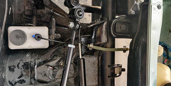

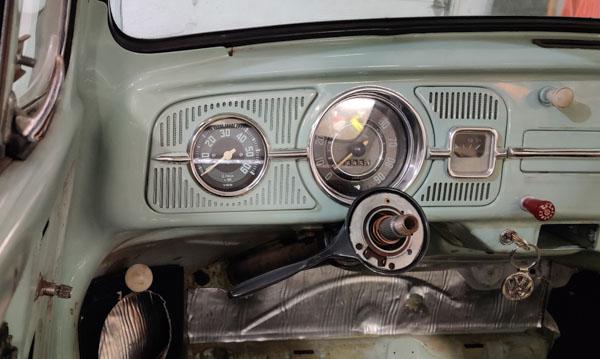

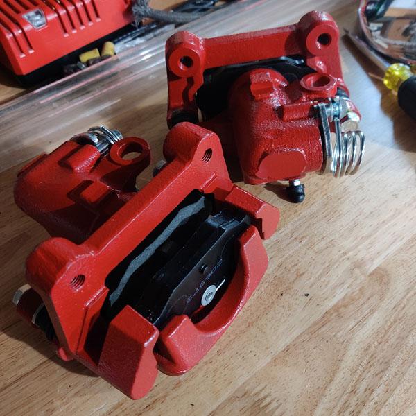

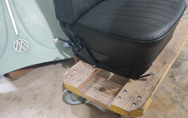

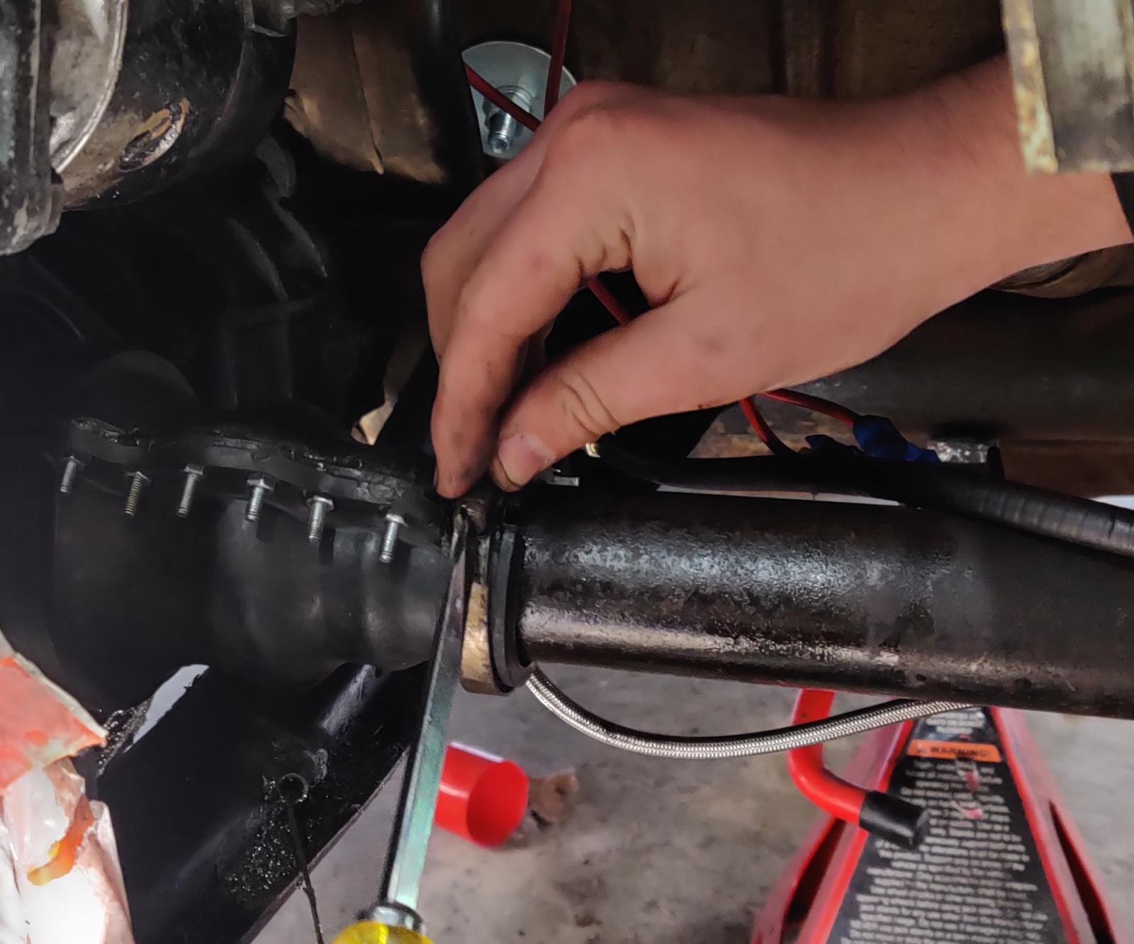

Been plugging away. Got some stuff done.
The Interior looks good. The carpet kit we got didn't fit ... So, we went with the WW kit and ordered a couple extra carpet pieces for the front speaker panels.
Put the new drop spring plates.
Pulled the old shift rod refreshed it with a little light sanding and some grease. Put in a new shift bushing and new pads on the shift coupler. Had a minor WTF moment when I saw that the shift rod has a bend in it that I was unaware is how its intended to be. The 73 SB was not this way. thesamba search button the the rescue Very Happy
Mounted the master cylinder and ran all new breaklines. Figured out the configuration we wanted to use for the brake fluid reservoir. We decided to keep things looking stock. So, we mounted a dual master cylinder reservoir on the master cylinder and ran a line from the old (tiny) OEM brake fluid reservoir down to the new master cylinder. Looks like it will work well.
Doors are good. These took way more time than I thought they would. We did all of the seals, rubber, scrapers, chrome, and new door card panels. Added sound deadening, rust neutralizer, and welded up a couple patches where rust had eaten through the door. Rebuilt the wing windows and put new wing window locks in. The old wing locks were way sloppy and old.
Got the wiring completely done! Whew. Few extras ... Usb charger in ashtray, X-Celerator Speed Wheel and Clutch Pedal Shaft from classic bug parts, Pedal-Activated Brake Light Switch, wired up a floor dimmer switch for the fog light we will be adding later. Also got the stereo, tach, and electric windshield sprayer in.
For the stereo we went without a head unit and installed a Sony XM-GS6DSP GS Series 6/5 Channel Class-D Bluetooth Amplifier with DSP / 2 - 10 subs / 2 - 6x9 in back / 2 - 6.5" up front. This turned out as good as I had hoped it would. Its a great stereo system and we (my son and I) both love not having a head unit in the car. I was SUPER stoked that our sub/speaker box that we built for out last bug fit perfectly in the 66. Got our front speaker panels mounted and carpeted.
We got lucky and a little lube got the speedo running good. It was jerky and bouncy. Does anyone know why the speedo cable is so freaking long? I was wondering if I got the wrong one, but I have double checked the order.
Got the headlights rebuilt/cleaned-up/repainted. Added LED headlights.
Getting started on the rear brake conversion this weekend.
