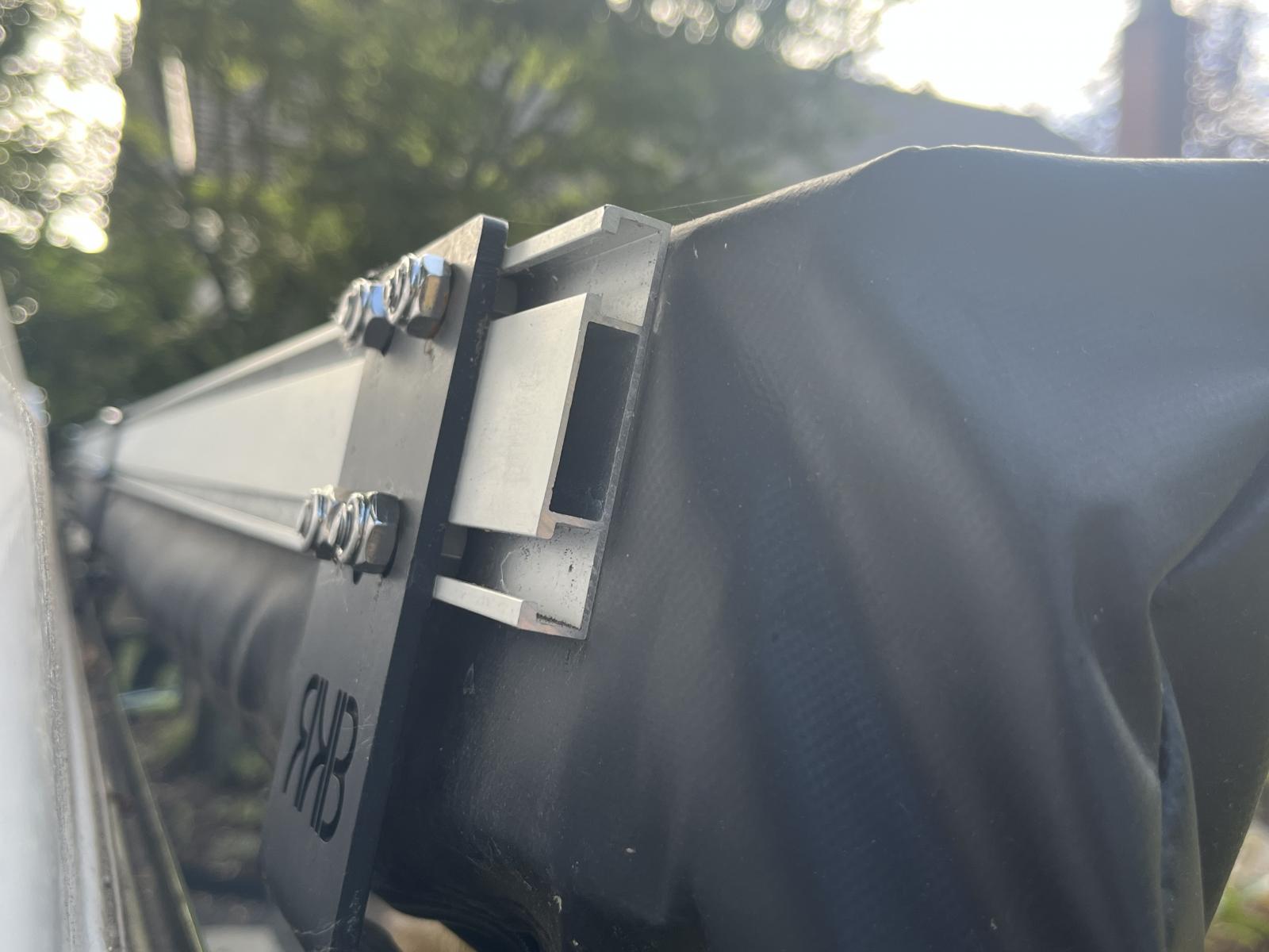

4Gears4Tires
Joined: October 08, 2018
Posts: 4361
Location: MD
4Gears4Tires is offline
PostPosted: Wed Jul 02, 2025 2:12 pm    Post subject: Re: $99 NAPA Awning- Copy of ARB? Reply with quote
Use a drift and a mallet to tap them off.

PostPosted: Wed Jul 02, 2025 2:00 pm    Post subject: Re: $99 NAPA Awning- Copy of ARB? Reply with quote
Xevin wrote:
I just use the tape that came with it. I check and clean under the brackets each year.
https://www.thesamba.com/vw/classifieds/detail.php?id=2665175
So I do need to pry off the black end caps of the awning mounting rail to get the heads of the bolts to slide in, correct? They're firmly attached and seem like they're not designed to come off. But I can't figure any other way to get the heads into the slots of the mounting track.
Thanks
Grateful daily,
Ryan

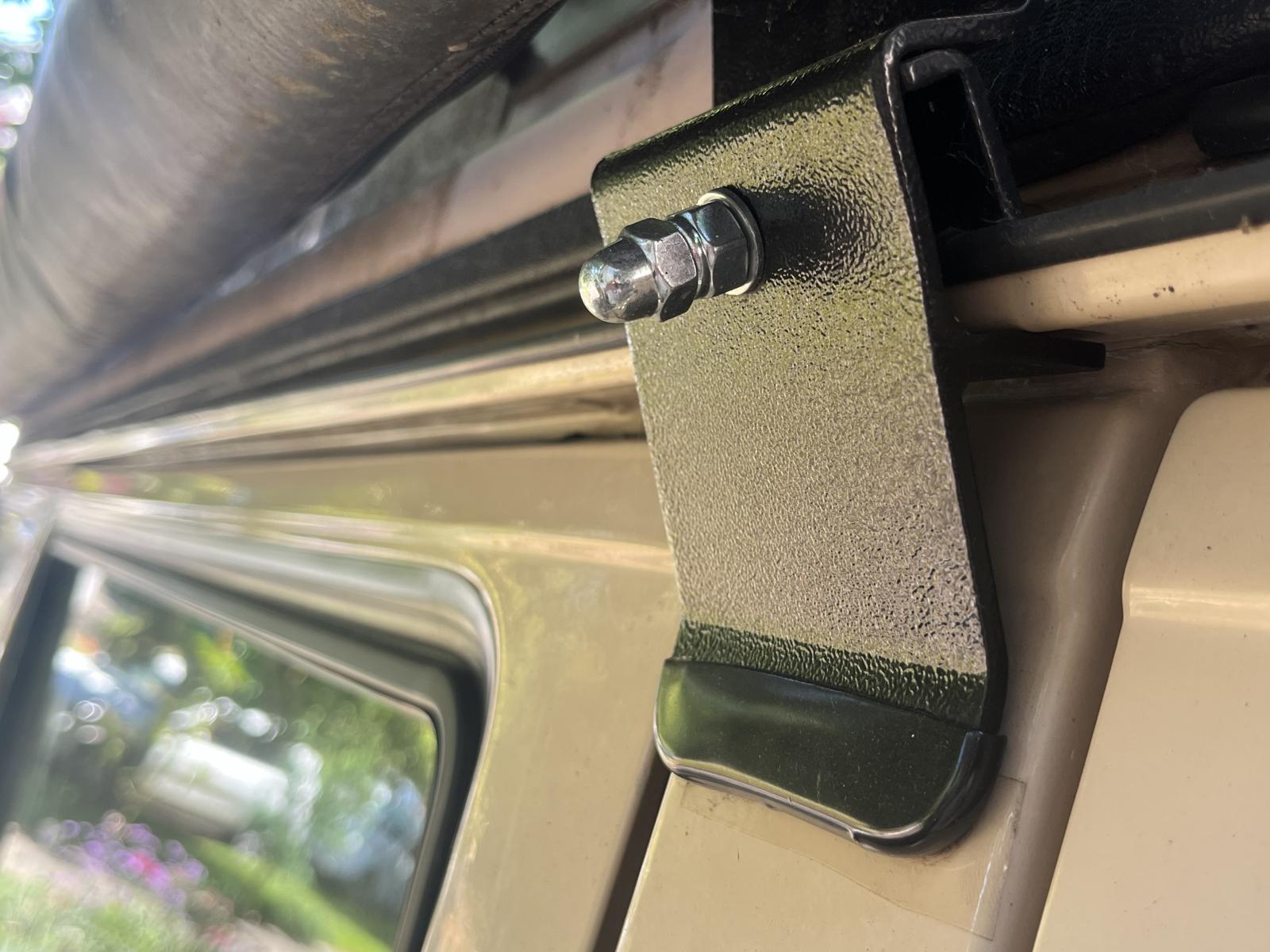

PostPosted: Wed Jul 02, 2025 9:47 am    Post subject: Re: $99 NAPA Awning- Copy of ARB? Reply with quote
I just use the tape that came with it. I check and clean under the brackets each year. On the 76 bus, Tim Baker includes a firm piece of foam rubber on the feet.

PostPosted: Wed Jul 02, 2025 8:12 am    Post subject: Re: $99 NAPA Awning- Copy of ARB? Reply with quote
Xevin: I used the tape wherever it touched the paint of the van. Acorn nut for covering exposed threads after the fastening nut, to prevent snags.
Did you use VHB tape, or are you referring to the 3M paint protection film supplied by RMW with the brackets?

PostPosted: Tue Jul 01, 2025 1:19 pm    Post subject: Re: $99 NAPA Awning- Copy of ARB? Reply with quote
deadaheadub wrote:
Xevin wrote:
deadaheadub wrote:

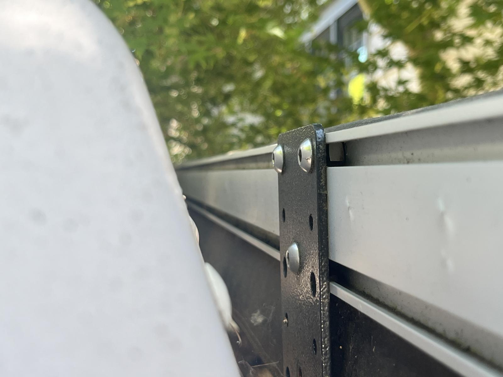

Got my RMW awning brackets from Van Cafe today.
Does anyone have a pic of how they mounted the NAPA awning onto the brackets on their poptop? Do I need to use the L brackets that came with the NAPA for height? Or does the awning frame mount directly onto the RMW bracket resting on the gutter? A pic of the awning attached to the bracket on the gutter would be most helpful. Thanks!
Take a look at my post on page 13. If you need more pictures. Let me know
https://www.thesamba.com/vw/forum/viewtopic.php?t=...;start=240
So that pic is looking down from the perspective of the poptop? Just 3 holes drilled into the NAPA frame, attached directly to the top of the RMW bracket, do I have that right?
Did you NOT drill a hole to bolt the bottom part of the bracket into the pillars? I would like to not drill.
Did you use the VHB tape as some have suggested?
Do you use the tape everywhere the bracket contacts the van, in the gutter and on the pillar side?
I know, a lot of little detail questions.
Thank you
Only hole drilled is the single bolt on the RMW bracket. See how it is offset from the two holes on each side of it? Just a tad higher. A punch is your friend before you drill that hole. No need to drill anything in the Napa frame. The jam nuts slide into the track and then tighten down. I found an allen head easy to fit a wrench down in there.
No holes in to pillars for me. Thats your call. If I did a bunch of off road roads. I probably would. But do research this thread for excellent guy line examples.

PostPosted: Wed May 03, 2023 8:50 am    Post subject: Re: $99 NAPA Awning- Copy of ARB? Reply with quote
Installation was pretty straightforward using the MaxiTrac provided stainless hardware. I used the North Westy stainless bracket and followed suite with revolution337’s earlier post. I also cut about 4mm off of the bolts to clear the pop top, though that may not have been necessary.
