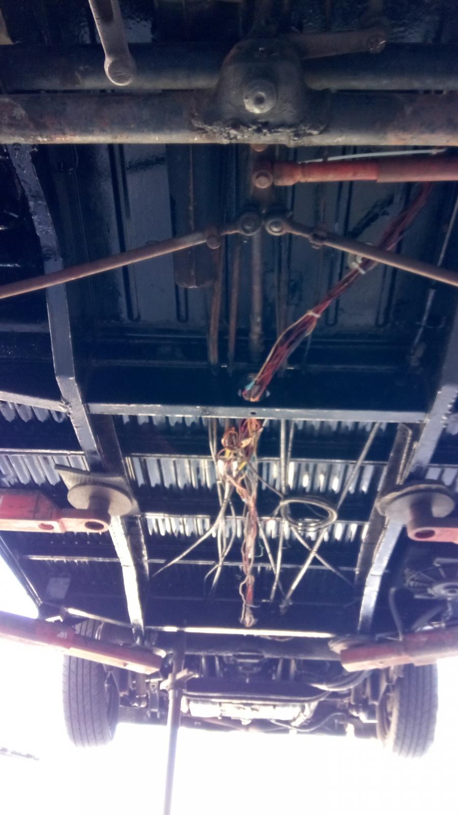

I think the best way to support a bus is pretty subjective based on time, money and the desired end result. I cut quite a bit out, but before I freed up the frame sections, I welded the two main framerails together, top and bottom, kind of like a beefy crossmember. Before I cut out my cargo rocker, and floor I attempted to tie the B and C pillars together with a brace across the cargo door, but that popped and failed. I kept going back to it after I cut out everything for reference, and those pillars didn't move move than .090".
Best factory job would be Celette frame jig like Deluxe Customs is doing 356's. Best access would be a rotisserie tied into the front axle and the rear torsion housing with a bunch of diagonal support braces welded to the body corners. I started with a level garage floor, got is super plumb before tear down, and built it in place using a regular bubble level as a reference. I had two jackstands under the front beam and two under the torsion tube. That seemed like pretty close to the weight of the bus sitting on its suspension without the tires being in the way.
Old busses move. My buddy Chato does Westy interiors and all of his templates are 1" oversize because they all sag in different ways throughout the years. Mine ain't a Seinfeld bus, so I did what seemed right for me. Good luck with your projects, hopefully that helps.

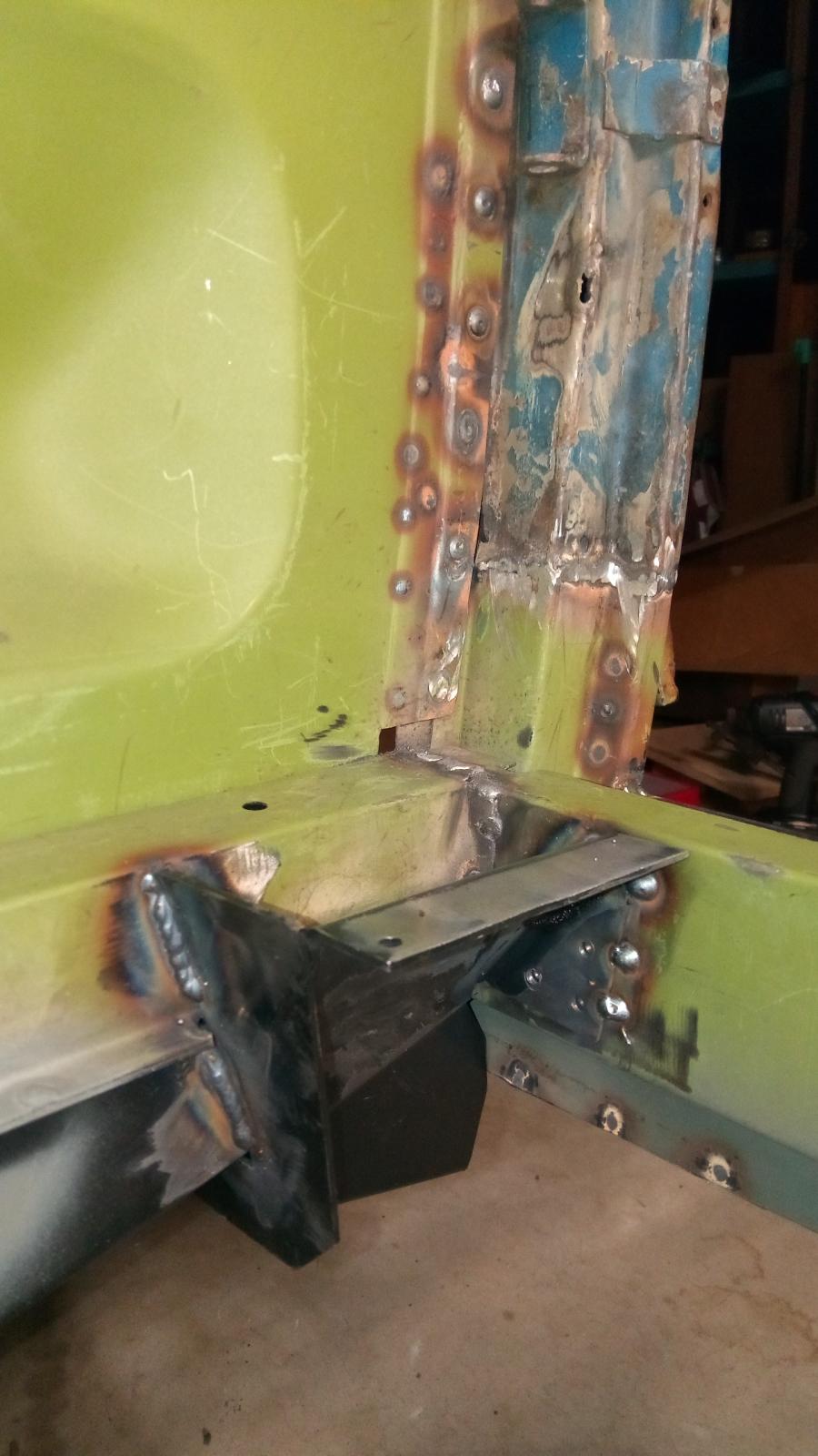

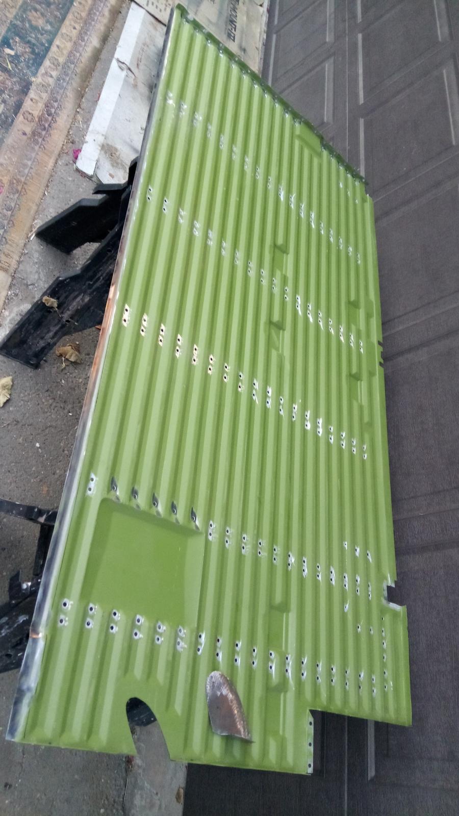

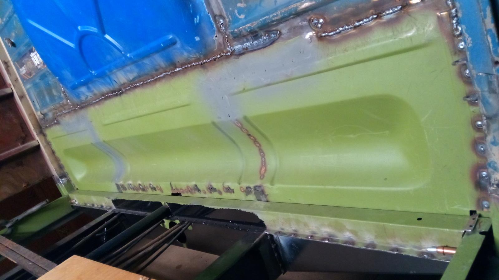

Cargo floors in. Got it to driver status. I had some gaps between the floor and the pillars so I made tabs to tie them together. It feels way less flexy than before all the work.
Seam sealer was recommended by mike fn garage, the OSI from home depot. It's cheap and keeping the water out seems like the right thing to do.

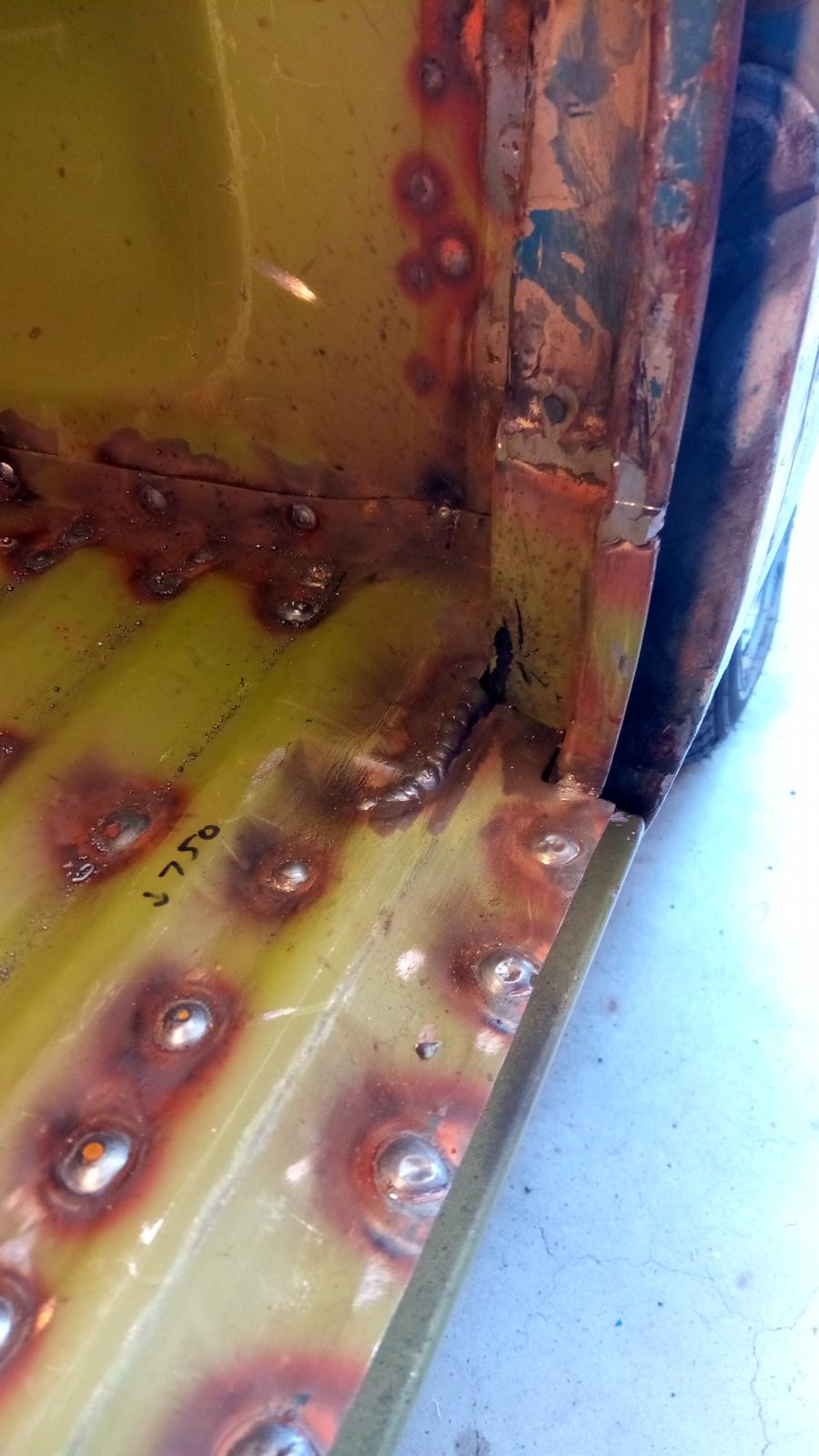

Long Panel Install. Used a shrinker to re-flange the rotten pillars.
Grafting in new I beam ends.
Tophat repair
Wheel well closeouts

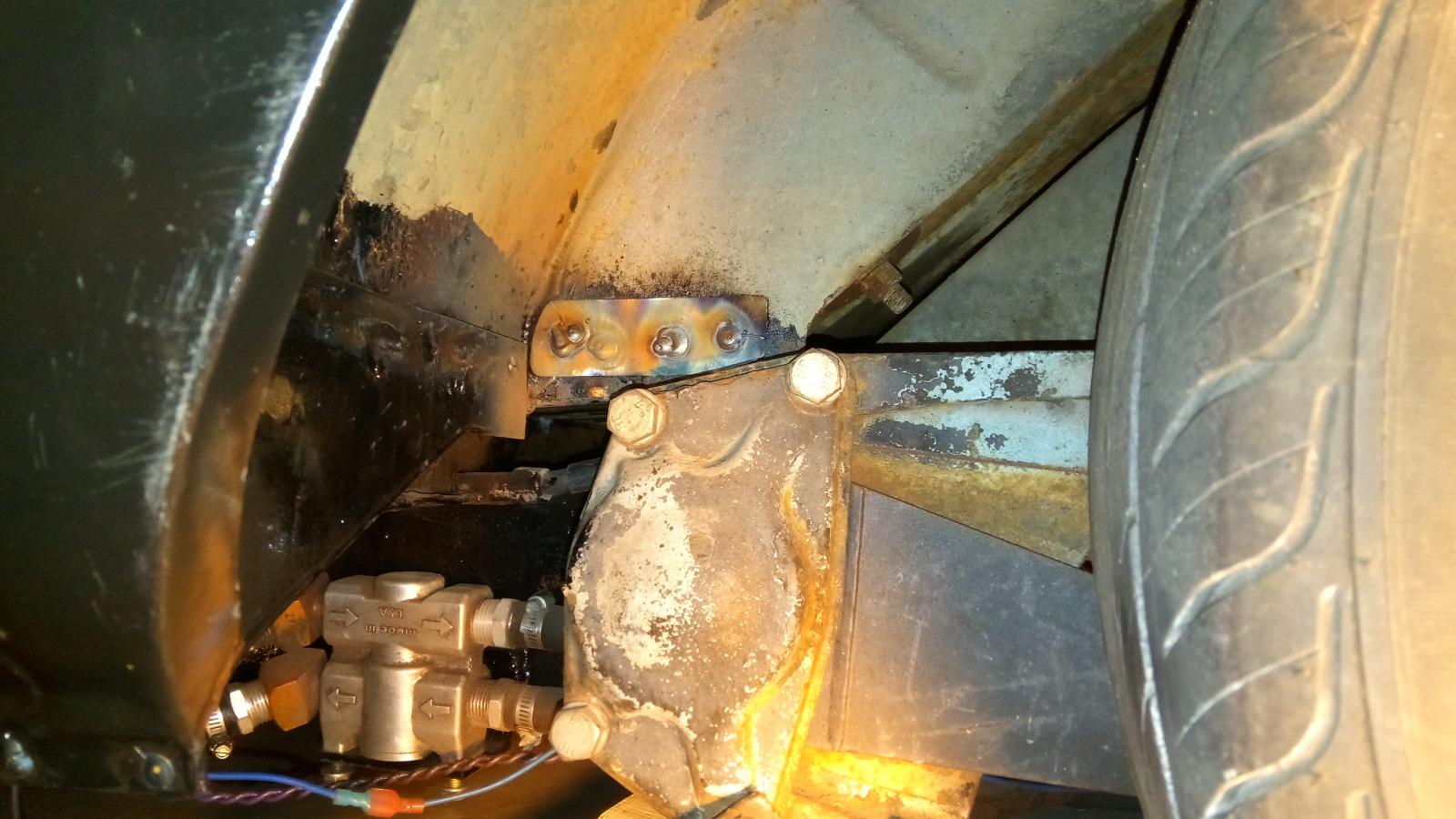

Jackpoint Install

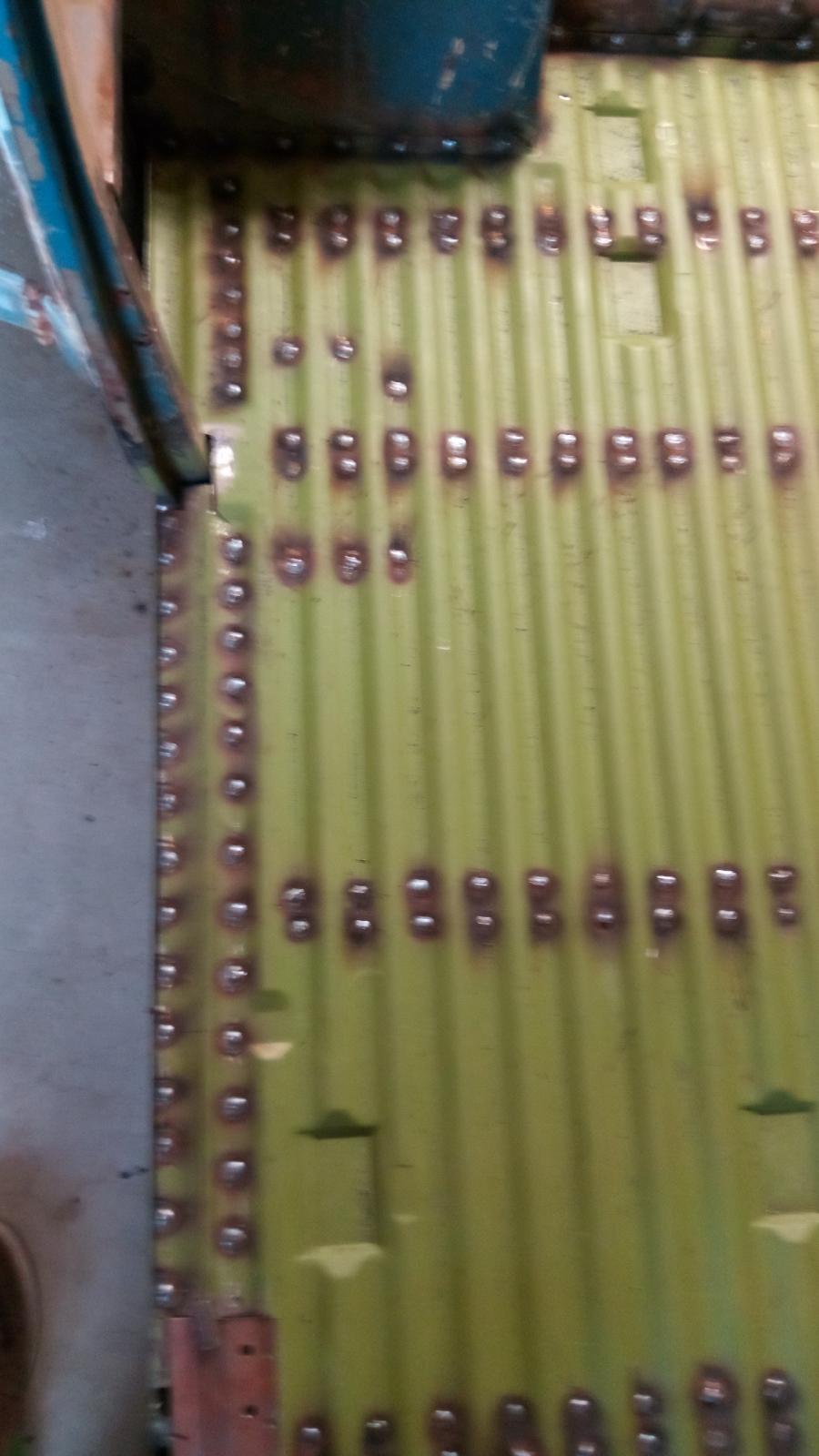

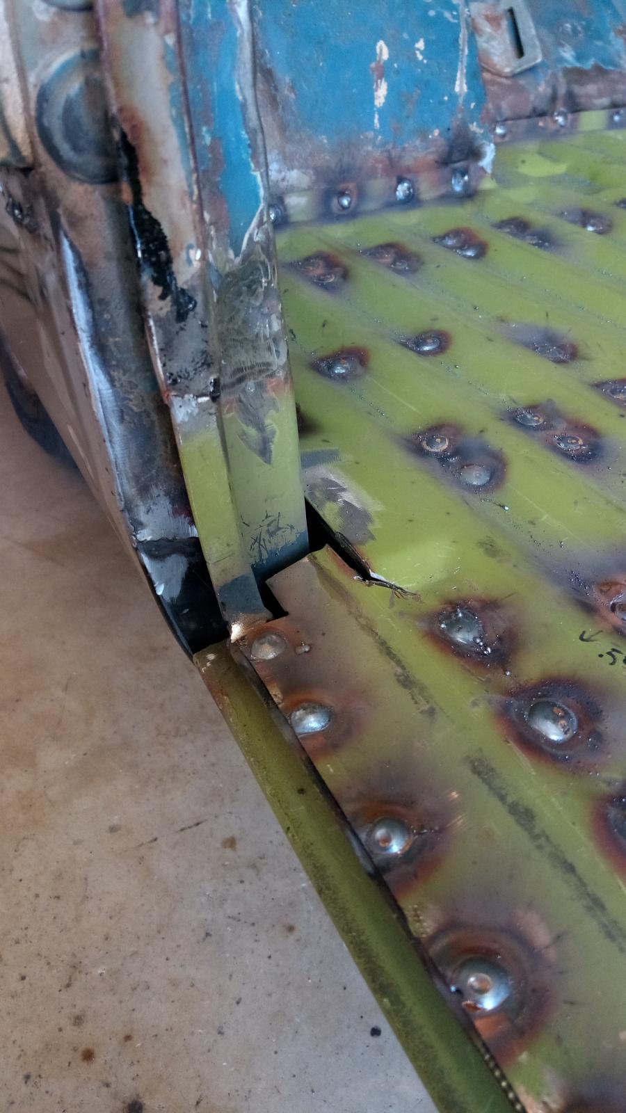

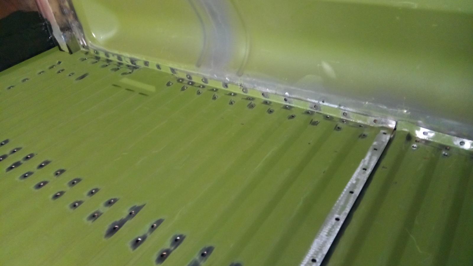

Floor fitting with heater delete. Note the fat gap because the floor sunk up or the body sunk down. Either way I had to close the gap.

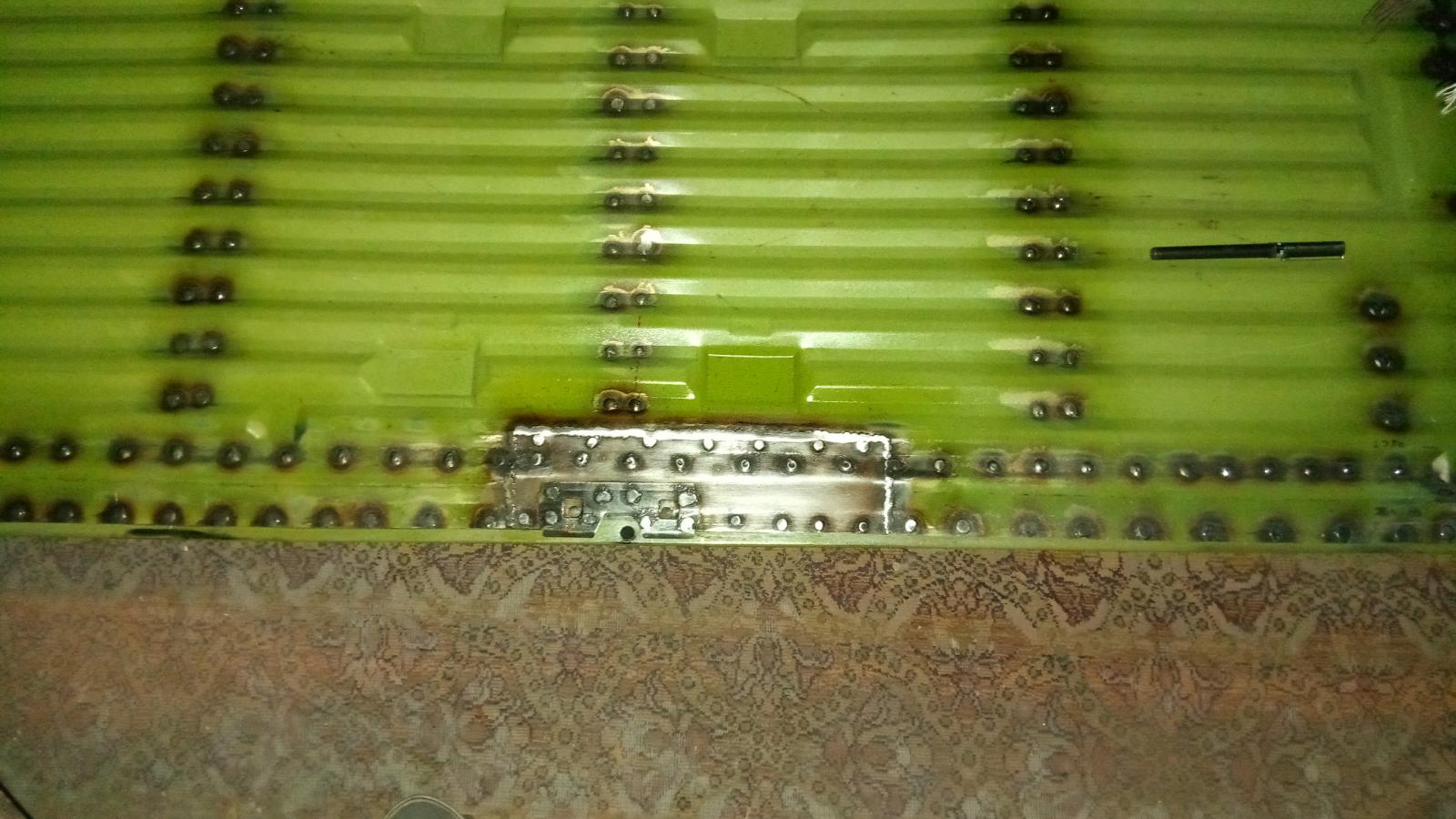

Floor Prep, mark drill paint grind.
More floor fitting

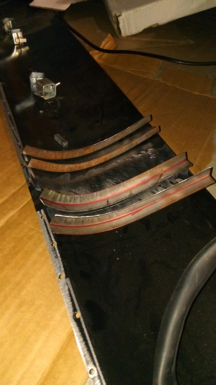

Bend the lip
Latch mod
Floor Welding, 2 man job.

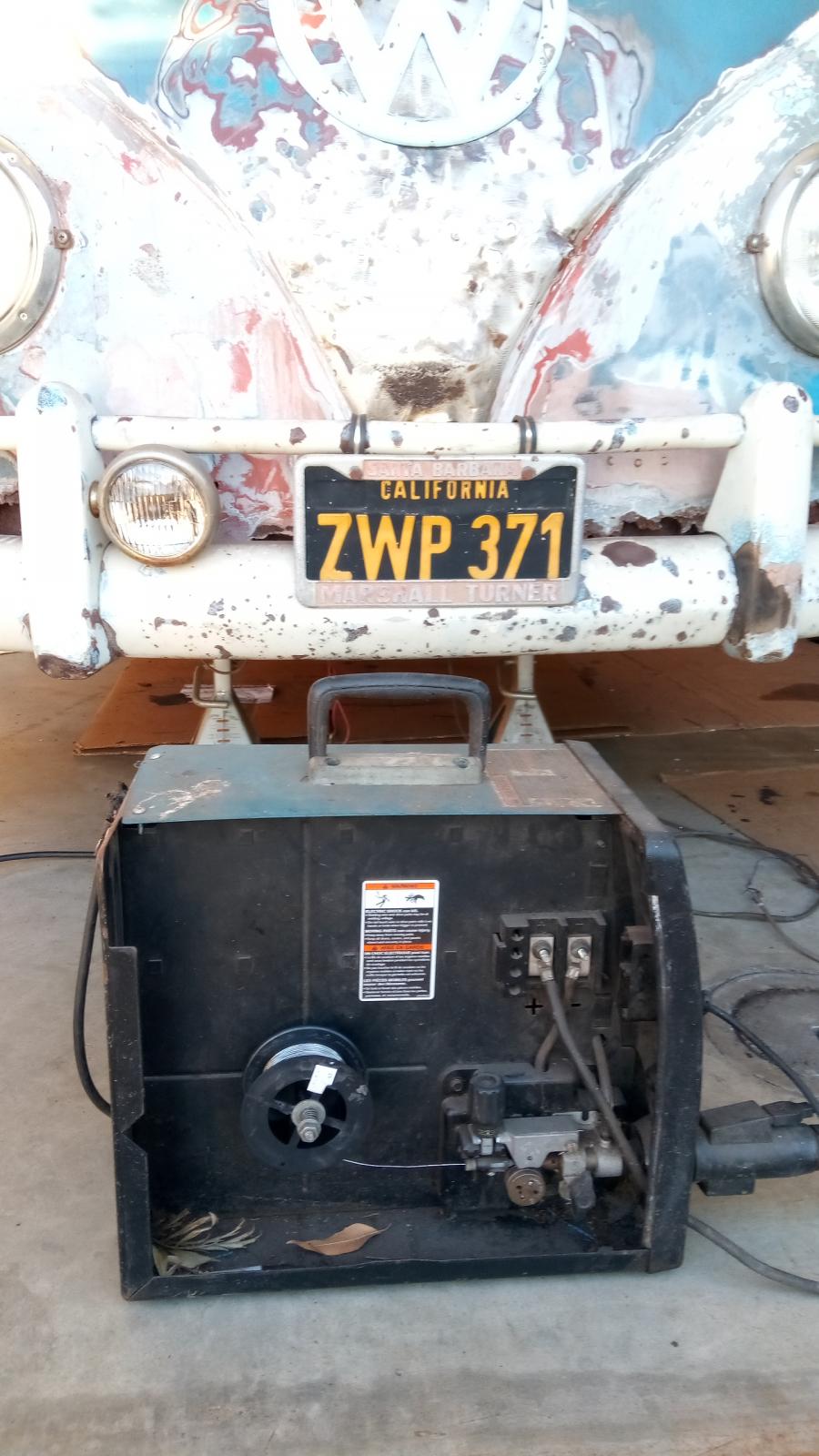

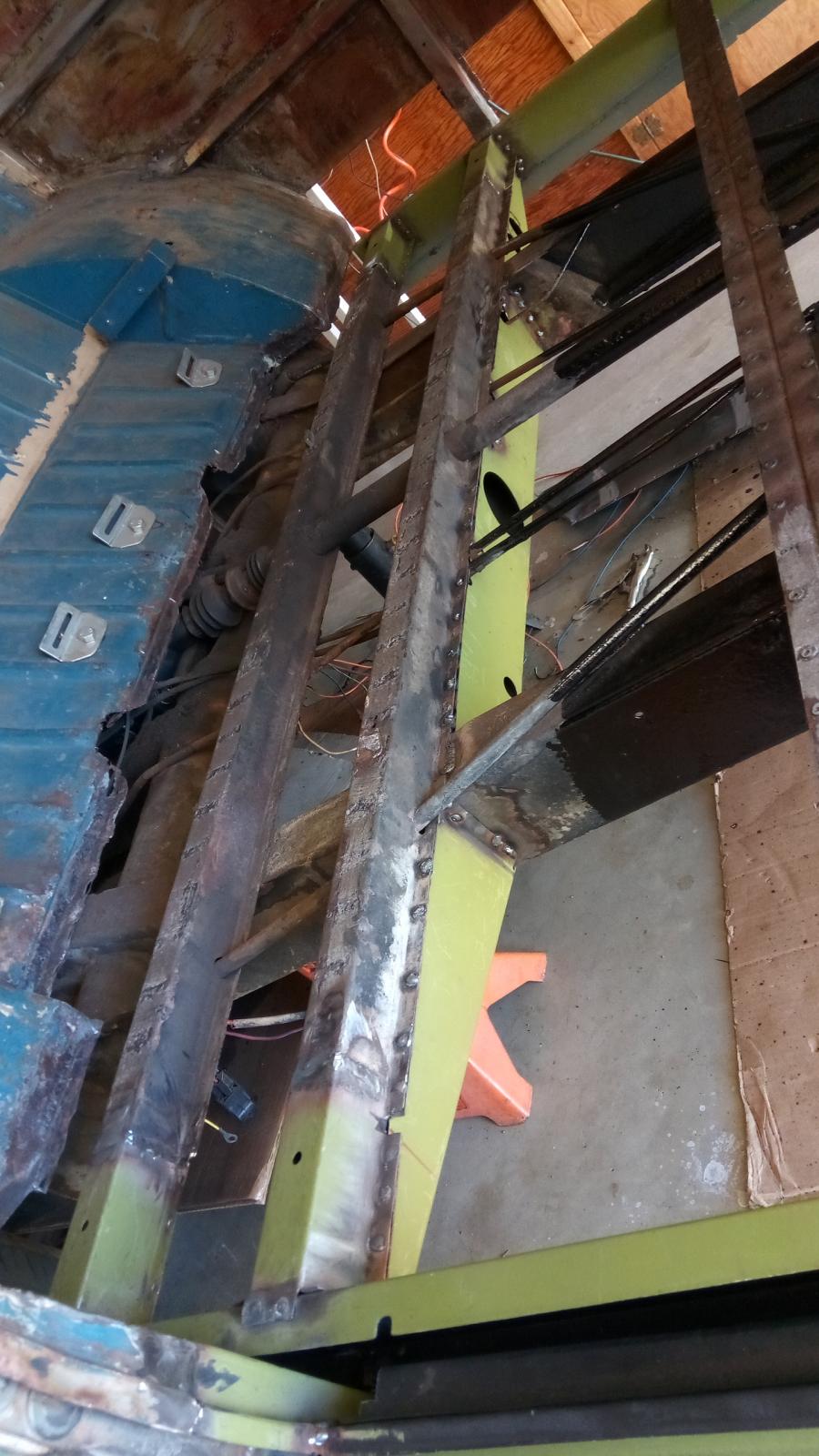

Photo dump. Getting busy with a 110v miller flux core. It is better than my harbor freight flux core, but not nearly as good as the Lincoln 220V with gas.
I had to adjust the length of the autocraft front outriggers to match the klassicfab tophat. Then it went together pretty nicely.

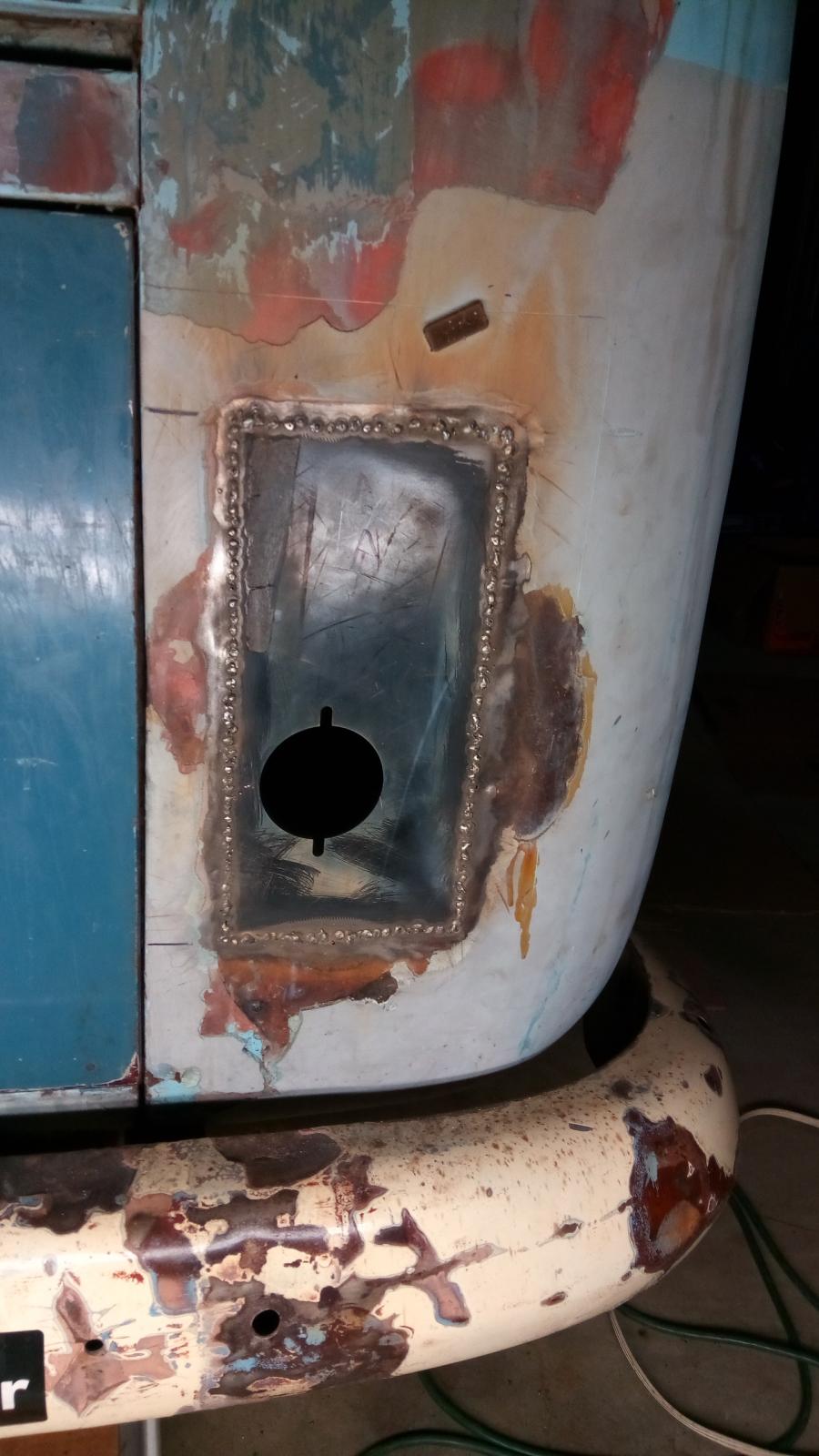

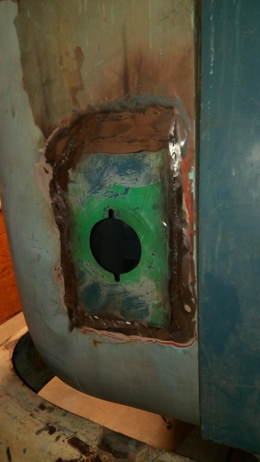

Tail light welding.
Battery tray before, demo and after.
Bullet welding, blowing through rusty shitty, thin metal. Gotta do what you gotta do.

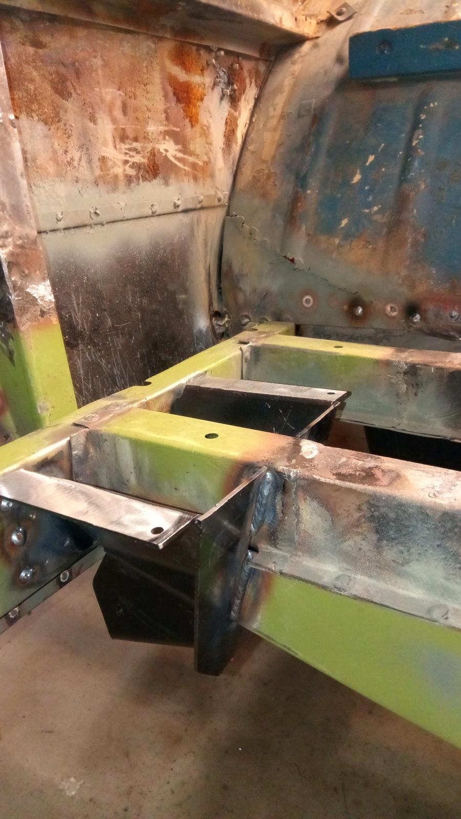

Crossmember install, post welding and after some paint.

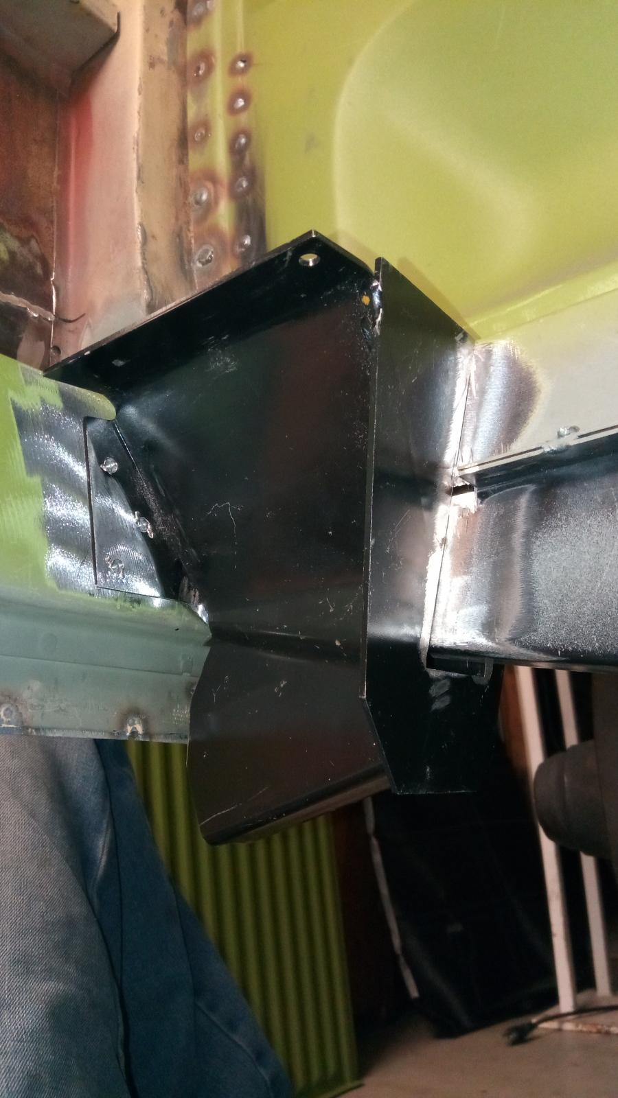

More bulkhead welding. Once the frame patches were in and the bulkhead welded, the whole bus got noticeably stiffer, so that's a good thing. Structural Integrity.

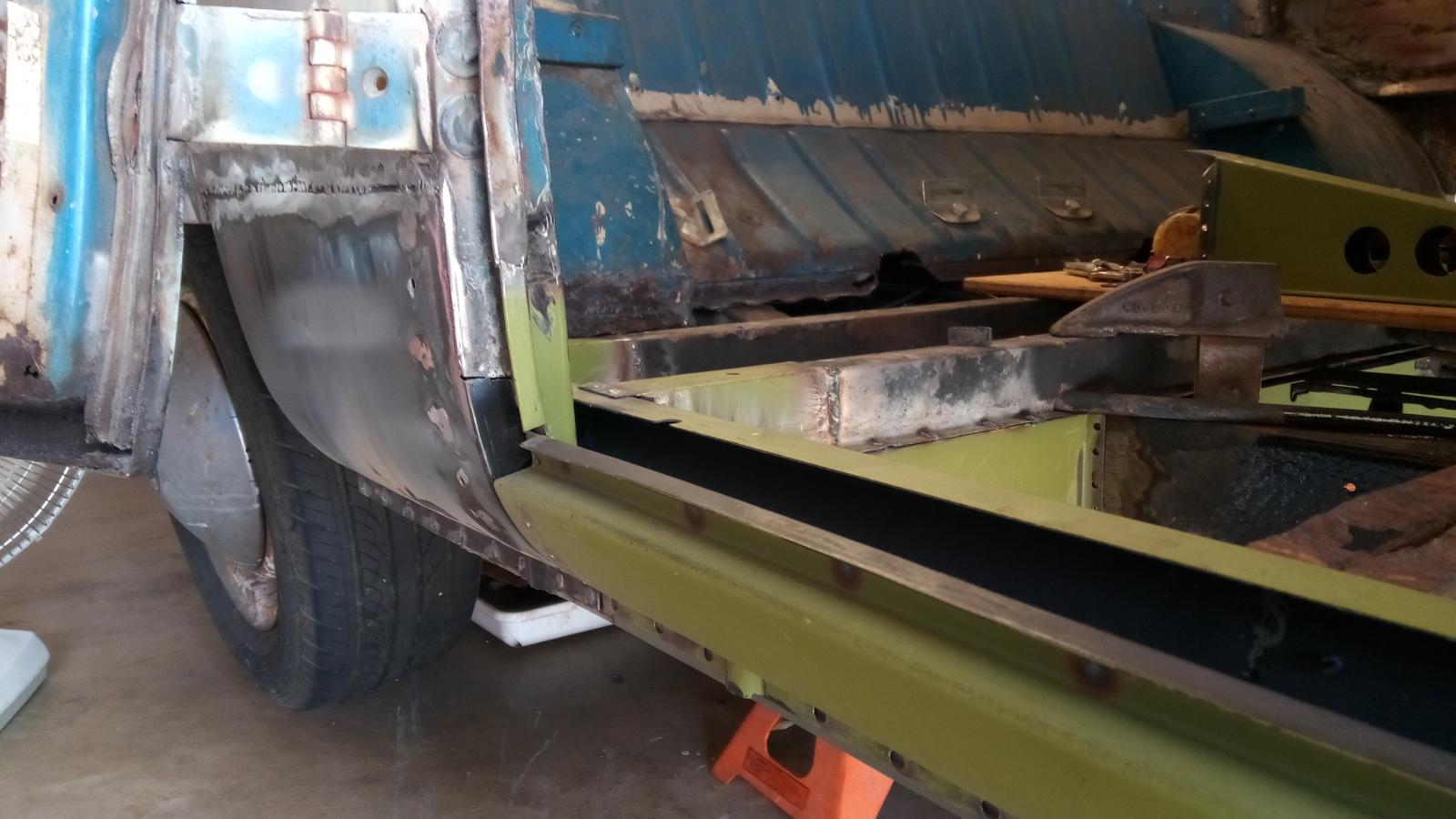

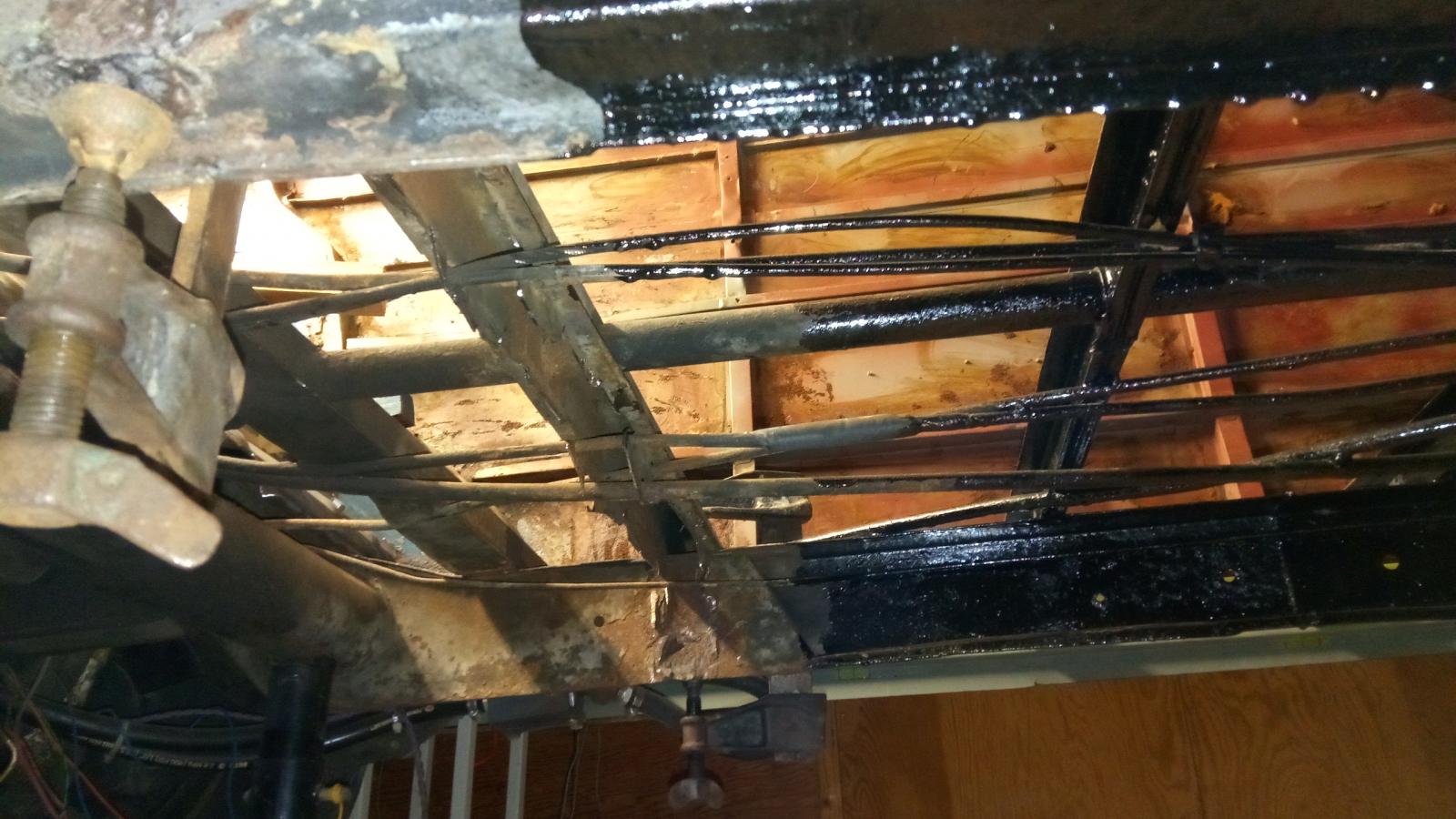

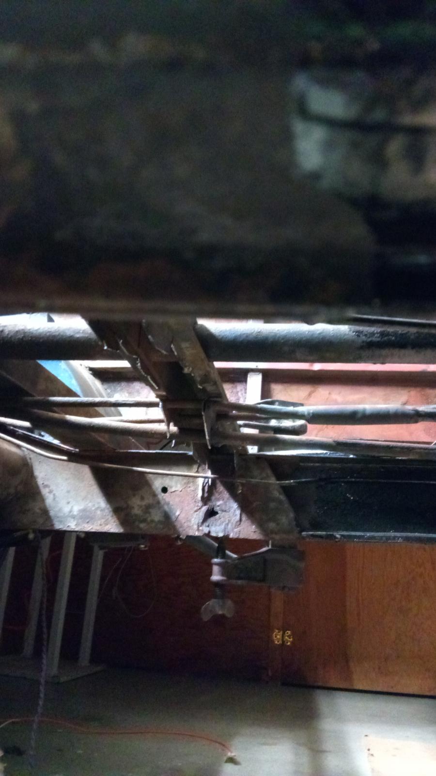

With the b pillar shored up, I started going after the rear crossmember, frame, heater delete and outrigger/jackpoint fitment. The second to last tophat was pulling away from the frame rails, so that's why I had them clamped until I could weld them down. Messy work, but someone's got to do it.

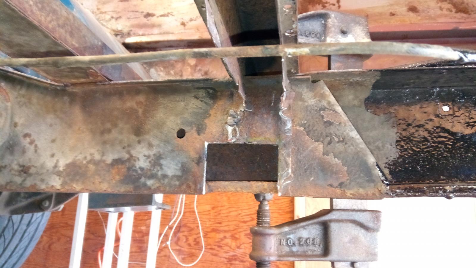

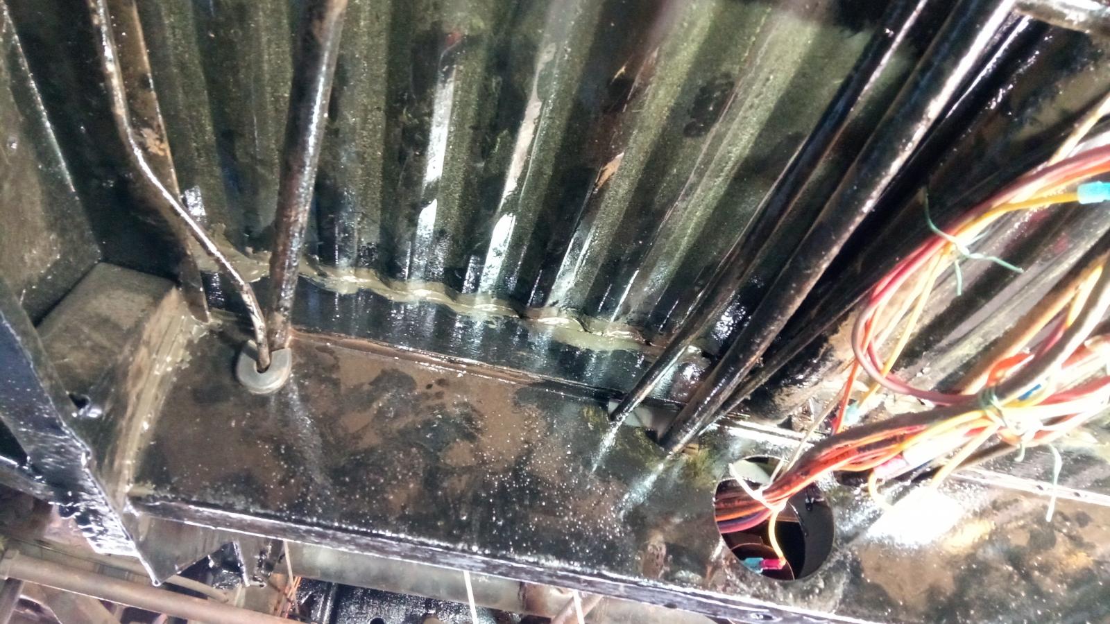

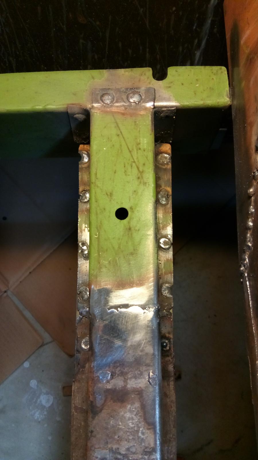

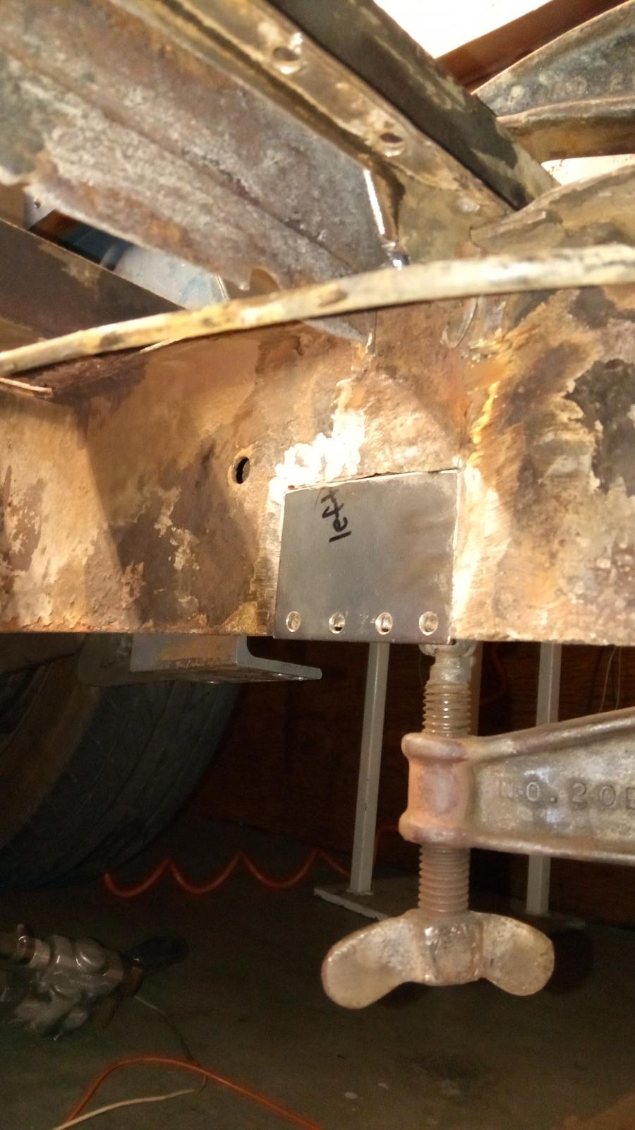

Crust below the torsion tube, so I made a doubler plate. A friend welded it in, because overhead welding is horrible and hard.
Rotten inner frame repair job.
Rear tophat splices and jackpoint and crossmember fitment. The lower closeout on the rearmost tophat was a bitch to weld and I blew holes through the metal. The patch isn't the prettiest, but it covered up the hole I made.

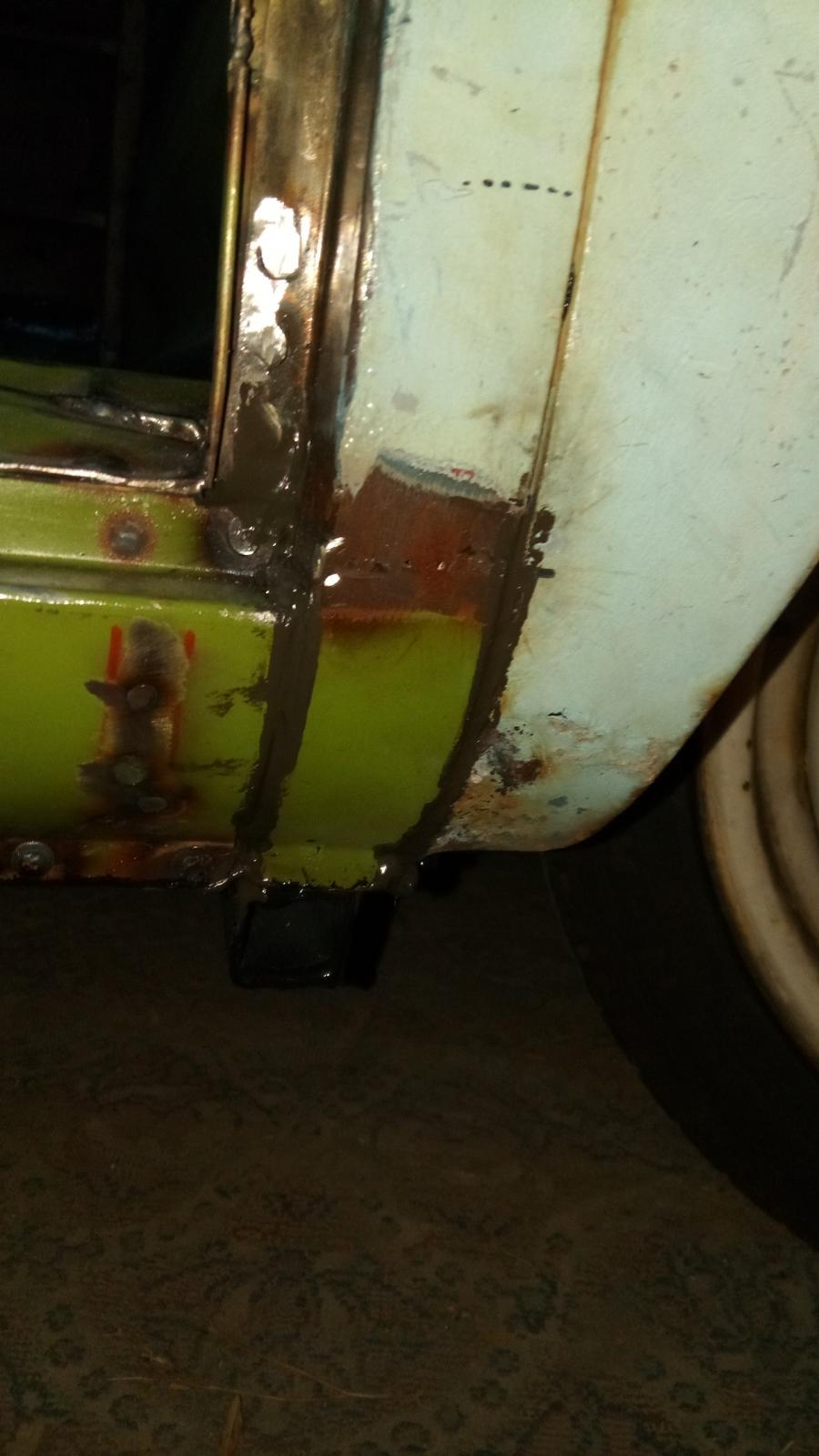

Fitting the rockers to the cargo door and then tying in the c pillar.

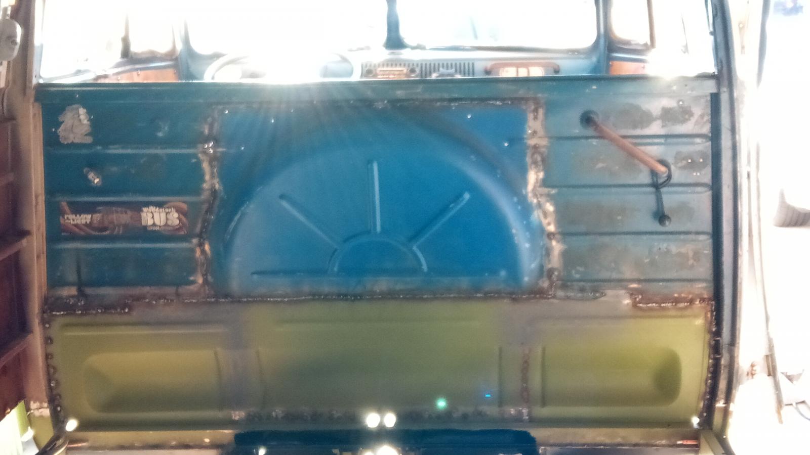

Thanks Karl H. Greetings from San Diego. Some more progress pics. Before the bulkhead goes in, I need to plug some hippy holes in the pedestal. These particular welds were done with a buddy's Miller 110V flux core. .035" wire. Not exactly a stack of dimes but it gets the job done and cleans up with flapper wheels.

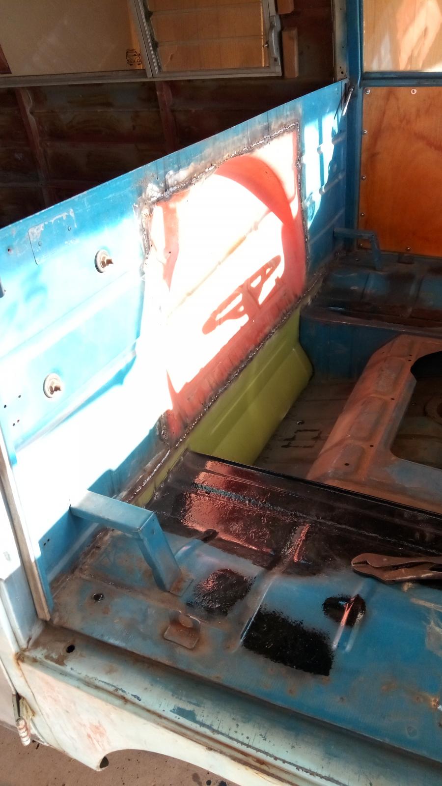

Then I can start to final fit the bulkhead section in place, setting all the gaps for weld. There's not much pillar flange left, but it kind of all sandwiches together with the closeout panels.
Flux core in action. This ended up being a shitload of welding. Hit it from both sides and then grind, then come back and do some pinhole filling. All while trying not to blow holes through the thin panels.
Converting back to 60 turn signals and tail lights. I been waiting a long time and collecting donor parts for this. Pretty sure I nailed the tail light location because the bottom of the original hole was still there. The bullet orientation, I'm not so sure, but time will tell when I put together the outer housing and lens.

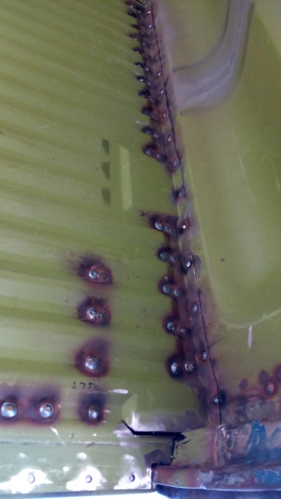

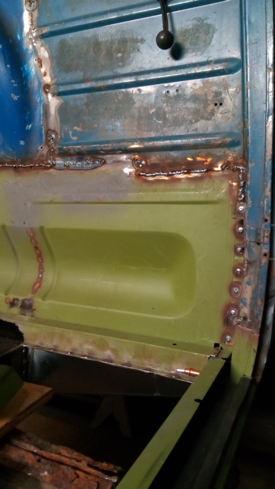

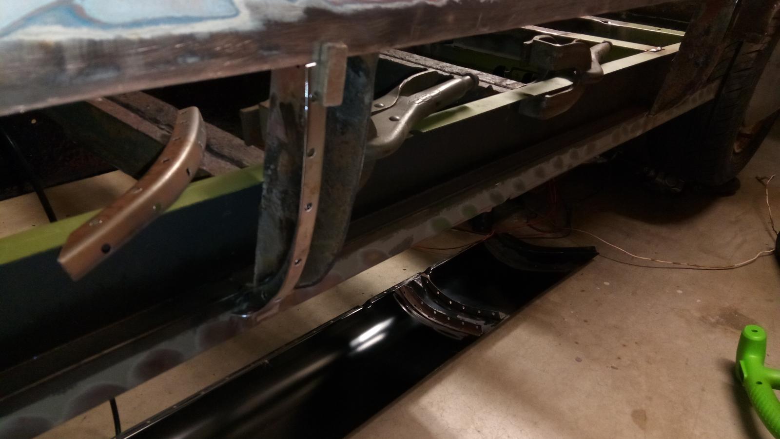

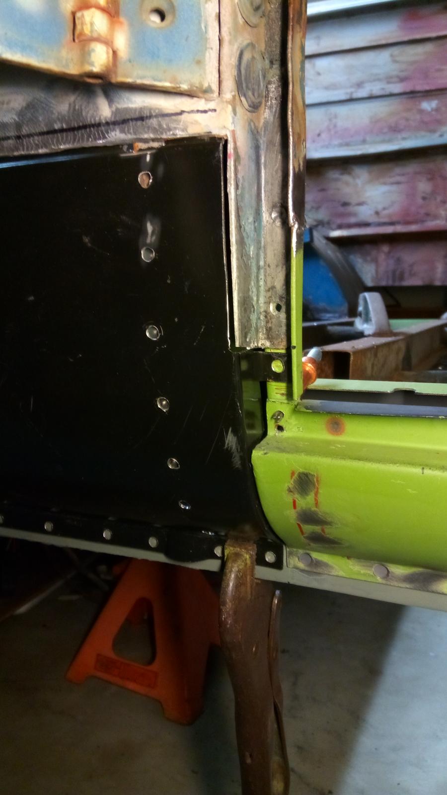

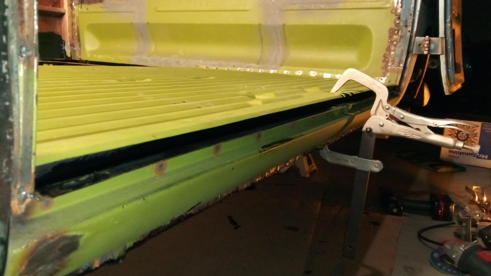

I painted the insides of the cargo rocker and stiffener before spot welding them together. A little protection because once they go together can't get in there.
Hung in the right spot relative to the lower door edges.
Got the short rocker all lined up. Lower C pillar fitted.
I was going to leave the long rocker, but it was too far gone, so it had to go.
Lower bulkhead section fitment. It didn't fit well at the bulge, so I had to make some pie cuts and hammer it to close the gap.
To deal with the bottom seam mismatch, I spot welded some strips to the inner rocker bottom edge. This extends it lower and I can bring the outer rockers together at the bottom seam.

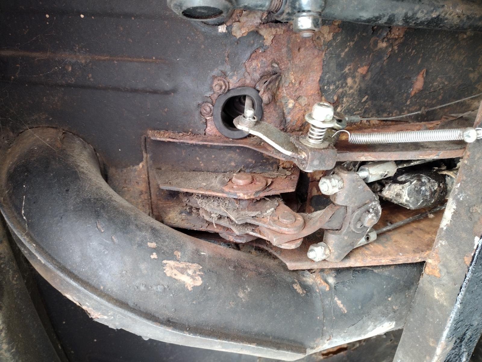

There were some strange hippy stash holes in the center pedestal. I plugged a few and left a few. Not structural, so I'm letting some of them ride. Strange though. Cleaned up some of the crustier parts with a wire wheel.

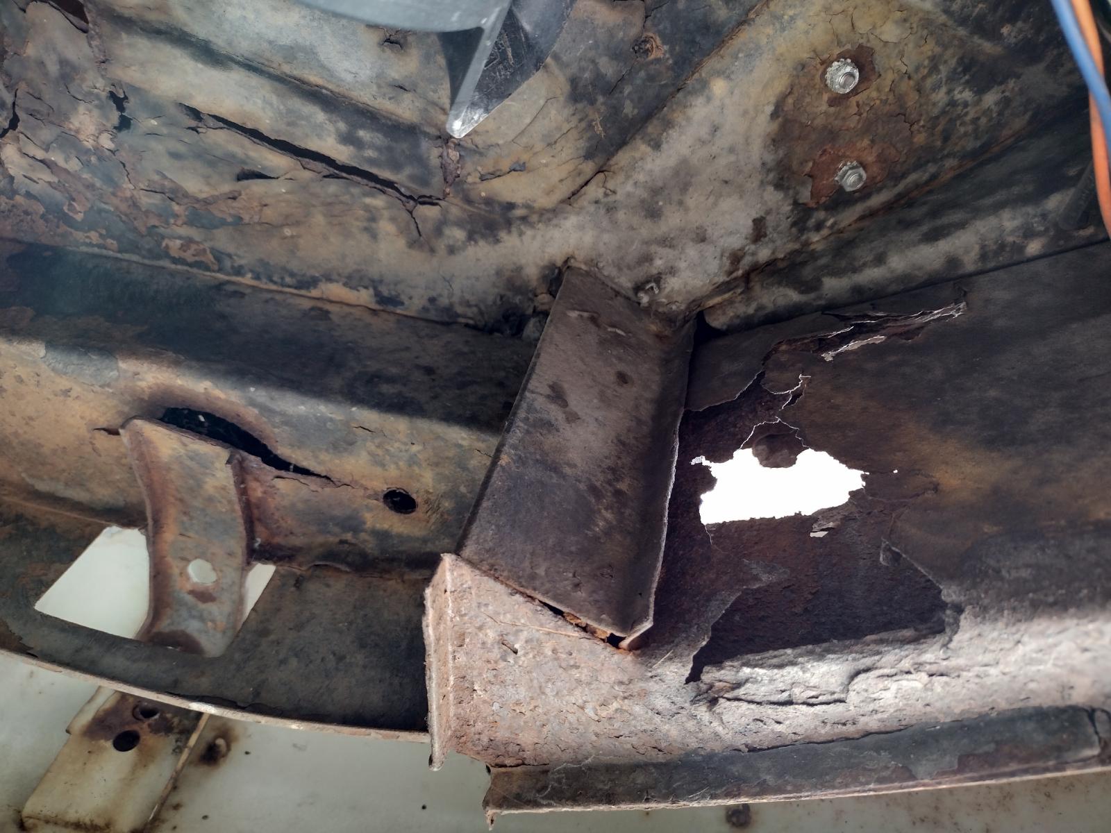

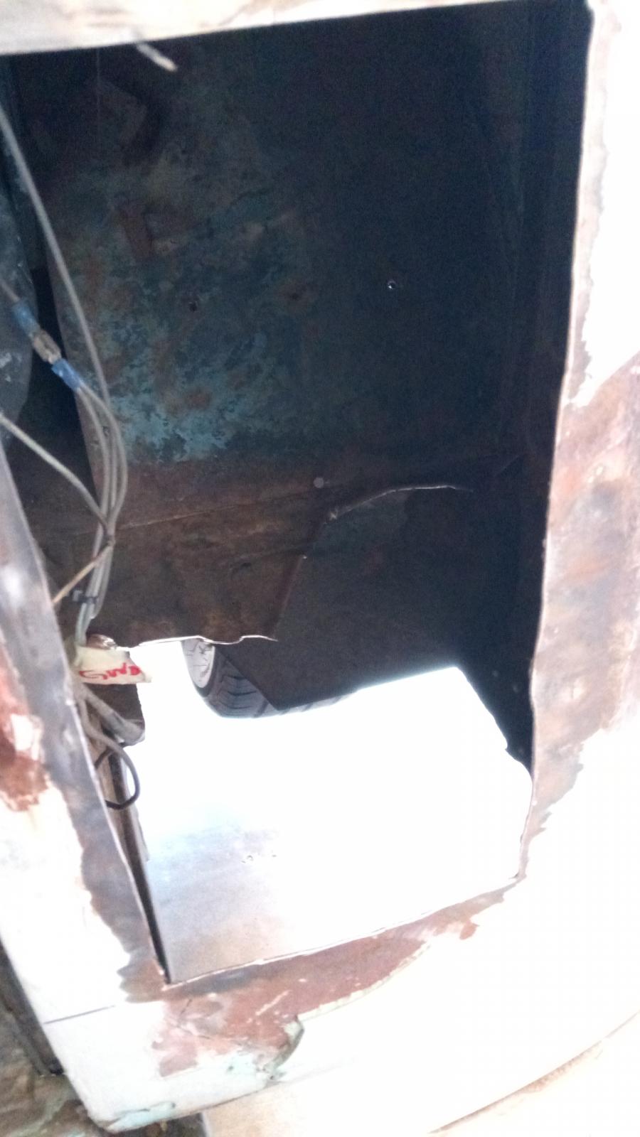

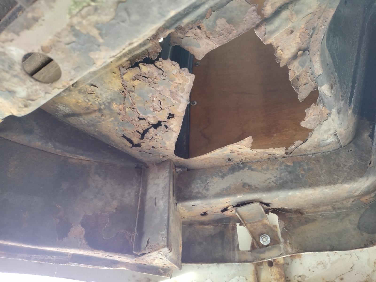

While dissecting the rear section, I found some pretty rough stuff, including some frame rot below the torsion housing I didn't know I had.

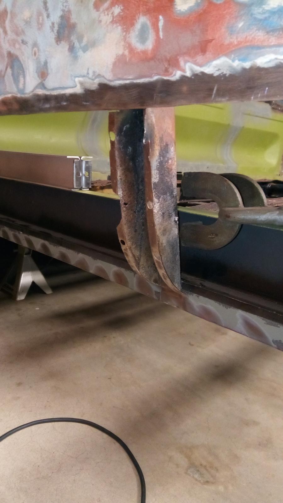

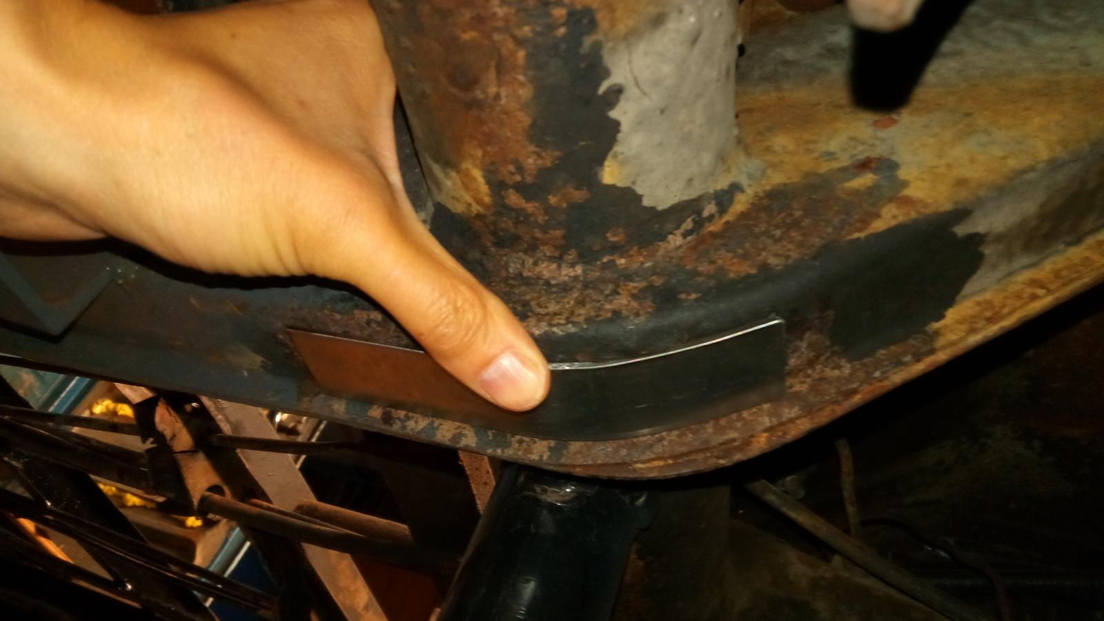

Before I cut out the cargo rocker, I wanted to brace the cargo door opening. I attempted to weld a brace between the pillars, but it kind of failed in every way. I couldn't close the doors with out clearance on the brace, and I was using my harbor freight welder (110V, low setting, .035" flux core, no gas). There was a super fine line between not getting penetration and blowing holes through the thin rusty metal. I ended up not using this brace, but I did keep it around to see how much the pillars moved after removing frame sections.
I got a section of autocraft frame rail section to make my patches. It was the right profile and thickness, so I didn't have to mess with bending the thick stuff. I think it's 14ga or about .075".
My welder is terrible and my skills not up to snuff, so I had a buddy with a 220V Lincoln mig with gas tack it in after I was happy with the fit. I knew I had to shore up the frame kink section before I built up anything around it.
