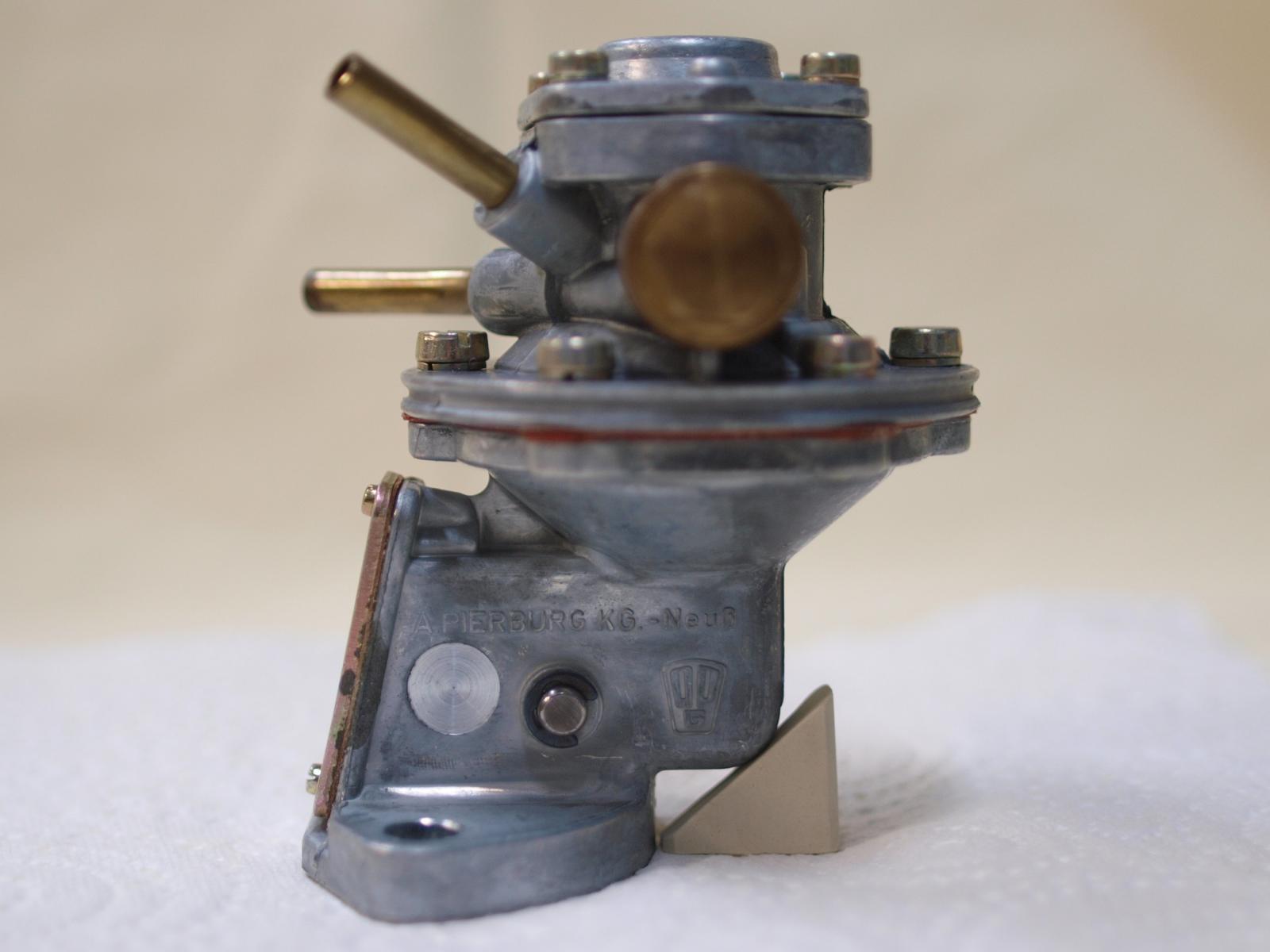

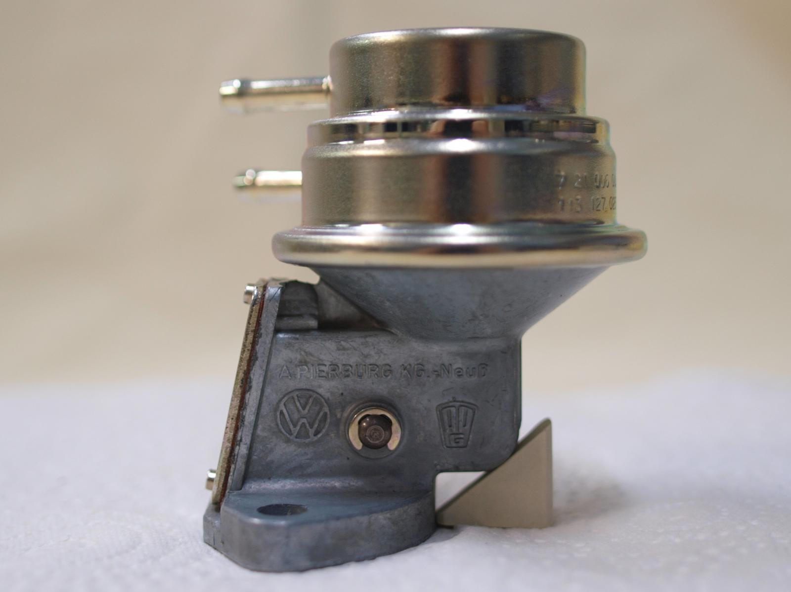

There cannot be much clearance (if any) with the alternator.
Here are three genuine VW fuel pumps which I have, one for a generator equiped engine (non-rebuildable pump), one for an alternator equiped engine (non-rebuildable pump) and a rebuildable fuel pump for a generator equiped engine.
I don't think a non-rebuildable fuel pump would have clearance with an alternator fitted because the top is a lot wider.

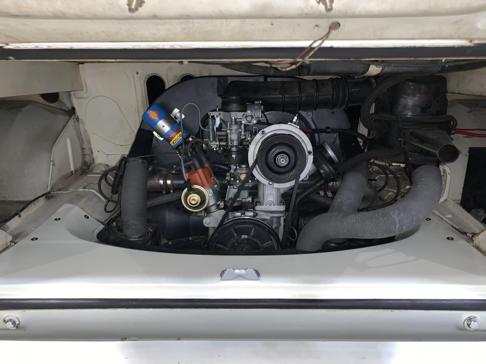

Tight. But mine comes right off on my set up.
I do believe this is the one I saw.
Is there a PN to differentiate?
