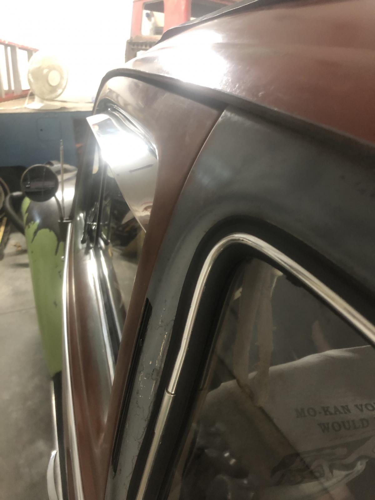

been doing some non-functional stuff for the first time in a while.
attached some window shades
added one of ghe grab bars i have
found this cover thing for the front hood latch. i didnt know it existed untill i randomly saw one in the classifieds. i wonder how many more of these things im missing.

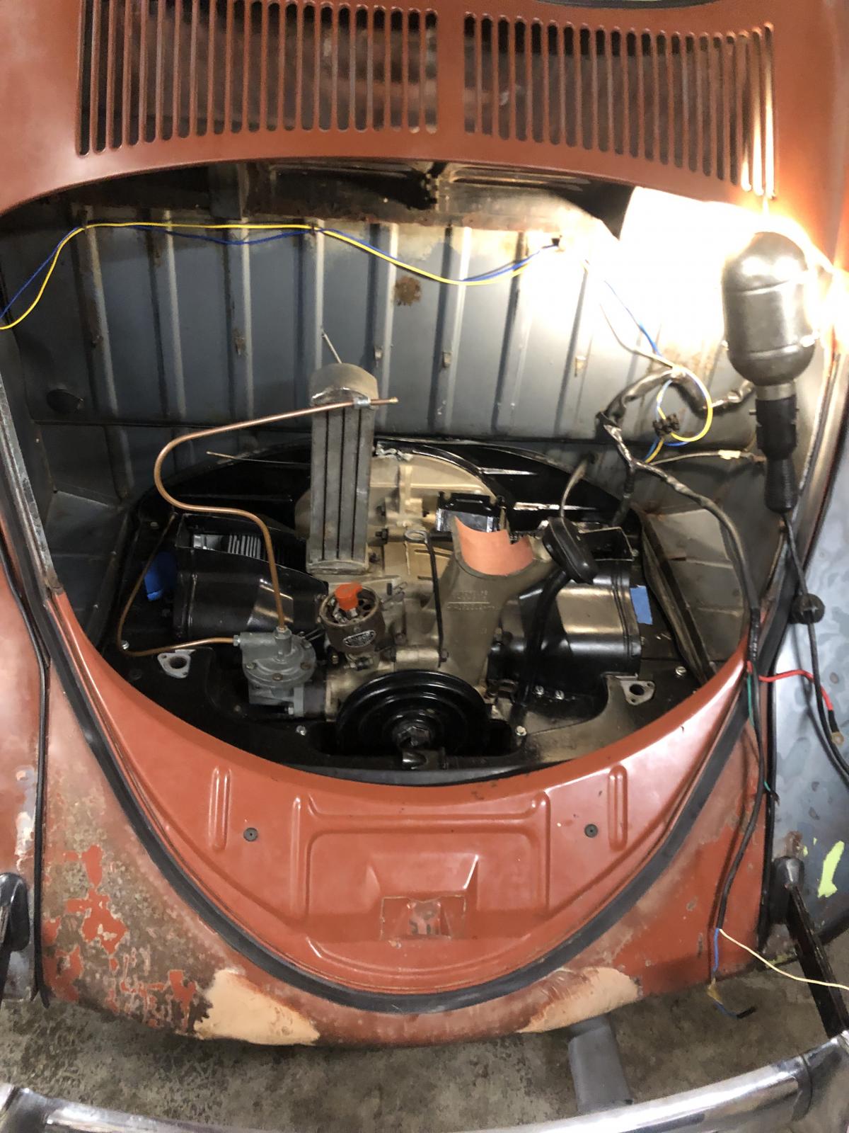

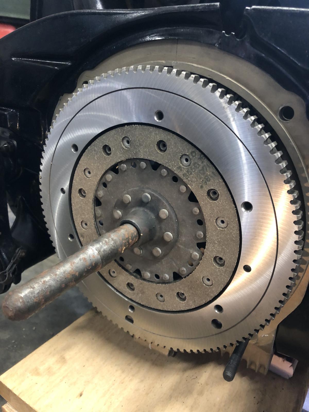

here are some more process photos:
replace thee heater tubes. the old ones were unspooling
motor
shameful placeholder generator/regulator.
clutch install
once i started trying to start the car i ran into some problems. the contacts on the cap and rotor were toast. i bought replacements.
the fuel tap leaked excessively. there is some sort of internal washer i cant figure out how to get to. i think i need a tool i dont have. i bought a replacement and shelved the one i had. in the mean time i rigged up a temp tank.
at this point i get the motor to fire. dumped a bunch of gas in the carb and set it off. it was great. it would take me like a month to get the thing to actually run.
i wasnt actually getting compression though. the intake manifold wasnt seated. so...tear it apart.

now... onto motor install.
in the spring of this year we were somewhere like this:
i had to backtrack a bit because i neglected to install the thermostat
my jack stands arent tall enough for the motor install so we got a bit precarious. jack it up and drop it. mocked up a motor and tested till we felt "cool". it never felt cool.
but it worked...
i love these two pictures of Yvonne. frustrated then victorious. i would not have completed this project without her help. she pushed me every time i got stuck, helped me every time i needed hands. listened to talk about vw minutiae for innumerable hours. shes the best.
and motor!

this circlip on the starter was one of the most frustrating things on the whole project. what. a. pain.
hooked a generator up to the battery to test. work fine. i dont have the one tht would be correct for the car. ill pick one up eventually. this one is from a 1960 i think.

installed the fuel tank (i have the motor in at this point but ill talk about motor install in its own post). put some gas in it and had a flood. ran new fuel line.
