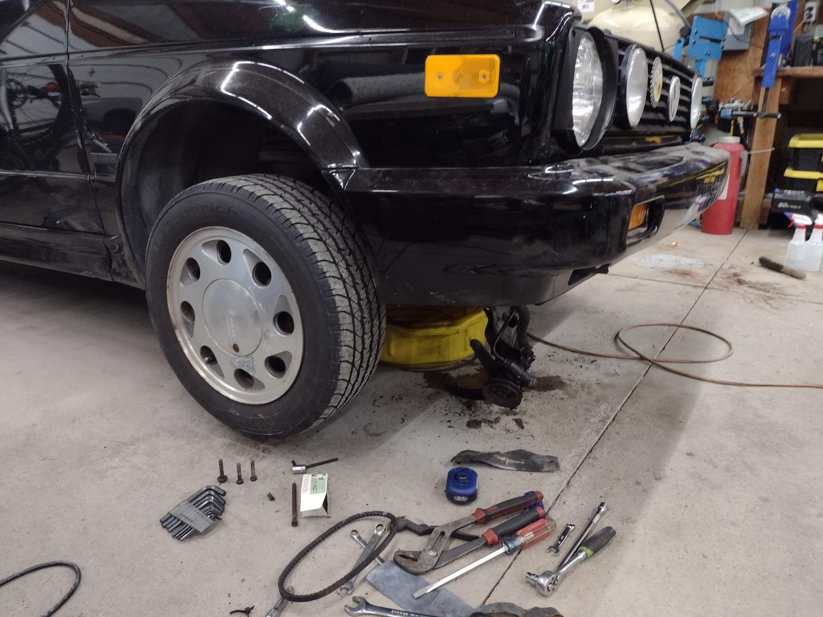

The front struts, and one of my front wheel bearings, were completely shot and it was much more cost effective to get a set of four adjustable struts for some reason so here we go...
I've gotten the front done so far. While I was in there I replaced, on both sides:
    wheel bearings
    hubs
    strut tower bearings
    control arms
    rubber bushings for the control arms
    rubber bushings for the stabilizer bar
    complete axles with cv joints
With an automatic transmission the driver's side control arm bolt is trapped by the transmission.
So the transmission and engine need to be raised a little bit with a floor jack to clear a path for the bolt.
The rear transaxle mount to the floor loses a nut.
The front engine mount to the bumper loses two bolts.
And the whole driver's side transaxle mount comes off the transaxle and the car.
The bolt is free.
You don't have to do any of that to replace the struts, just the control arm on a automatic car.
And the wheelwell is cleeeeeaaan. (metaphorically speaking)
Nobody in town had a shop press in stock so here I am hobbling together some jig with angle iron on my bench vice in order to pound out the old bearing with the Thor Hammer. The old bearing is destroyed upon removal, per Bentley.
The new bearing got pressed into the carrier with a ball-joint press/air impact gun and then pounded onto the new hub on the vice with the Thor Hammer (being careful to only persuade the outer race into the carrier, and the inner race onto the hub).
Here's everything in place.
And with the old brakes (still with much life, somebody has been in here before)
These adjustable struts do not have a bump for the cam to ride on, although there is room for camber movement in the hole, so setting the camber will be an adventure.
The struts came with these wrenches and they can be adjusted while the strut is still on the car, which is nice. Very Happy
I just guessed at a level for the adjustment and got lucky first try. I like the stance and nothing rubs! Cool
The car drives great, as far as front suspension is concerned! Tracks pretty straight for not yet getting the alignment, which it needs now.

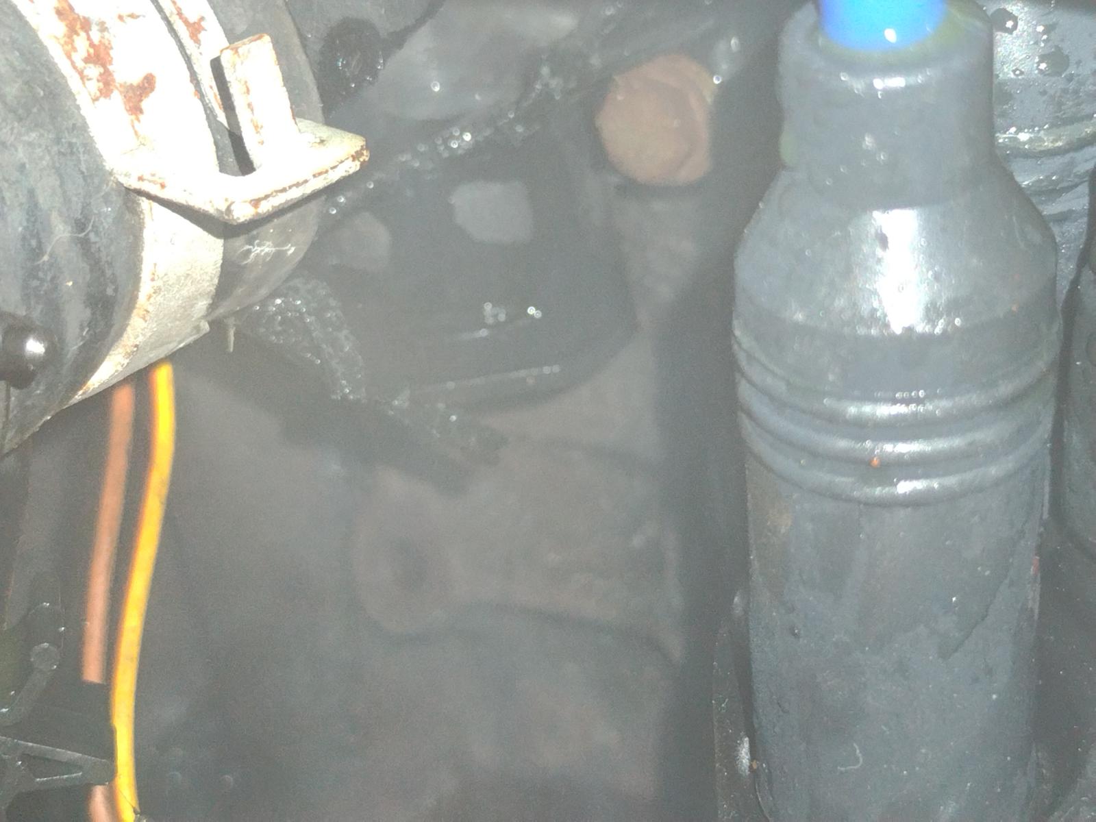

The bracket or tab on the front of the block that the bolt would screw into is broken and the bolt is missing for that reason. From the grunge on the face of the break it looks to have been gone for quite some time. From where I was, I could not see if it's an integral part of the block itself, or a bracket that is mounted to the block. The outer half of the ring with the threads through it is cracked off, leaving the inner portion of the circle, still with remnants of the threads. Here are some useless pictures pointing generally to the missing tab, which isn't visable both because of poor lighting, and because it's missing.
Eh?
I'll revisit that area when I have everything off to replace the timing belt at some point. Until then I just buttoned it up without that bolt.

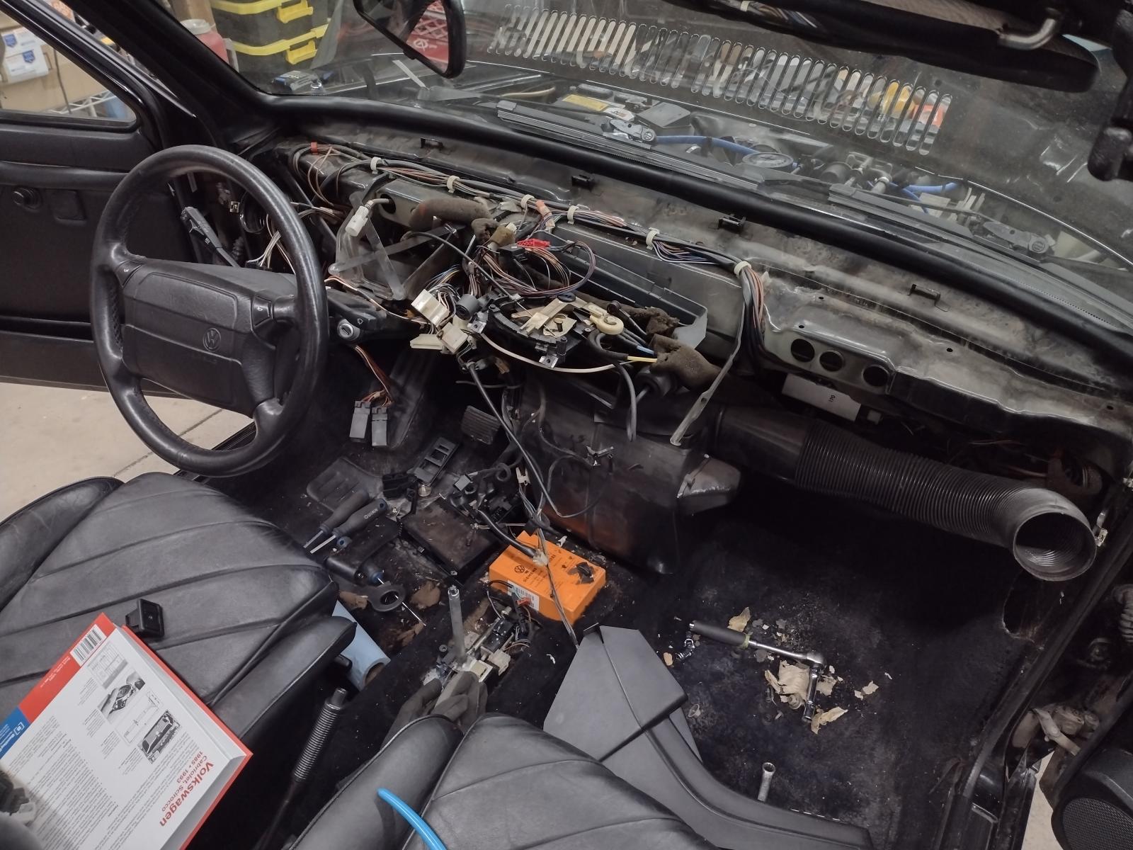

Almost there! This dash is tedious business. It's given an opportunity to handle some miscellaneous nonsense though.
In playing with the heater controls I noticed that the little mechanism for the AC had slipped out of its groove some long time ago, judging by all the dust in it. I cleaned it up, lubed it and put it back where it belonged, flexing the metal controls back in place with some pliers so it would all stay together as designed. I wonder how much head scratching went on before they gave up and just lived without the AC?
Replaced the melted defrost switch and added a missing delete panel to close up a hole.
Here she stands tonight, waiting for me to return the glove box door and knee pad panel.
If anyone is out there and knows... I'm wondering what these wires are for in the shifter box? My guess is seat belt alarms? They were loose like this so someone disconnected them at some point.

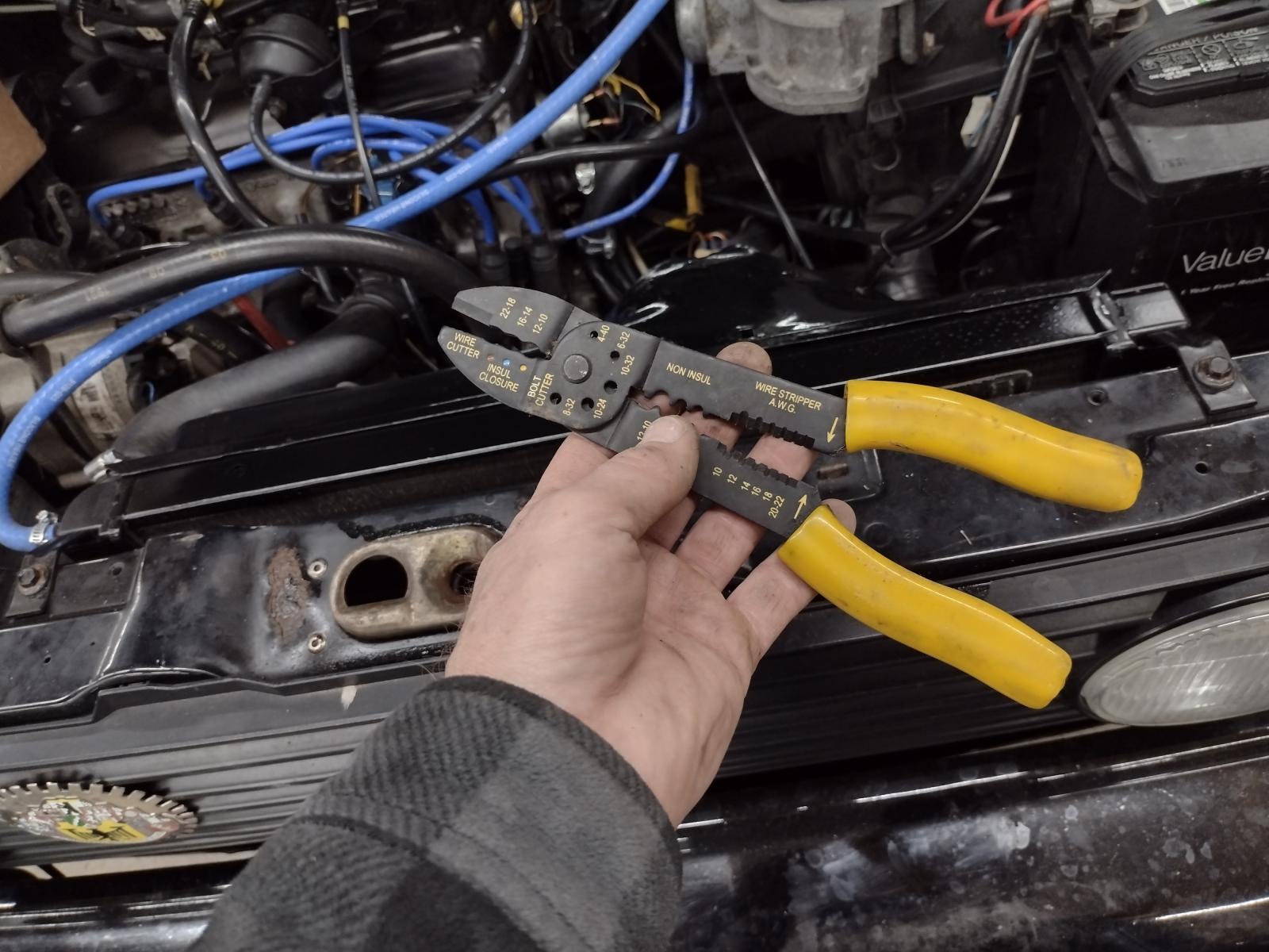

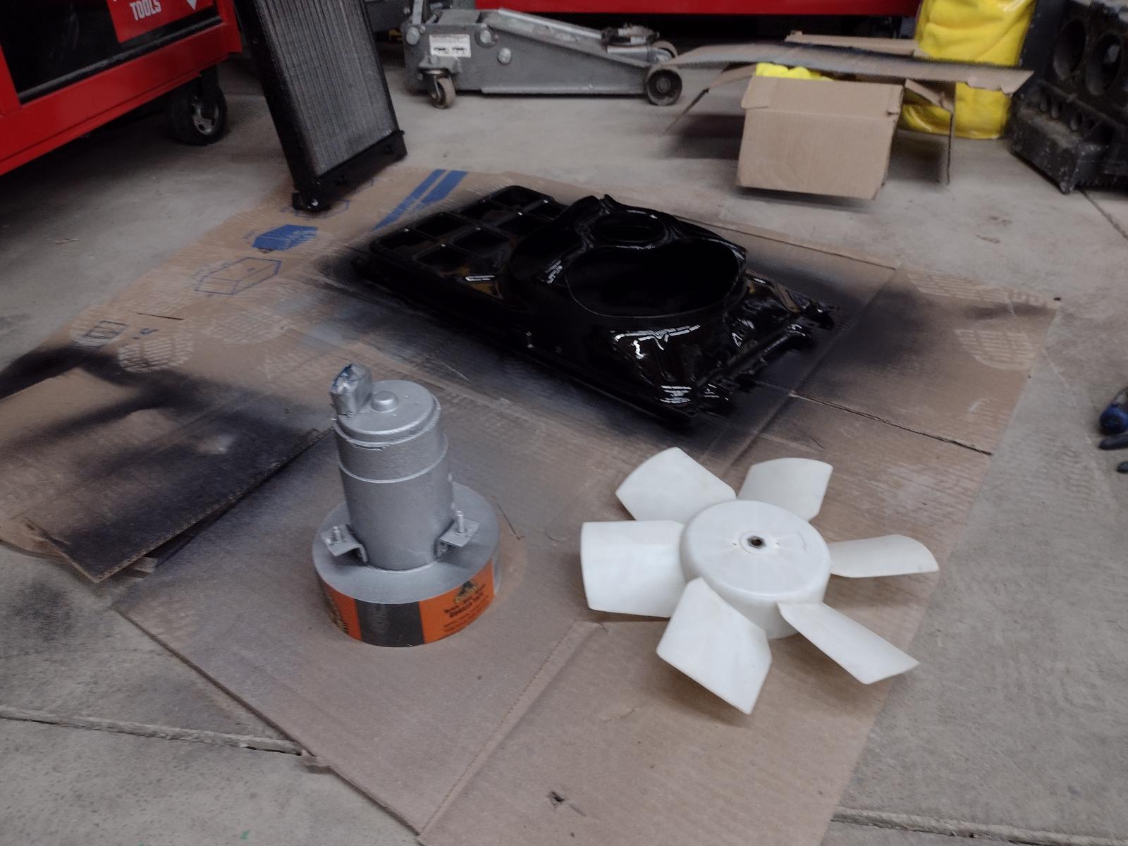

Hey thanks for checking in brother. It really was a steal wasn't it? Here on the North coast of Ohio they are all a rotted out mess. Not this one though! Should make a fun driver.

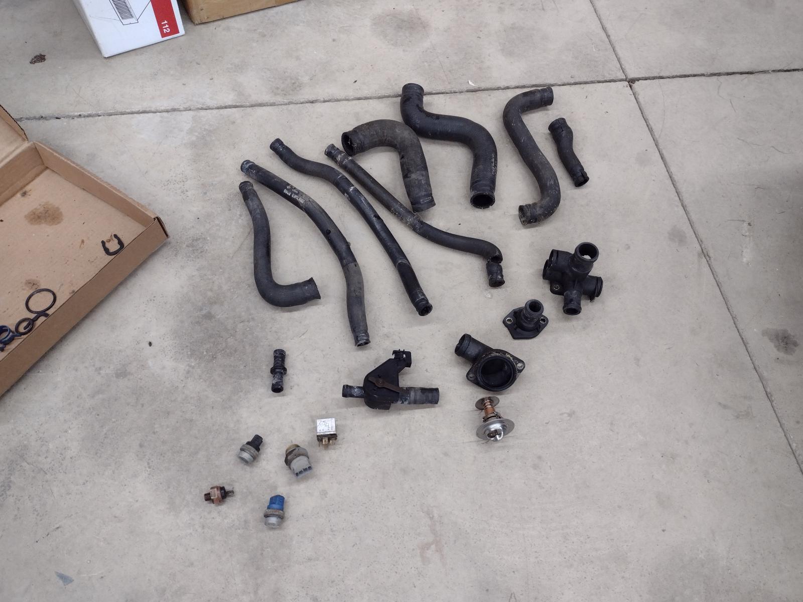

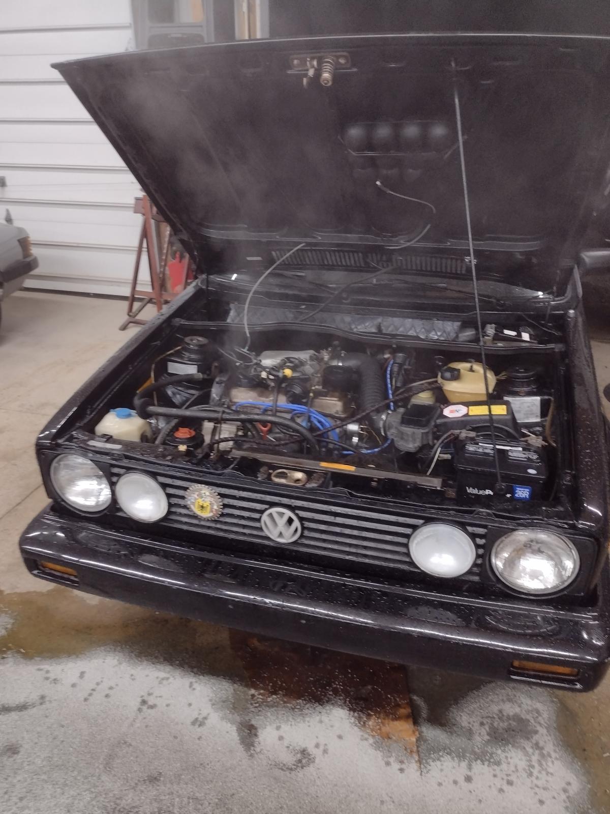

I had to drop the power steering pump to gain access to the lower hoses and thermostat.
The decision to methodically replace everything has been a good one. Here the thermostat was stuck in the open position. (Dig the forced perspective of this picture that makes the old one look as big as the bass I caught this summer.)
While the hoses were off I pulled the radiator and gave the fan shroud and the fan motor a quick dusting of rattle can.
Again, moderate diligence was rewarded with a new set of wire clippers, which the PO Gnomes thoughtfully left for me in the bottom of the fan shroud. (Really though, wtf. Some people are disturbingly lazy).
At this point I have reached a milestone. I have replaced very rubber hose, plastic fitting, valve and connector, as well as every thermo-triggered switch and relay in the entire cooling system. Here is a pile of old parts about to get the send off to future generations of archeology. (I forgot to stage the old heater core for this pic but you saw the new one go in so that should be enough)(also missing from this pic is the number 18 relay from the fuse panel, that one was bad and helps run the hot engine-off fan function that runs the fan for 15 minutes after the key is off, if the compartment is hot, avoiding vapor lock on the next re-start. Bentley had a procedure that helped me diagnose that).

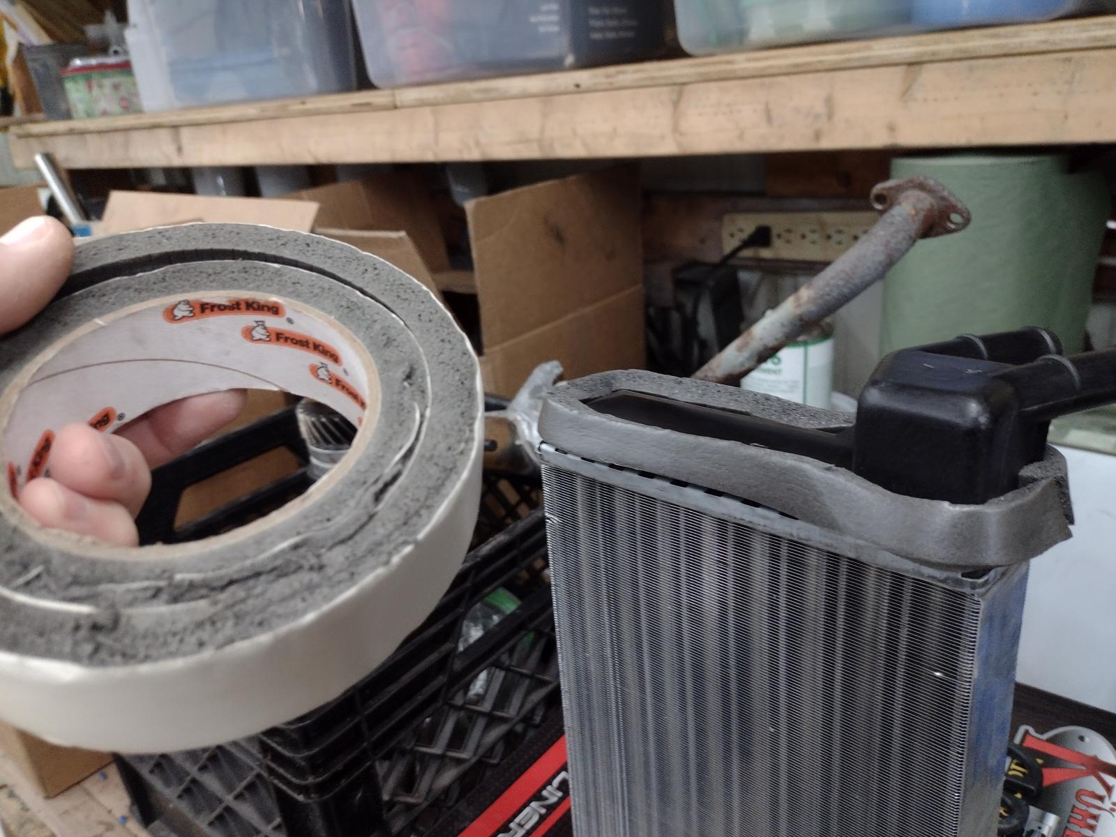

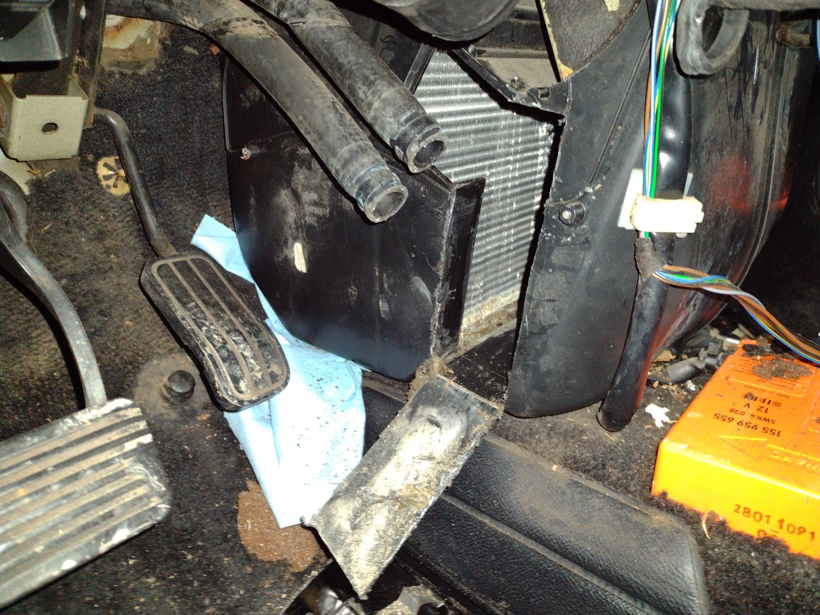

This is the moment at the crossroads. Teetering on the edge of regretting my impulsive habits, foray into the world of H2O cooled MK1, and addiction to Craigslist, I'm staring at a dashless mess and I'm not even halfway to retrieving the heater core that is made partly out of degrading plastic, and partly out of unobtanium.
Here is the new one, which cost me One Hundred and Sixty US Dollars ($160.00). I was glad to pay it. "Out-of-stock" seems to be part of the specs for a MK1 heater core when your car has air conditioning. By comparison, the non-AC heater core is sixty bucks shipped everywhere you look. Because you will never have one of your own, this is what the new AC equipped heater core looks like.
Whereas Bentley teases of a core that slides right out of the box on "some models", mine looks like this - trapped in a sealed box:
Which is why I tore my dash apart, in a quest to ultimately remove the huge plastic box that houses the heater core. It's a big clamshell centered squarely in the center mass of the dash like my grandma's sausage stuffing secured in the heart of a Thanksgiving Turkey.
Having surrendered to my nature, and newfound journey, I committed one hundred percent to finding the remaining inaccessible screws that would release the box.
Then I saw this.
That's the airconditioner, which is also in the box. I am absolutely not ready to unpack that box of worms. So I quit for the day.
I returned after an evening of some very promising research on VWVortex forums. Over there, I saw someone cut two slits in the side of the box with a hacksaw blade. Brilliant. Two minutes later, the old heater core was out.
I put some foam window insulation on the ends of the new core to seal airflow and avoid rattles (I've used this successfully around Type 1 oil coolers on multiple engines).
Then I slid it into place and returned a little removable panel to its home.
Once the new rubber hoses were attached, I screwed on the hose cover, which held the makeshift hatch in the closed position against the foam, sealing it up.
On a related matter, one of the heater hoses has a plastic connector that can't be found (at least by me) so, at the suggestion of my new MK1 friends stopped by the hardware store for a brass garden hose repair kit. Here's a side-by-side of old and new.

https://www.pexsuperstore.com/product/1-2-pex-coupling-splice-crimp-brass-fittings/
I'm not certain if it's 1/2" but you have two heater hoses that attached to the two heater core hoses. One hose attaches to the heater valve and the other one is attaches to a splice [similar to the one above]. The newer VW's used a plastic fitting and the older ones were steel.
Like all materials, they eventually fail. Plastic or steel, they both last a certain amount of time and then expire. Most, if not all the plastic pieces under the hood have last 30+ years so they are past their expiration date. When one fails, it's best to replace all of them.

Butcher wrote:
Do not forget about the plastic coolant housings located at the back of the head as well as the one between #3-4 cylinders. The thermostat housing would be wise to replace also. There is a fitting between the heater hoses that you should replaced. If you go to the hardware store, a pex pipe slice works really well. Made of brass and has the perfect diameter to splice the hose. I believe VW used plastic in your model.
Do as you wish, but if you do not replace most/if not all of the coolant components, you will be chasing coolant leaks for a while. Do it once saves you a lot of time and money. It also gives you the confidence that you will get home.
If I did not mention it, stay away from Meyle and URO parts. They rarely last long especially the plastic/electrical ones.
I do appreciate the tips. I have ordered a couple more tid bits to round out the update as long as the system is apart. The PEX splice is a handy hack as that piece is not readily popping up in the search.

Butcher
Joined: December 05, 2015
Posts: 1282
Location: Right Here
Butcher is offline
PostPosted: Sat Oct 30, 2021 7:07 am    Post subject: Re: Buggeee's Topless Bunny Reply with quote

Well, it seems the earlier comment from our ranks about going through the brake system (which is due to the fact that rubber deteriorates even while a car is sitting), applies equally to the cooling system on these water-cooled servants.
Idling the car while chasing down vaccum leaks, and replacing little cloth braided hoses throughout the engine bay, let me witness a crack, and utter failure, of what I now know to be called a coolant hose flange.
So, while the air-cooled Beetle may have less convenient spark plug access, it never sprays green piss all over my shop.
I'm assuming that it was a stuck thermostat, but honestly can't say I remember hearing the electric fan running at the moment of failure.
Anyway, a thermostat, plastic fittings and rubber hoses are on their way in trucks that will excite the dogs in a few days. Then I can restart the car and cycle the fan to see if the sensors and relays or whatnot are functioning.
In the meantime, she's being rolled outside to make room for other meditations while we wait for parts.. She has a place in the barn for the winter but for a few days she'll be just fine under a spare Beetle car cover. For those that didn't know they were curious, like myself, it turns out that a Beetle car cover fits a Rabbit pretty decently.
All said, my experiences with this little car so far reflect the charmed nature of some VWs. This one has started when needed, run only long enough to accomplish the task at hand, and suffered catastrophic failure in the safety of the driveway. Some Beetles have been like that, and I have loved them for it. Timing is everything. Very Happy
