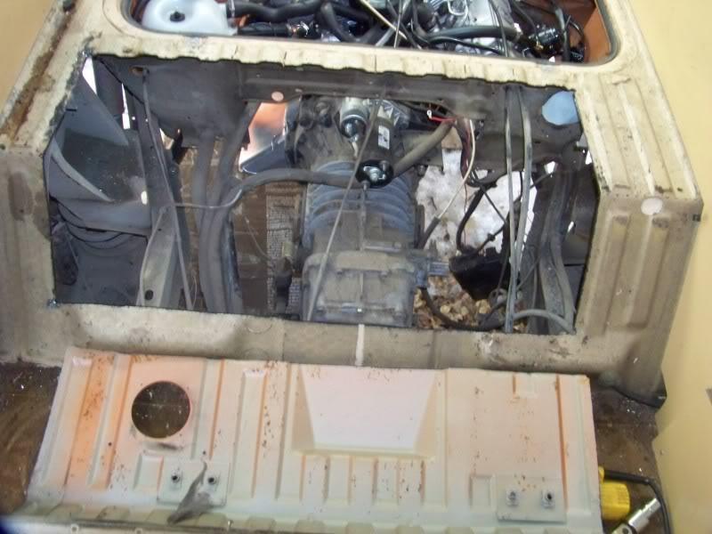

For going back in, would it make any sense opening up the firewall and doing it from inside? Flanges could be welded to the cutout so screws or bolts for closing.
I know my opening isn't big enough, but it sure has made slave cylinder, starter motor and other stuff a super amount easier. Plus the insulation wouldn't get trashed.

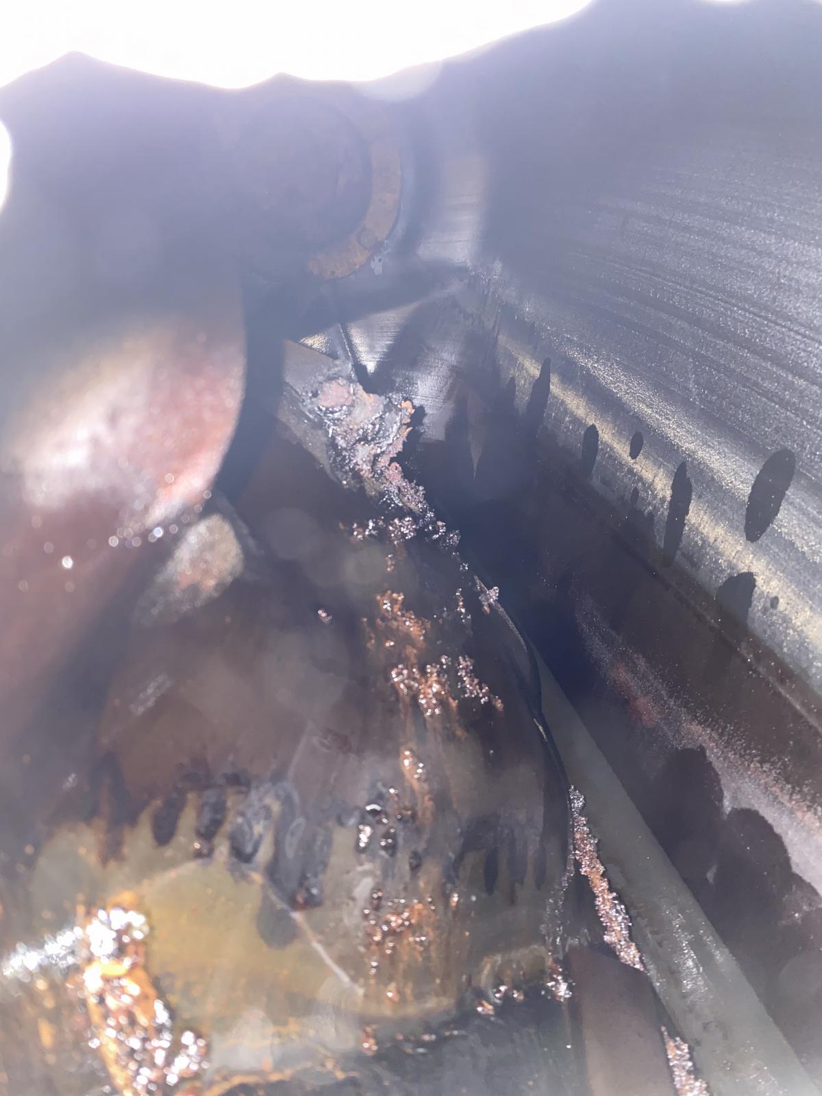

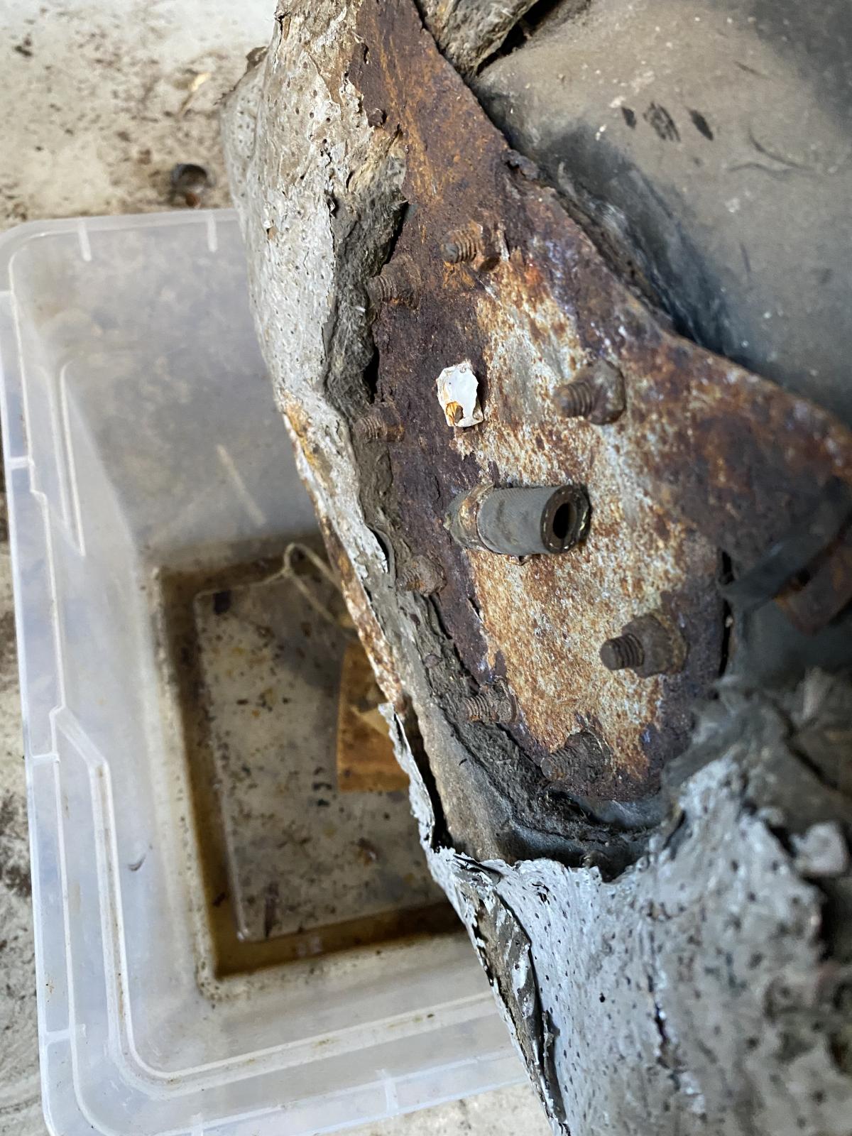

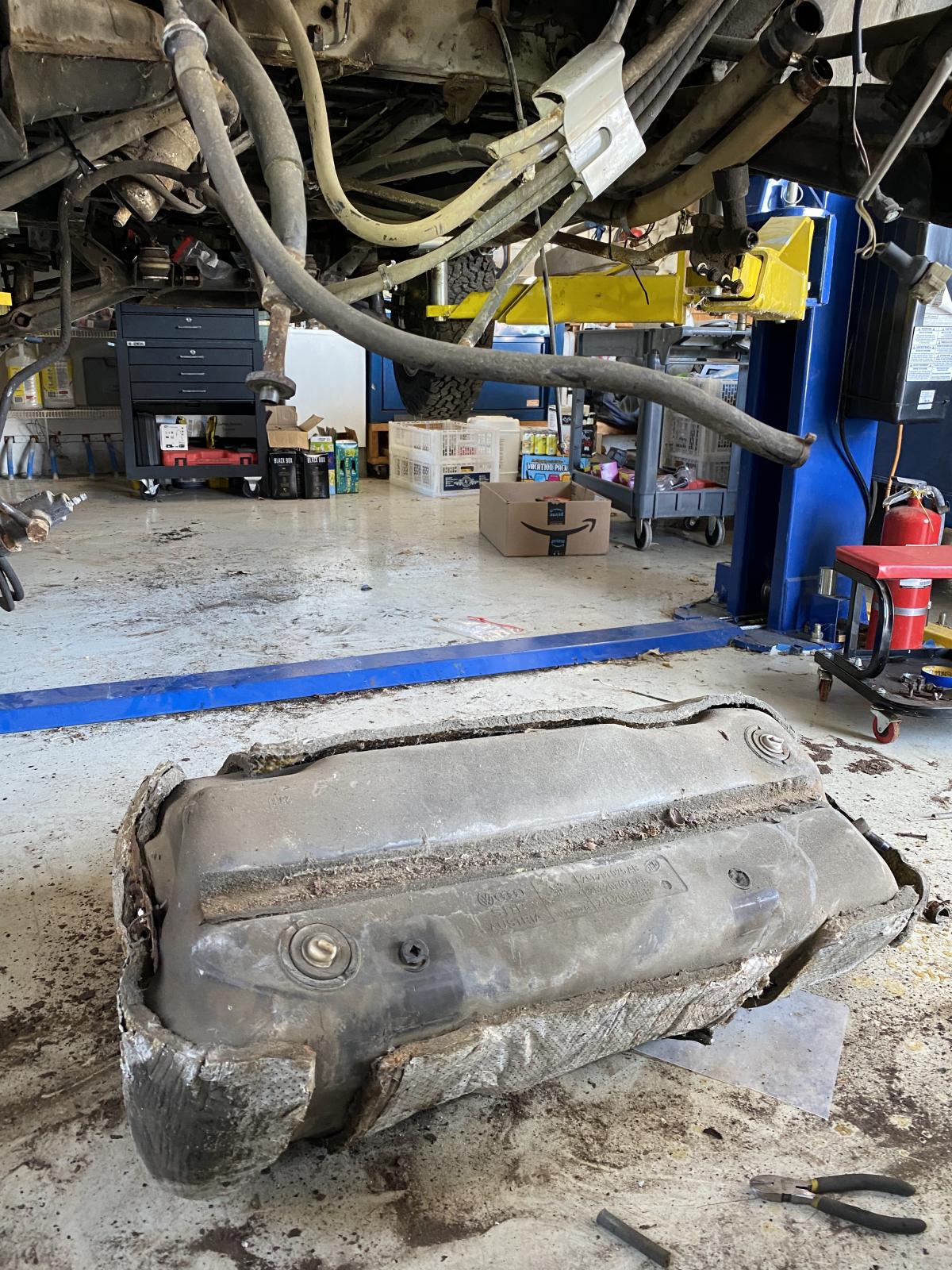

Victory is mine!
And I’ll add this job to my short list of things I never want to do again…
In the end I used a thin plastic cutting board between the left rear side of the tank and frame member. That helps the insulation not get hung up. I went to a longer piece of fence post. And I had to go stud by stud on the sender to deform the tank inward so they could pass that frame member. It took about 30 minutes to git er dun.
Inside that fuel tank is a total mess of who knows what.
Only a thick tarry substance tries to come out of the drain.
And what idiot engineer speced such long studs here? When I replace the tank I will cut down those studs flush with the nuts. All new of course.
Thank you everyone for your encouragement.
