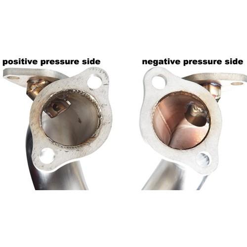

SGKent wrote:
you need to slow the exhaust gasses and diffuse them to break up the pulse. That will cost HP. Aim the tailpipe so the sound heads somewhere away from the bus and not back to it. If you aim it at the side of the road and some trooper is sitting there with a sound meter you'll find out quickly whether it is too loud. I've been there on two cars, one was a bus. The solution is usually a more restrictive muffler. If it is a baffle as you think, you can thuwump the muffler with your fist when the engine is off and you will hear it rattle. Air cooled engines don't have a water jacket to help deaden sounds so they are worst when it comes to noise. If you want to temp restrict it to see what that does, clamp a small can over the tail pipe with a hose clamp and drill a lot of holes to see how much quieter it gets when restricted. You can use a piece of tailpipe extension from NAPA to do the same kind of thing to temp aim it away and extend it to see if that helps. Not saying don't use cardboard but it gets really hot back there and i have accidentally smouldered cotton rags with exhaust gases out a tailpipe before.
Some shops put something like this in but it will be more restrictive. I don't know if there are different ones. This one is on Summit. I used one of these in a high performance sports car once to comply with a ticket but it did reduce performance.
I really don’t think it’s his exhaust, I run the same exact one on a much larger engine and it is very quite. I think he has something else going on. Like a R&P that whining or a bad rear wheel bearing.

I see, but my point was they could be leaking but I haven't seen any indications of a leak. I'll study it more tomorrow.

That’s how they should be. You were supposed to drill out the ones on the Bug Pack headed. So the heat riser wasn’t working at all for you before, now it’s working as it should.

Could I be getting blow by from the heat risers? This is something those with dual carbs don't have. It appears the VS risers feed directly in to the exhaust gasses flow, my old BugPack header has risers but they are not open to the exhaust gasses.
