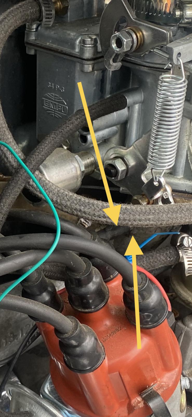

That port you have the reduction valve vacuum line attached to is manifold vacuum, I guess if it works it works but it will be unstable as you are accelerating due to the car's throttle plate opening at various degrees, and won't give as good a signal when you are going to shift. The reason VW used ported vacuum (as I understand it) is that it is above the throttle plate, and much more stable at idle, which is basically what is happening when you take your foot off the gas to shift-- you get up to speed to where you want to shift, take your foot off the gas, engine briefly drops to idle speed and throttle plate in the carb closes, so when you shift the supplied vacuum signal is very stable and can pull the servo rod much better.
EDIT: I'm editing the part of this post where I said try branching off the vacuum line to the control valve with a tee-fitting. That may work OK on a 30 PICT but on your 34 PICT-3 it will most likely cause very harsh shifts.
Instead, if you can, try drilling out that upper right side rear facing port on your carburetor through to the upper venturi area, and then buy a small brass tube from the local hardware store and loctite it in there. Then run the vacuum line from there over to the control valve.

Hi SB!
Thanks for the reply.

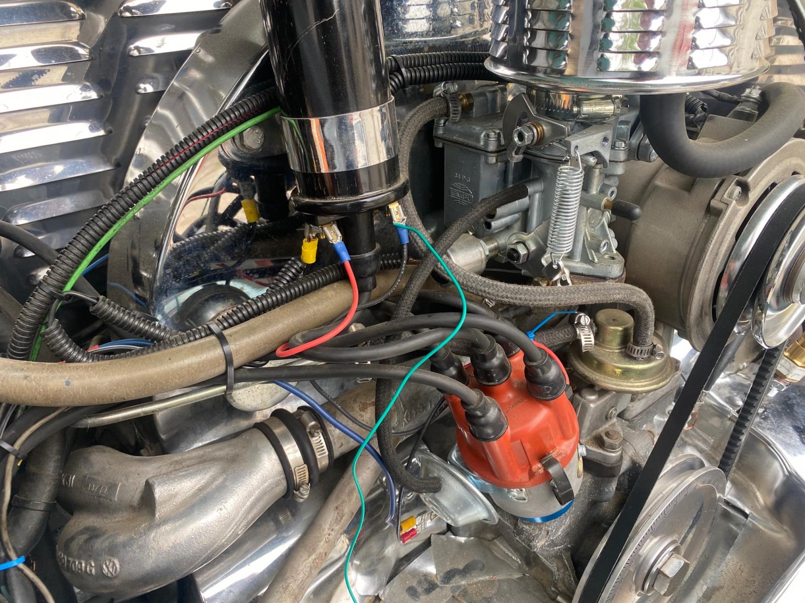

- the small vacuum line from the control valve is going to a small nipple coming out of the base underneath the carb. I tried to zoom in on the pic below and point it out with the yellow arrows.
- the carb, distributor (correct: flame thrower) and coil all came from PO, which claims this was how he had it running. When I installed the engine back in, I found a local VW mechanic who came recommended by several VW enthusiasts on a local VW Facebook group here in Dallas Fort Worth area. I’ve timed engines before but only on older Chevy sbc 350s. Since it was my first time working on this particular engine I just paid him to time it for me. Not sure exactly what procedure he followed. The engine idles perfect and had good acceleration and no back fires, so I assumed he had timed it correctly.
- I’ll take some close up pics tomorrow of the area between the alternator and accelerator pump linkage. Don’t think I’ve seen any thing rubbing in that section but will confirm tomorrow. Maybe that’s why he had a different carb on there to allow clearance for the alternator?

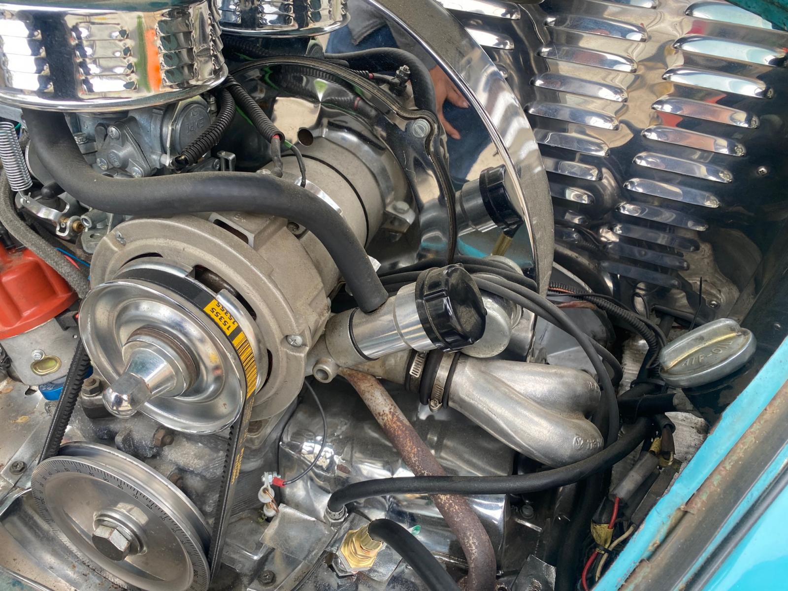

Something else I am noticing in that photo- you are running an alternator, the 68 originally would have come equipped with a smaller bodied generator. Are you sure your carburetor's accelerator pump linkage is clearing the alternator body? That would cause all sorts of acceleration issues.
A good read here:
ashman40 wrote:
The larger diameter area of the alternator body needs part of the stand to be cut back so it fits. The smaller diameter area is the same as the generator so the straight body of the generator will fit onto the alternator stand:
If your carb is from a '74 Beetle or is aftermarket it may already be set up for alternator use. The linkage for the accelerator pump was changed when VW switched to alternators. The carb spacer is designed to lift the carb up to avoid the generator carb's accelerator pump linkage from contacting the alternator body. This pic shows the alternator linkage (generator linkage is the dotted lines). And "no" they are not the same linkage just rotated 90-deg. If you have a carb with generator linkage you will need to source an alternator linkage (or a whole carb w/ the proper linkage).
Another option... grind the case of the alternator body to allow room for the generator linkage to move freely.

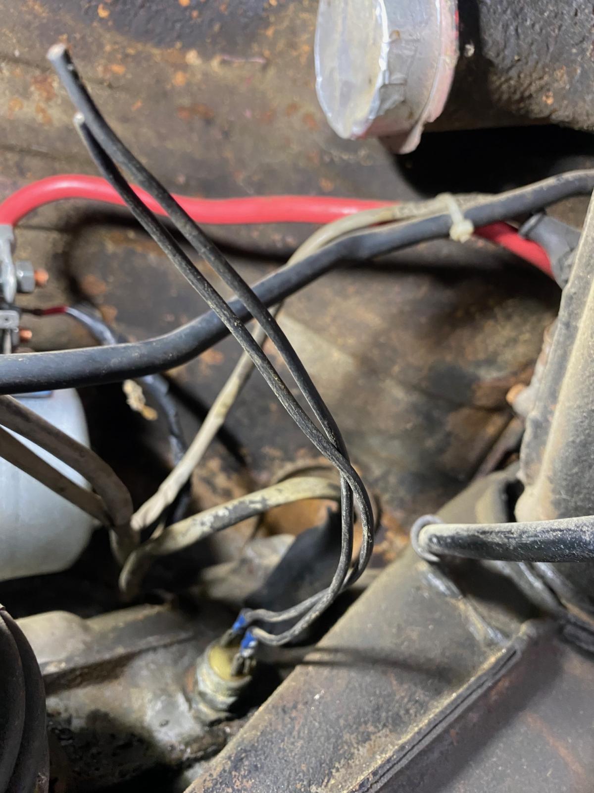

As Tom stated those two switches right close to each other on the bell housing are to monitor the ATF fluid temperature, one is for Drive 1 and one is for Drive 2:
The wire leads from those go to the 3-prong "temperature selector" switch (covered by a rubber boot in your photo) up at the front passenger side of the transmission. Then there is a 3rd wire coming off that temperature selector switch that goes up to the ATF warning light in your dash. As Tom said, not the cause of your problems.
dpin78 wrote:
That’s what I’m thinking too.
I wonder if the PO ordered a torque converter for a 1968 autostick and since the transmission is off a later model he got the wrong one. Not sure if the stall speeds or TC specs differ between years. I was able to bolt it right up but maybe something internally is different
The fact that you have TWO of those temperature switches at the bell housing and not just one proves you have an earlier (correct) autostick transmission. The later ones (I think around 72-up) went to a single temperature switch for Drive 1 since it was discovered that the ATF never overheated in Drive 2, and NO selector switch at the front of the transmission, the wire lead just went straight from that bell housing temperature switch straight to your ATF light in the dash. It wouldn't matter anyway as the torque converter was the same for all of them.
This switch with the two cut wires is your backup light switch! I'm guessing you don't have backup lights when you put the car in reverse at the moment. We can deal with that later.
I have a few concerns from what I am seeing in this photo:
Namely, you do not seem to have an autostick carburetor, which would have a second port on the rear side of it which supplies ported vacuum through a small vacuum line over to the small nipple on your control valve:
This is what supplies the vacuum to regulate the speed at which the clutch activates-- turning the reduction screw on the control valve will do absolutely nothing if this line is not hooked up. Since you don't have the proper port on the carb for it, is it teed off the other carb-to-distributor vacuum line somewhere? This would work but not ideal.
Also, I am assuming that is a Flamethrower distributor? I've never seen one clocked that far around with the vacuum canister facing the left side of the engine bay, I'd like to verify how that was timed.

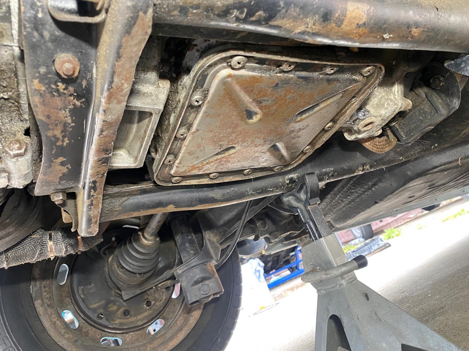

At this point I think the next step is to drop the engine and check the TC and clutch disc.

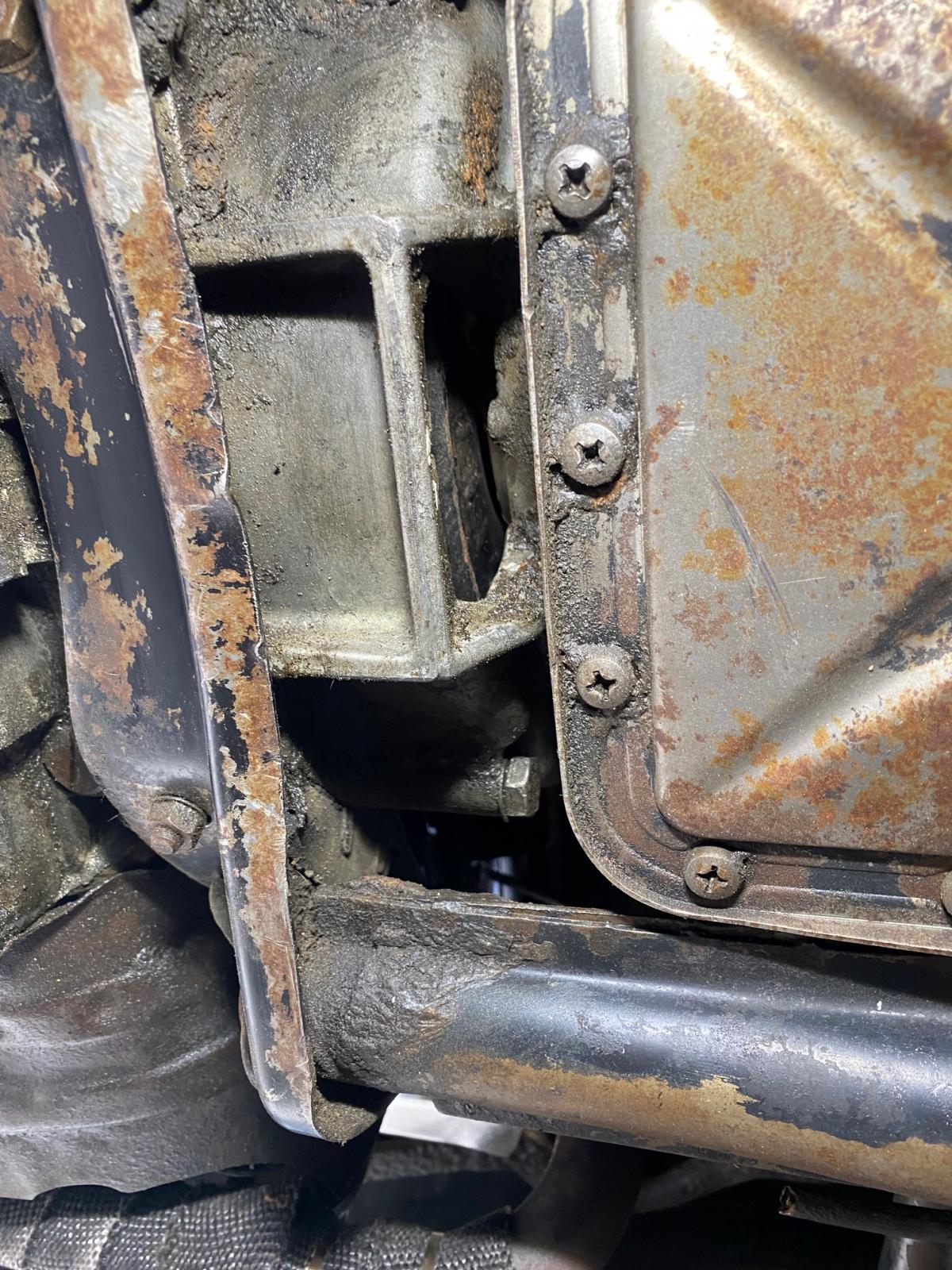

PostPosted: Thu Mar 30, 2023 11:47 am    Post subject: Re: 1968 Beetle Autostick - slow moving clutch servo Reply with quote
Later Autostick cars had a "Park" position, where as the first few years did not. If your transmission is not the original, maybe that sensor was for the later cars???

Some pics of engine bay and from underneath the car (just in case someone catches something I have wrong):

Also I found these two wires cut off an electrical connector. I hadn't seen them before since PO had tucked them in behind and I missed them. I don't think they're needed, since it was running good until last week.
I'm not too familiar with the transmission types and models for these years. I tried searching for a stamped number or code on it, but couldn't find anything (I'll keep looking its gotta be there). Could just be covered up with dirt. I wonder if this transmission off a newer year autostick, because I do remember seeing a wiring diagram for the autostick from 1968 and I don't recall seeing that electrical connector in the diagram... could be wrong.
