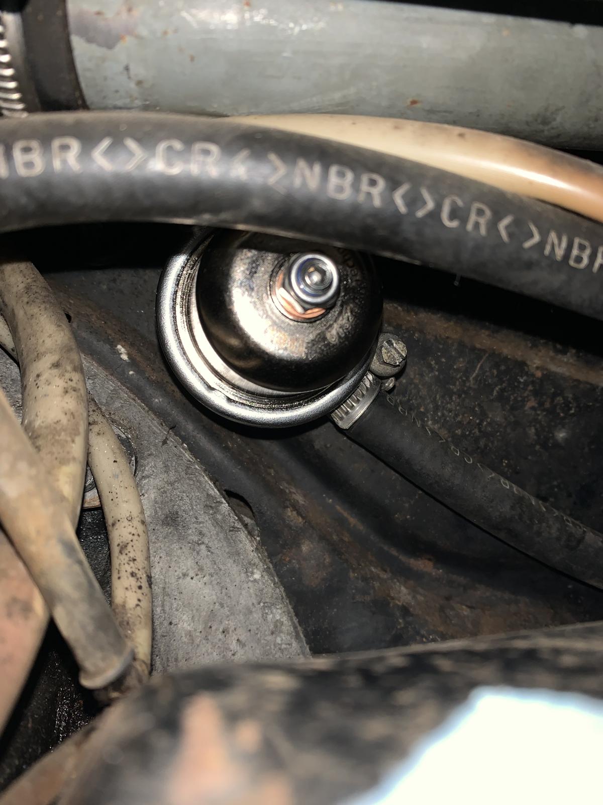

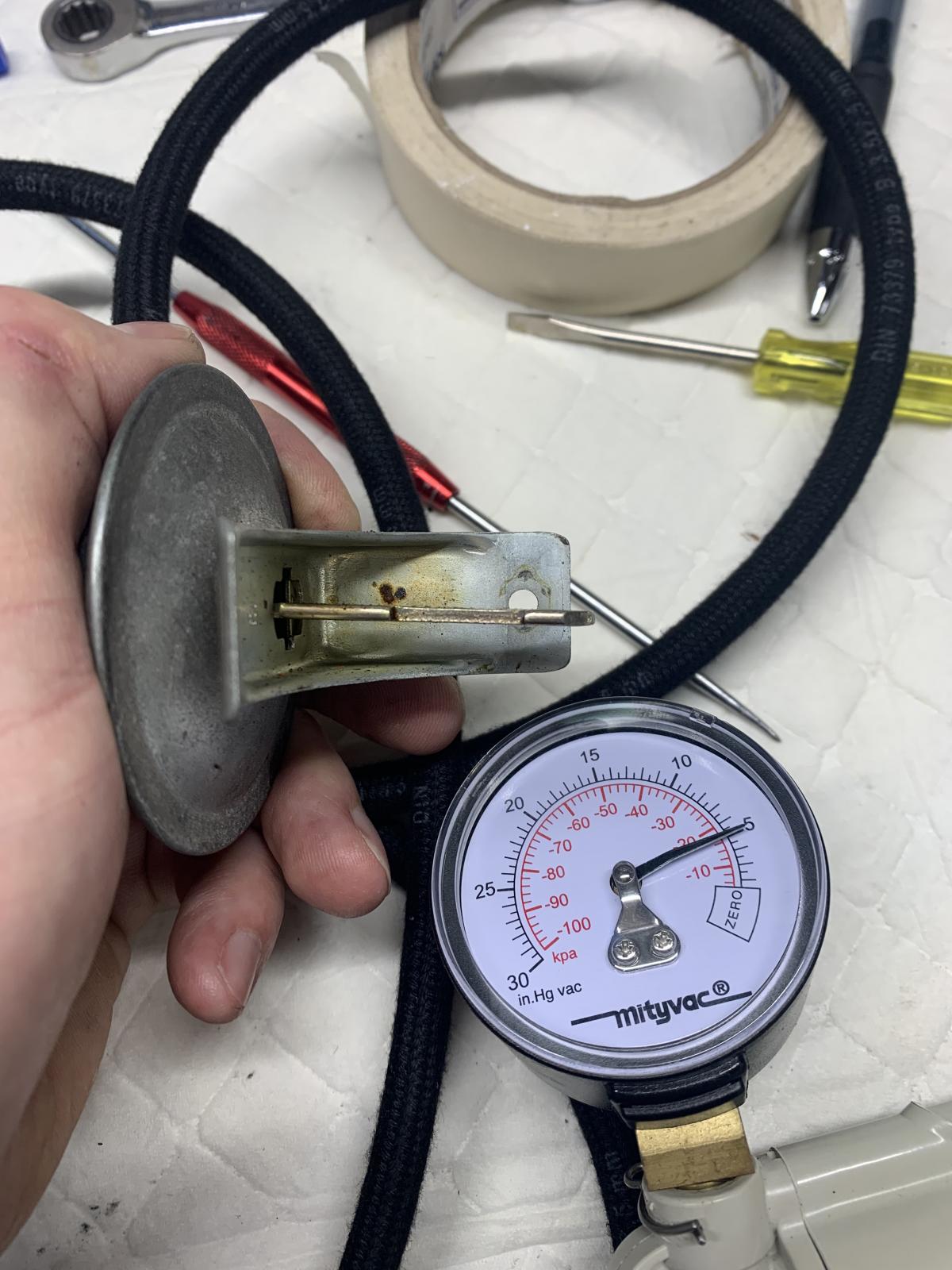

Today I've gone through distributor to make sure there is nothing funny going on. Overall was very clean inside and other than a small mark under the ball it's in good shape.
My injector breaker does have a bit of difference in resistance. 0.1 ohm on one side and .5 on the other
I ended up just cleaning and replacing grease
Vacuum canister lever does drop down under the vacuum but it looks very clean
I was able to give 5 degrees of advance but rpm seems to be wondering. Timing is still spot on though.
Now I am back to getting the stumble out off idle. Right now I am running sealed MPS. Was able to go get gas (20 mile round trip) and it drove pretty well. Although with few backfires when off idle, which sounds like a cracking whip.
