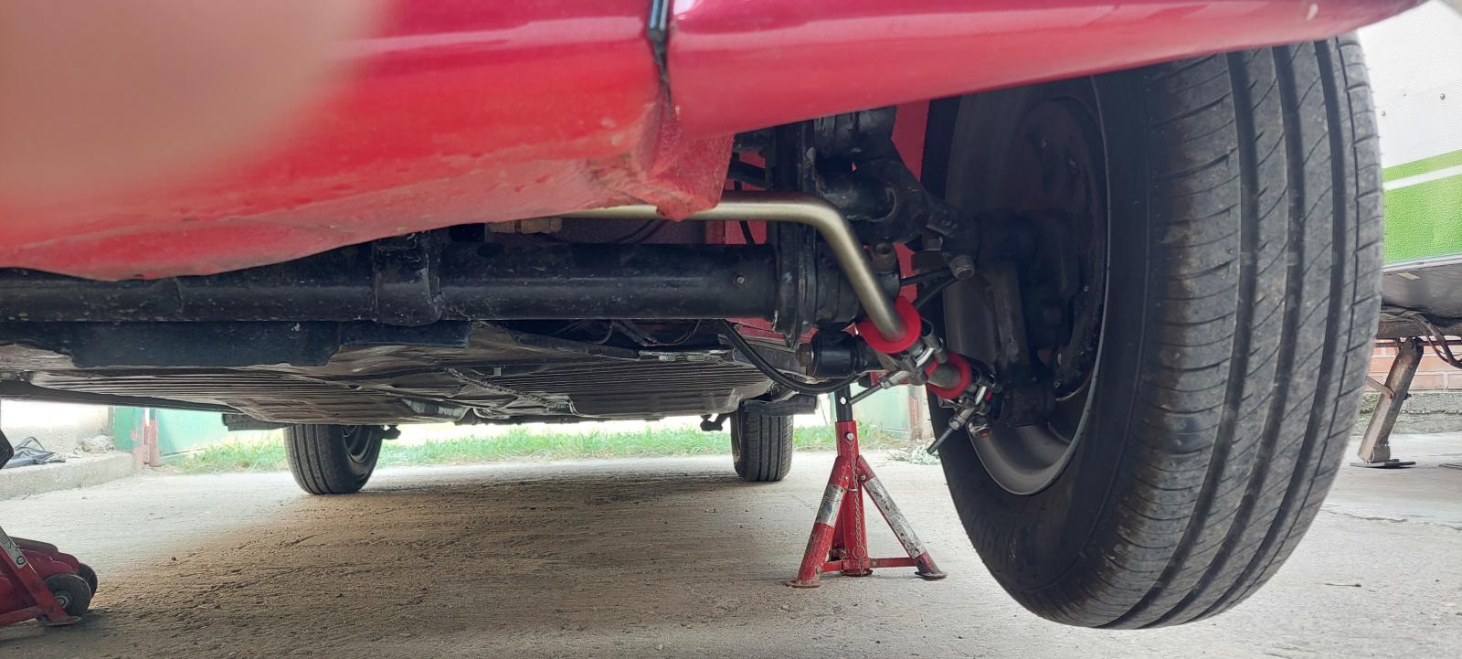

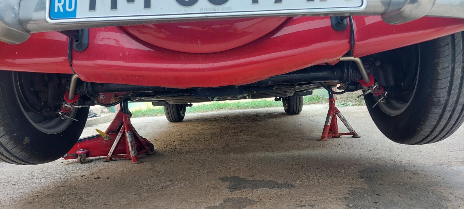

Gearbox, solved. Oil level was too low. It took about 750ml to top up. It's leaking some around the axle tube paper gaskets, but I think the issue was that some of the oil got into the tubes. Does it say in any manual to top up after first ride? I will keep it under supervision until I build the other one.
And I installed the front sway bar. Half an hour job using screw type clamps. I expected the ends would be located under the lower arms, it sits somehow below and on the side. When it's lowered on wheels, it fits better. Let's see how it sits now on the asphalt.
