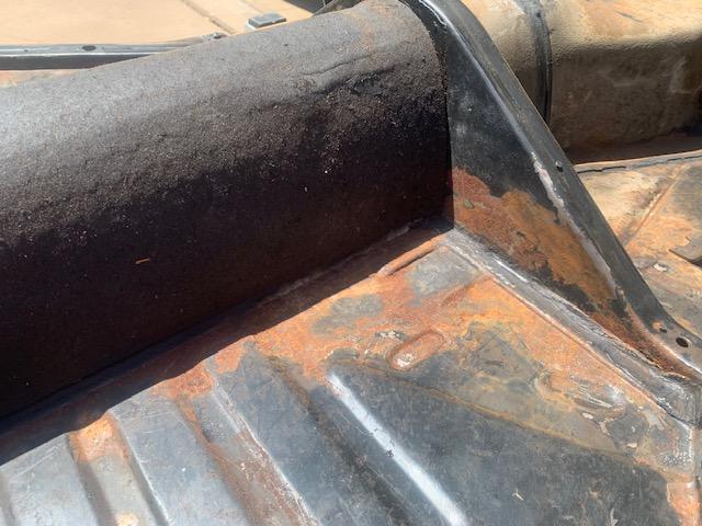

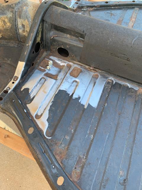

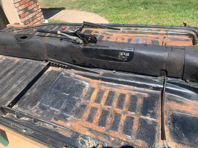

Pretty much done stripping the chassis.
Going to try to keep the original tar board on the tunnel and work around it. It's in great condition.
Started experimenting with Silicon Carbide grinding discs. They work very well, but I'll try wire wheeling in the hard to reach spots.
Not finding any rust through, and hoping it stays that way. Pray
Lookin' for a wheel stamped 5/66

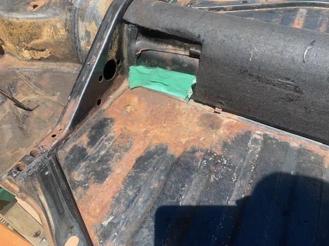

Body is finally mobile. Wonderful to be able to reposition as needed.
I've been stripping the chassis down bit by bit over they past couple of months as I have time. Front suspension is completely dismantled. Transaxle is next.
Had some time this afternoon and started on the muffler. Wire wheel wasn't getting the job done, so I switched to the angle grinder and an abrasive disc. That was more like it.
Under all that rust, I confirmed it was original.

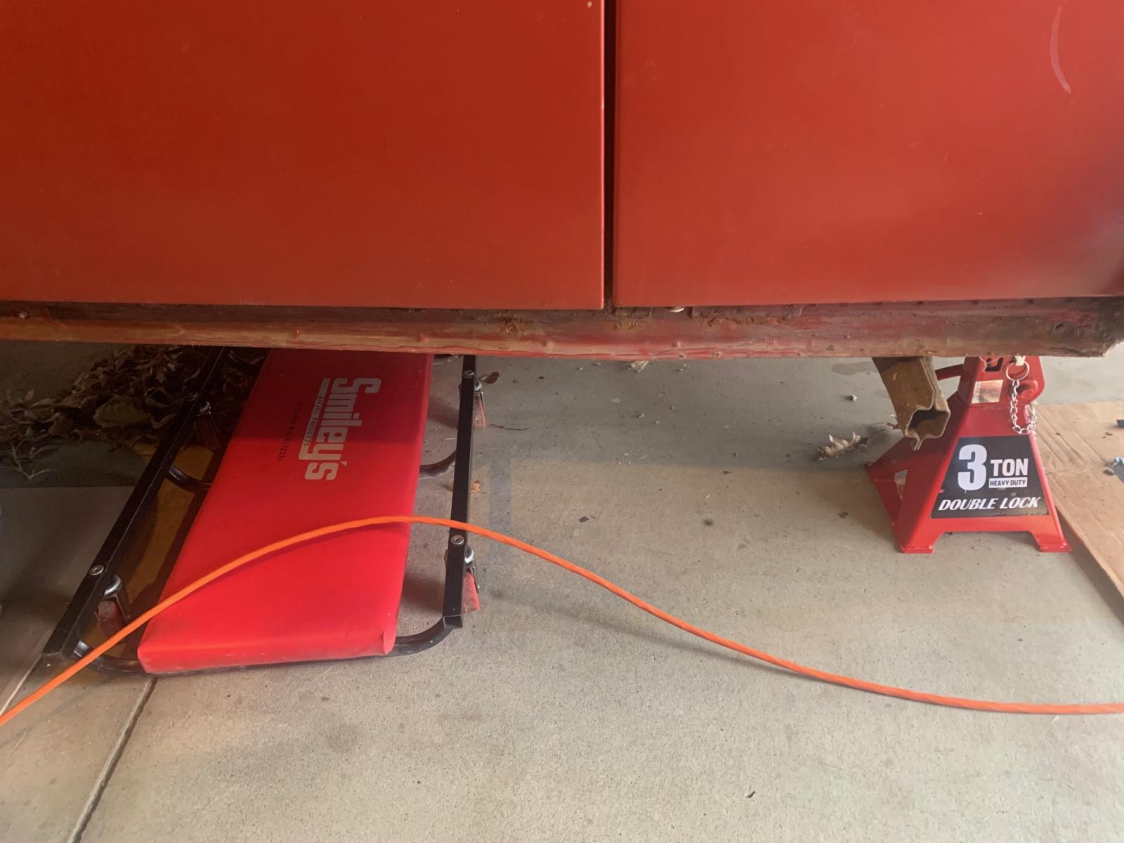

PostPosted: Fri Aug 23, 2024 9:47 pm    Post subject: Re: 1966 Ruby Red Sedan Restoration - Sat for 47 years Reply with quote
It seems I proved this can be done with one man and a hydraulic jack.
Completely knackered after the past two days, but feeling good about what's ahead.
Can't wait for autumn!

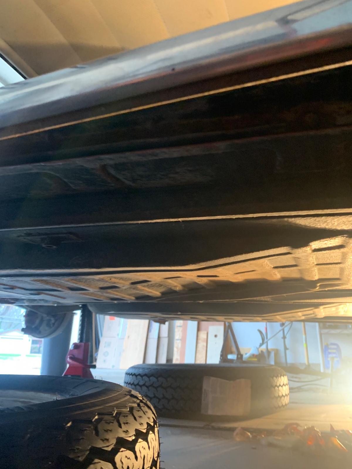

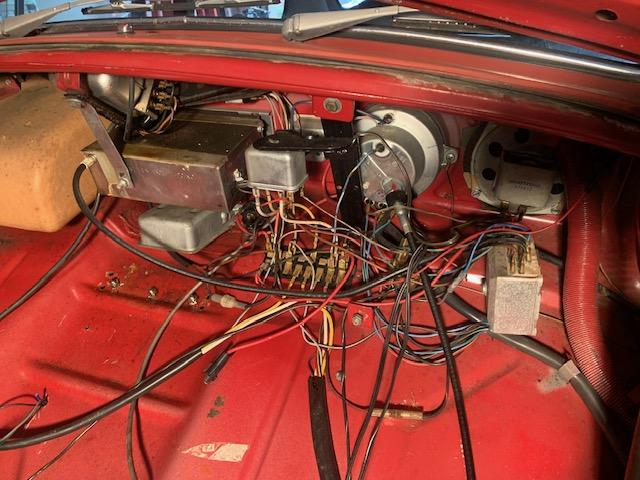

PostPosted: Tue Aug 13, 2024 11:14 am    Post subject: Re: 1966 Ruby Red Sedan Restoration - Sat for 47 years Reply with quote
Bit of break from the heat the other day prompted me to begin rooting around in the frunk, remove major body bolts, etc.
Can't tell you how grateful I am that the gentleman who bought the car new paid for undercoating.
I've even got the documentation from the dealer for how much was paid for the service: $25 bucks.
Notice the shiny black spot on the underside of the tank. I picked away some of the undercoat to reveal a beautiful rust-free surface. Inside looks great too.

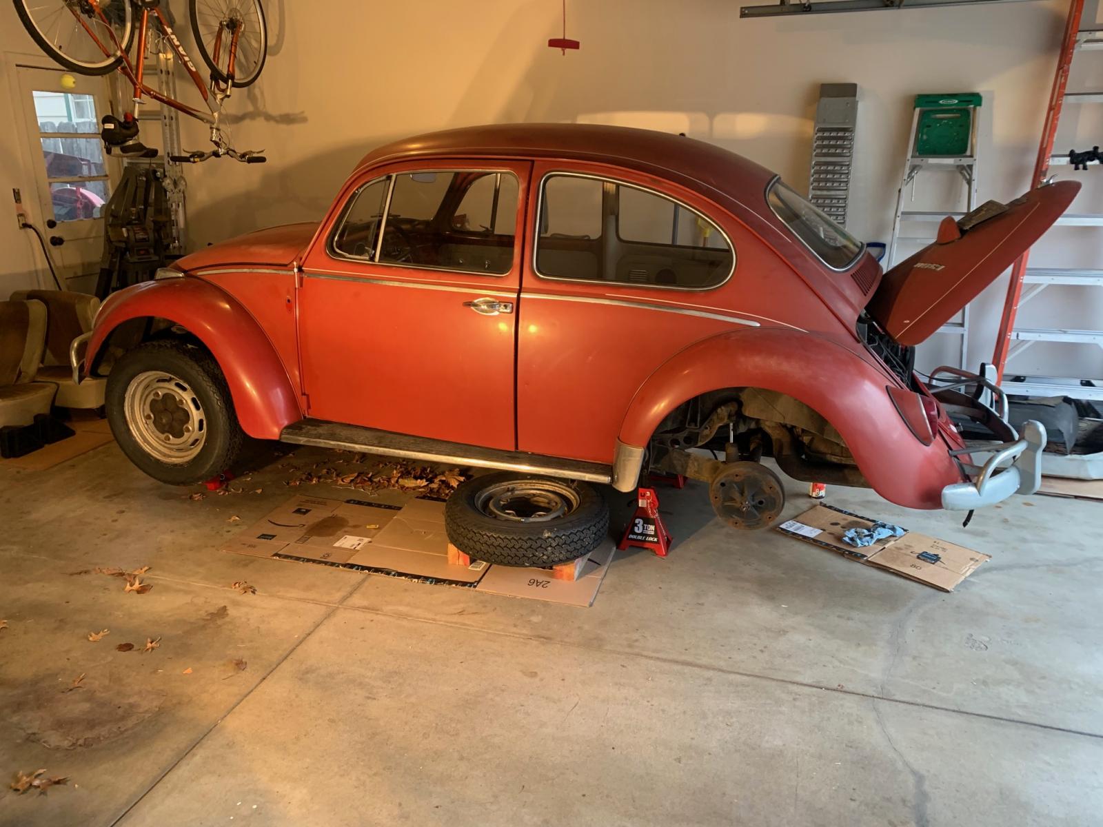

PostPosted: Thu Dec 14, 2023 5:05 pm    Post subject: Re: 1966 Ruby Red Sedan Restoration - Sat for 47 years Reply with quote
Finally got the bug on stands, dealt with the floor pan bulge (mostly), and got a real good look at the busted oil strainer stud, which is probably what led to it being parked back in the year of the bicentennial.
I plan to cut a groove in the stud, and see if I can back it out with a screwdriver. Hitting it with PB Blaster for now.
