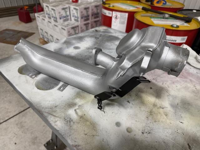

Read a lot about heater box repair vs replacement. Decided on repair as under the rust mine are actually in decent condition.
Looked like this on removal.
Scraped. Degreased. Metal brushed. Bead blasted. Ospho'd and high temp painted.

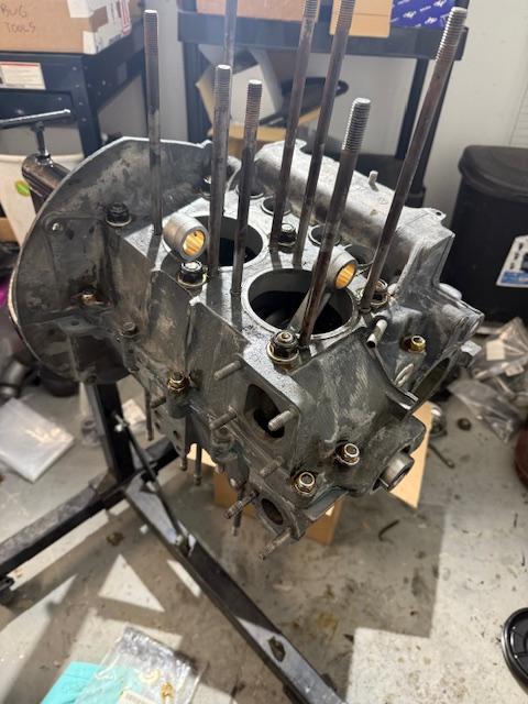

Everything in place.
And closed. Sealed with Curil T. Nuts sealed with Permatex Aviation. Crank moving freely after all torques applied.

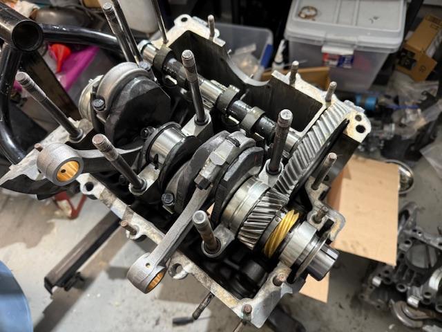

Progress...No horrible cracks immediately obvious. Crank looks ok aside from staining, will measure for wear. No spun bearings or any mystery metal in the sump.
