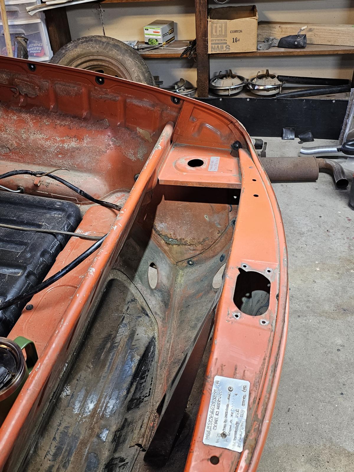

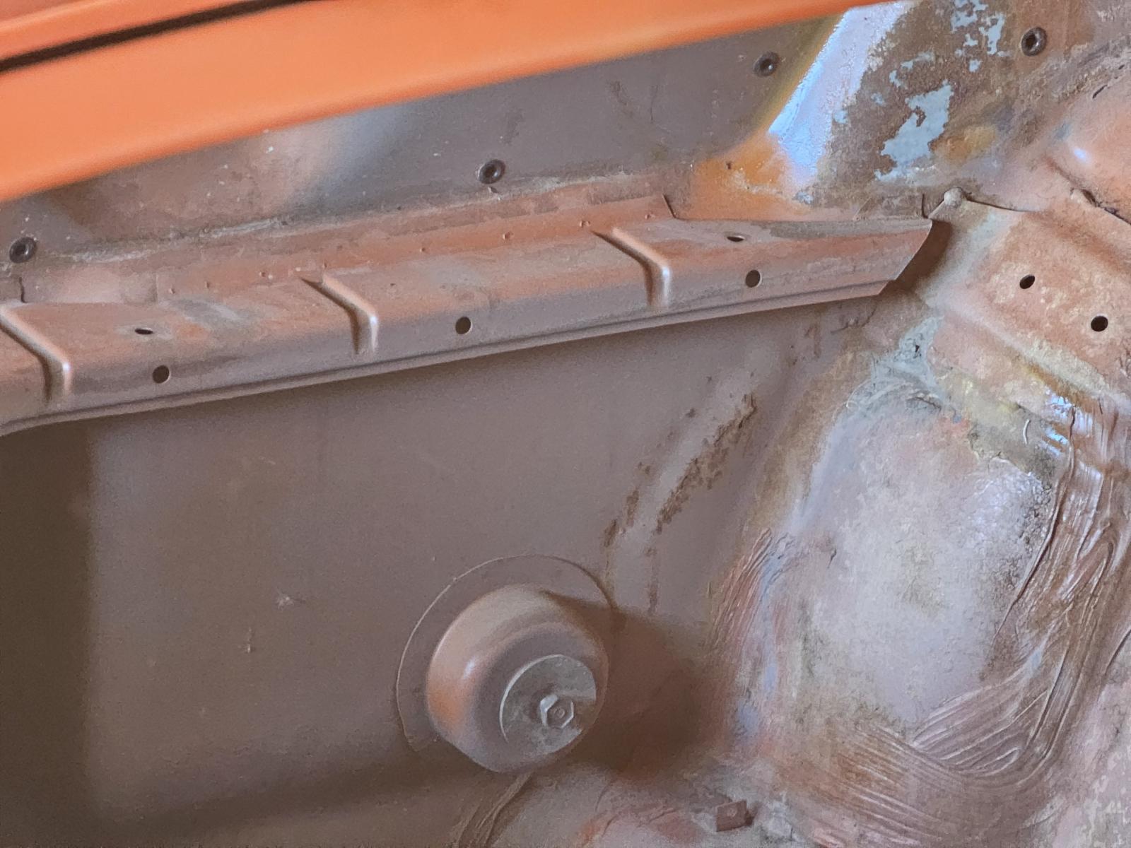

No_name4aday wrote:
I sprayed the front fender with rust encapsulater plus from east wood then filled the holes with metal epoxy and sanded that. I will spray the whole fenders with that. Not much filler required. The inside has a globby coating that will need chipped away in some places most looks solid. The fenders are in good shape for what it is overall. Got one ready about to coat on the outside. Figured out what blocks to use in the corners ect. So should be ready to flow on progrees again. I am not sure wtf I'm doing but this seems like a logical way to go and this be what it will be Rolling Eyes eventually primer and paint.
More than likely the inside portion of the front fenders is coated in "rock guard" to keep stone chips from breaking thru the paint causing rust. A heat gun and a scraper will remove that stuff easier than trying to sand it.

PostPosted: Mon May 12, 2025 6:27 pm    Post subject: Re: My 71 squareback...fixing up a classic vw Reply with quote

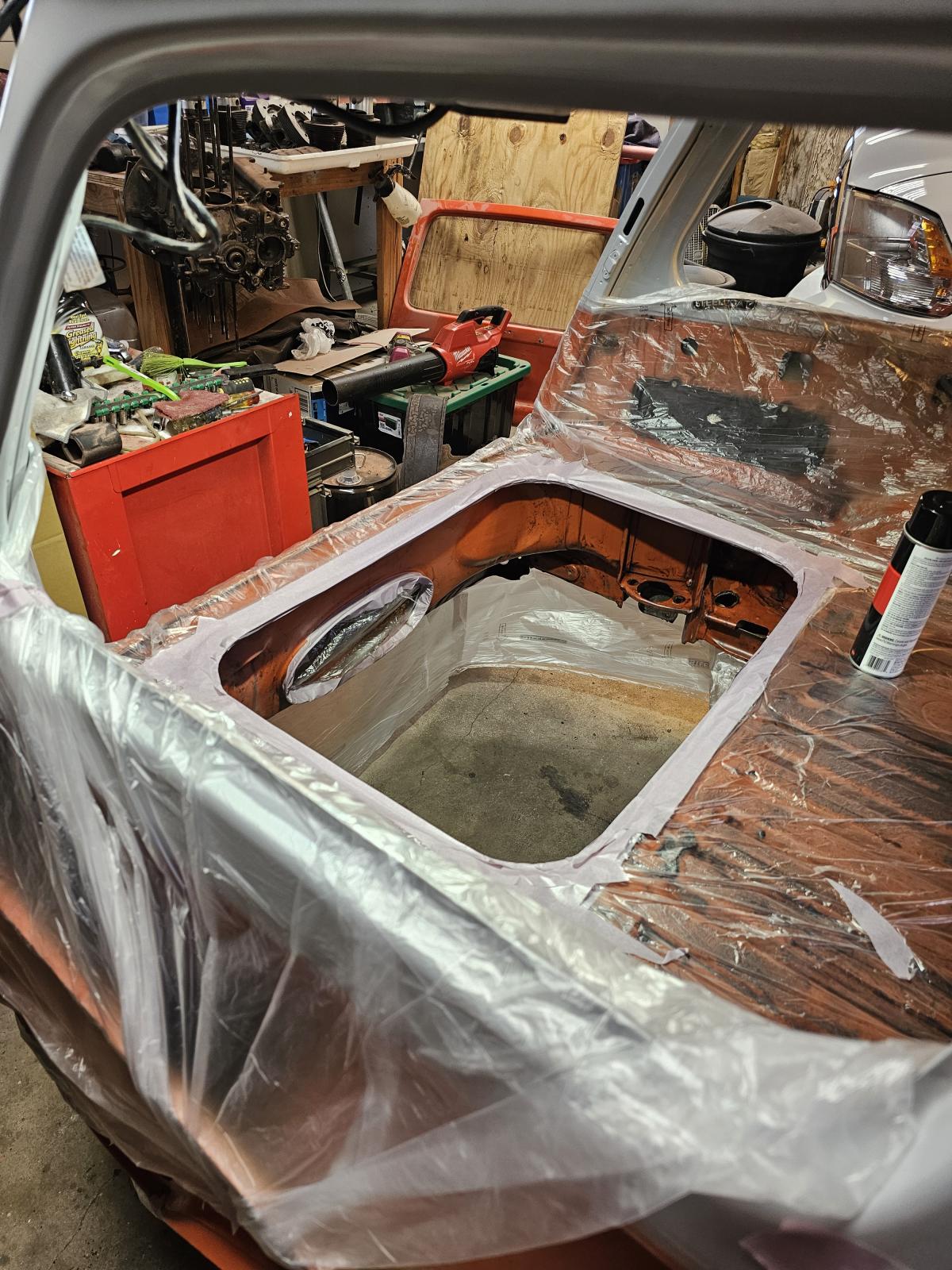

PostPosted: Sat Mar 15, 2025 2:02 pm    Post subject: Re: My 71 squareback...fixing up a classic vw Reply with quote

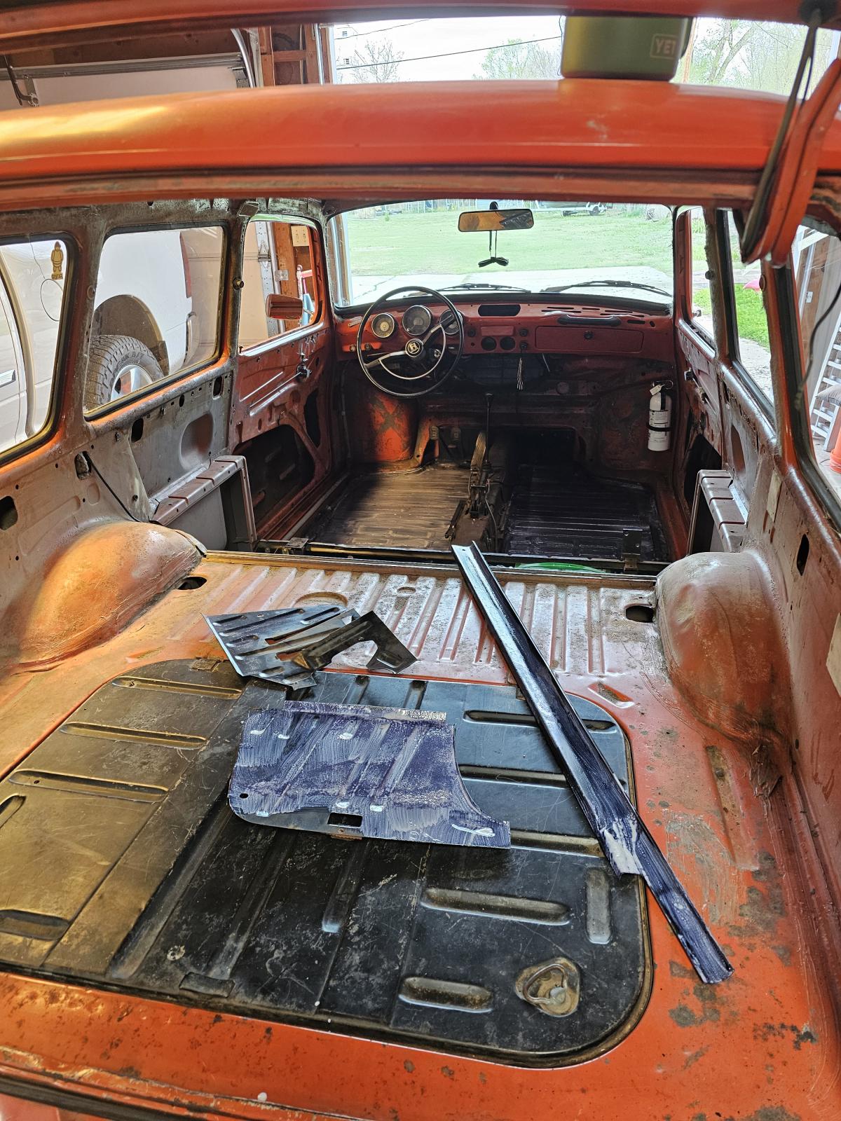

Need to do under the back seat still then the floors will be done. Got the rubber cut for the front pans as well. Floors were in good shape rust treated them and used epoxy fridge paint. Used textured rust inhibitor from eastwood in the engine bay and lid. Sanding and more sanding then that again and again
