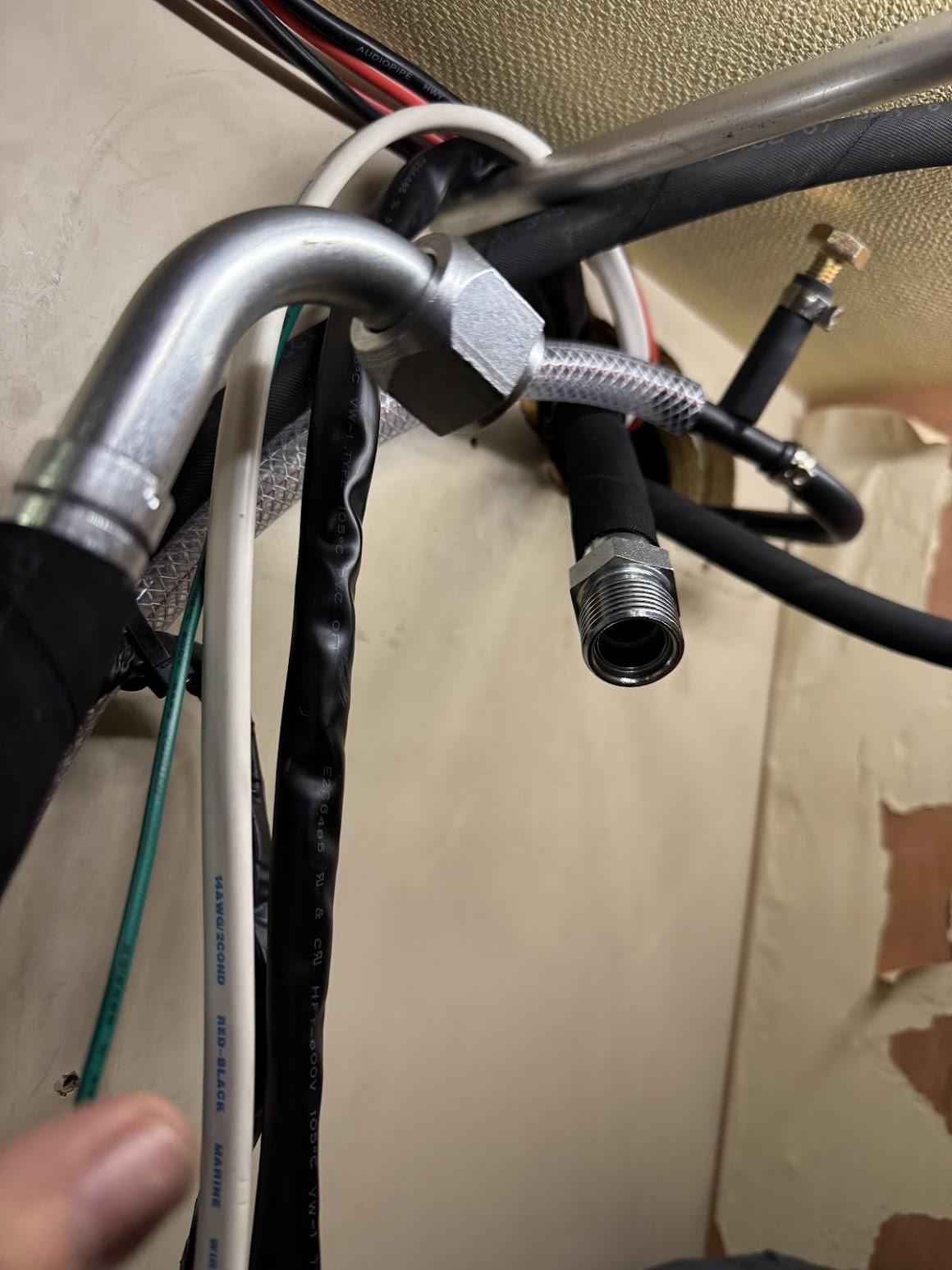

If I recall, the new unit uses the same/standard hose ends. I personally would recommend "extending" the connections for the new evaporator into the closet. However, you don't have to do that.
Vanis has a clever way of dealing with the hose situation. With his original setup, he mounted the evaporator to the ceiling, where it was hanging on a board, and the board was suspended by threaded rods. This allows you to lift the headbanger covering the evaporator.

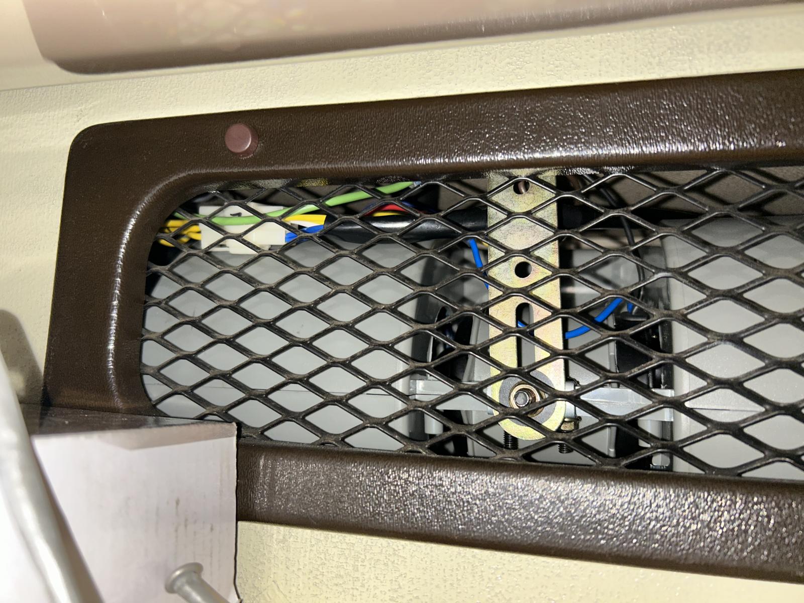

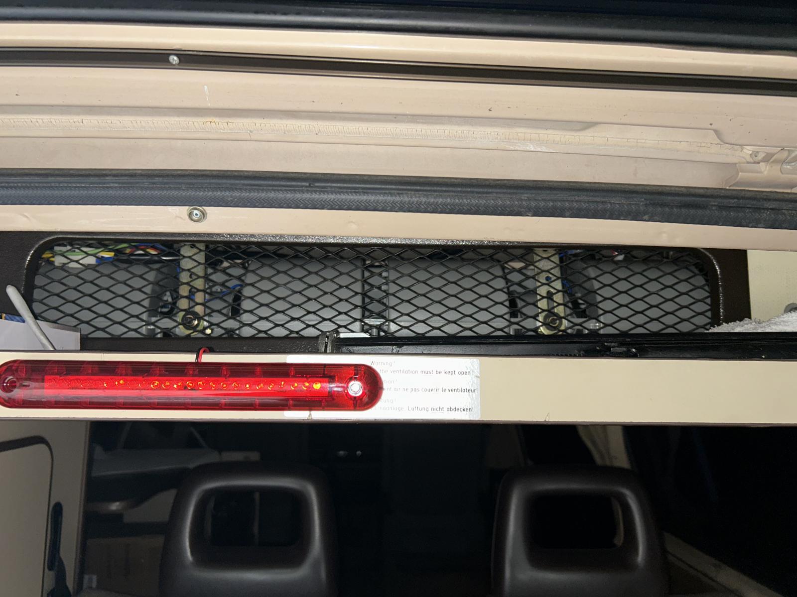

I recently did this upgrade for my 84.
A few years ago I did the condenser upgrade, built and installed new lines, the whole shebang.
However, the system work just ok and could not keep up when it got into the 90s down in Texas.
So, I took a chance and installed this unit.
Massive difference. If you have the old small evap unit, this is a no brainer.
A little bit of fab work to keep the stock headbanger cabinet, but I would not call it a hard project to get sorted.
The unit is running of a older Subaru compressor.

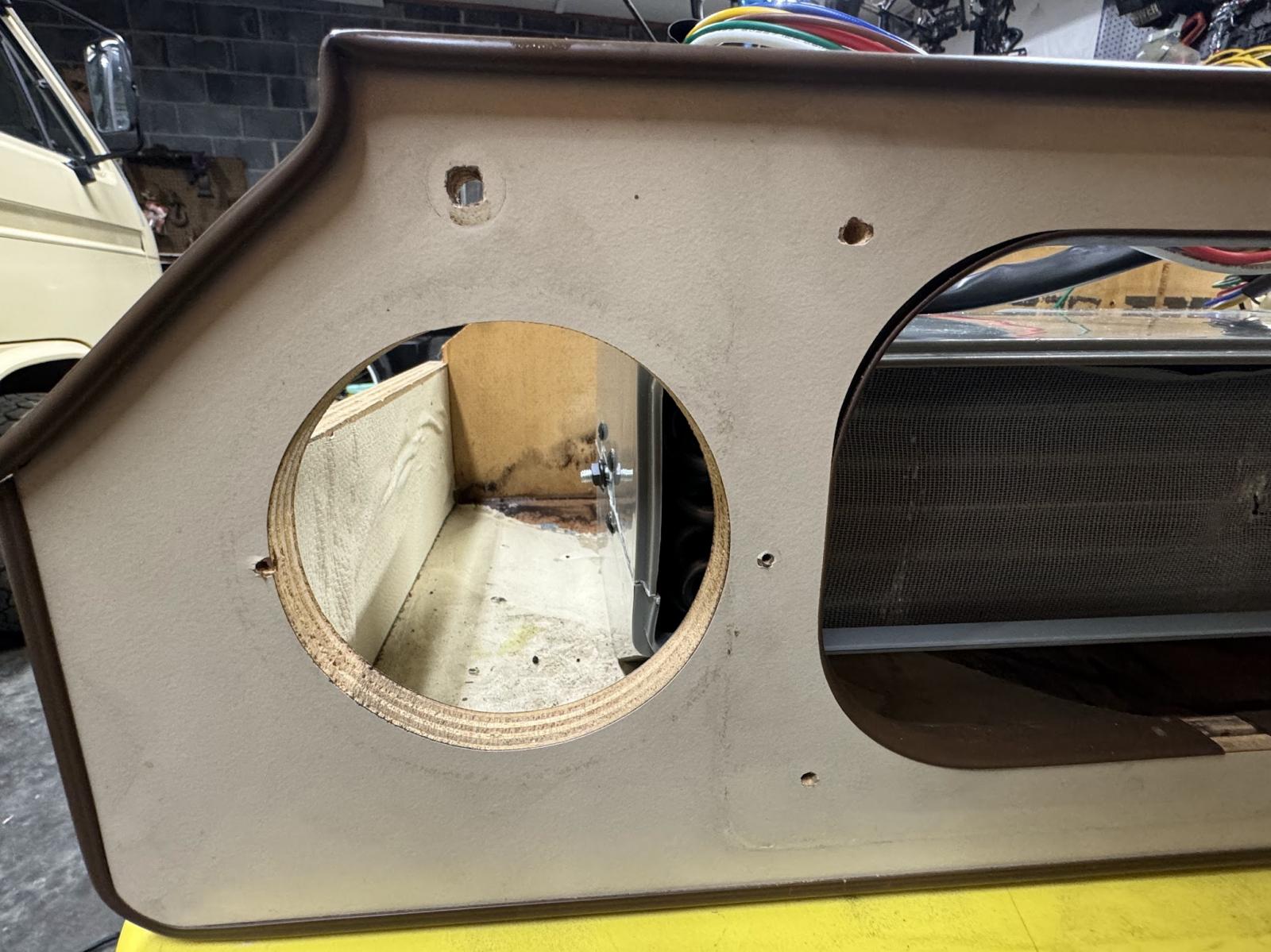

I just installed one of these evaporator units. I was able to hang the unit with the provided brackets, hook up the lines and wires then slide the cabinet into place. I did some minor trimming around the speakers and for the width. I used the new fan/resistor wiring harness from the unit and was able to hook it up to the original wiring harness. I don’t want to cut up the original plastic vent housing so I made a new faceplate to use 3 of the original vents for more air flow. To fill the gaps I glued some foam into place. When it’s summertime I will update with how it performs.

I LOVE my new unit. I can't recommend it enough. It could be 85 degrees out, very humid, and my wife is asking me to turn the unit down. I am getting a 40'F delta with it.
Mine is currently hooked up using OEM wiring.
Stock look was important to me also. You have to do some custom fabrication but it is worth it IMO.
To make it hose install/removal easier to disconnect, I relocated the #10 hose connector into the closet.
