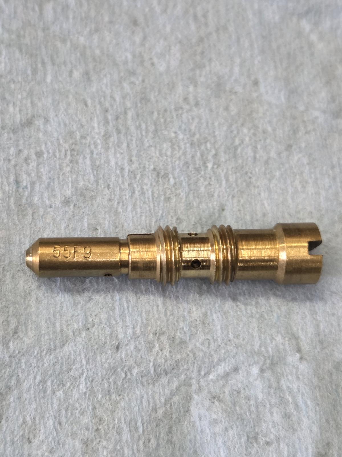

The DCOE is a 40 with size 30 chokes.
The mains are 190 in F11 tubes
The idles are 55F9
I haven't pulled the pumps but did go large on those, with a zero return so the engine is forced to use all the gas from the pump

PostPosted: Wed Dec 25, 2024 1:27 pm    Post subject: Re: Supercharged 1600 Vw beetle Reply with quote
Dauz wrote:
running rich af
WHS
Your idle is too lean. Should be around the 14-15 region, this leaning out is the sort of thing I get with crud in the idle jet on a progressive.
Apart from that the rest is very rich.
Because of the large venturis, with a smaller engine, the jetting will be very twitchy, because you do not get a decent vacuum from the airflow through the carburettor lifting fuel through the main jets, until you reach very high RPM and airflow.
Or make the venturis smaller or fit a smaller carburettor.

PostPosted: Mon Dec 23, 2024 6:18 pm    Post subject: Re: Supercharged 1600 Vw beetle Reply with quote
I bet you are too lean, especially in the pumps.
I have this set up on my 1600. I found a high quality AFR gauge with a Bosch sensor was very informative. I think it is necessary really. I put the 02 bung at the merge just before the muffler flange and run a single quiet pack trimill muffler.
My DCOE is 40 with 36 venturi
To minimize the bog down when I smash the throttle, like especially when coming out of a corner in second gear when it would fall on its face if I was too eager, I went very rich on the pump jets and also went to a zero/closed return jet which forces all of the pump fuel to get used rather than bleeding back into the bowl. This helped a great deal. It still does not behave like a fuel injection car meaning I cant just pop it open blindly in every circumstance and expect it to handle the rest. But with very rich pumps its much more forgiving and easier to drive it hard, while always getting the most out of it when rolling into it with some amount of thought for what it wants.
I keep it above 2,000 rpm if I want to be able to get on the gas hard without delay. Below 2,000 rpm I have to roll into it much more gently. It is very happy and responsive above 2,000. It pulls hard until tapering off a bit above 4,500 through 5,000 rpm still pulling good but not as dramatically.
Overall, all of my circuits are jetted far richer than anyone guessed and I do have 500 dollars of jets sitting in a tin that are left over from the process. The AFR readings coincide with the engine being very strong in the low 10 AFR range, seeing an occasional dip into the high 9s when easing into it at mid range rpms up a long hill to maintain speed or mild acceleration. Open it up at speed in the 3,000 to 4,000 rpm range and it pulls hard drifting up in into the low 11 AFR range. Lean cruise on level ground on the highway is mid 12.5 AFR and rolling on the throttle at speed it richens to the low 10 AFR and pulls hard.
Idles evenly at 1,100 rpm with AFR readings of mid 17 but surges when I lean it out with the screws to force it down to 1,000 rpm with AFR of 19.8. I live with the idle surging a little in between those two spots.
I've got a 009 distributor with a grub screw in the tab to limit the advance to around 12 degrees. I have it set at 12 degrees BTDC at idle and it winds up to a total of 24 BTDC. I'd be afraid of popping a hole ina a piston at your 30 degrees.
It never fouls plugs. The engine runs cool all day long even under abuse. It gets 22 mpg driven like a commuter car at highway speed limits. If I drive it like I stole it I get 13 mpg. On a good run I can sometimes get into the low 18s at 72 mph in the quarter mile at the local strip if I recall, I keep meaning to post my slips and should dig them out. It will easily go 90 mph and runs out of gearing before it runs out of power.
All my reading suggests I'm getting 6 pounds of boost with the standard v-belt AMR500 pulley and stock crank pulley.
