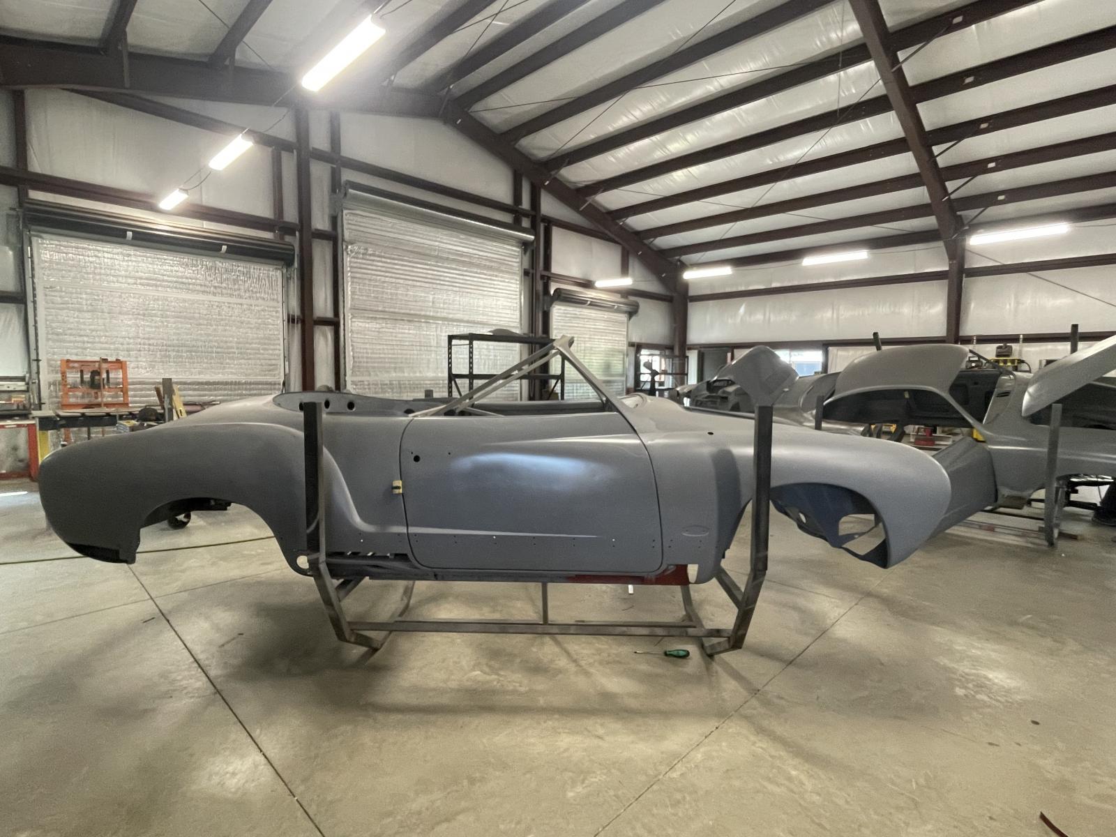

Once the doors are hung and alignment is looking good we Locked them in place with a couple tabs. Now it’s time to tackle the inner rocker panels as well as the outer rocker skins, and lower fender panels

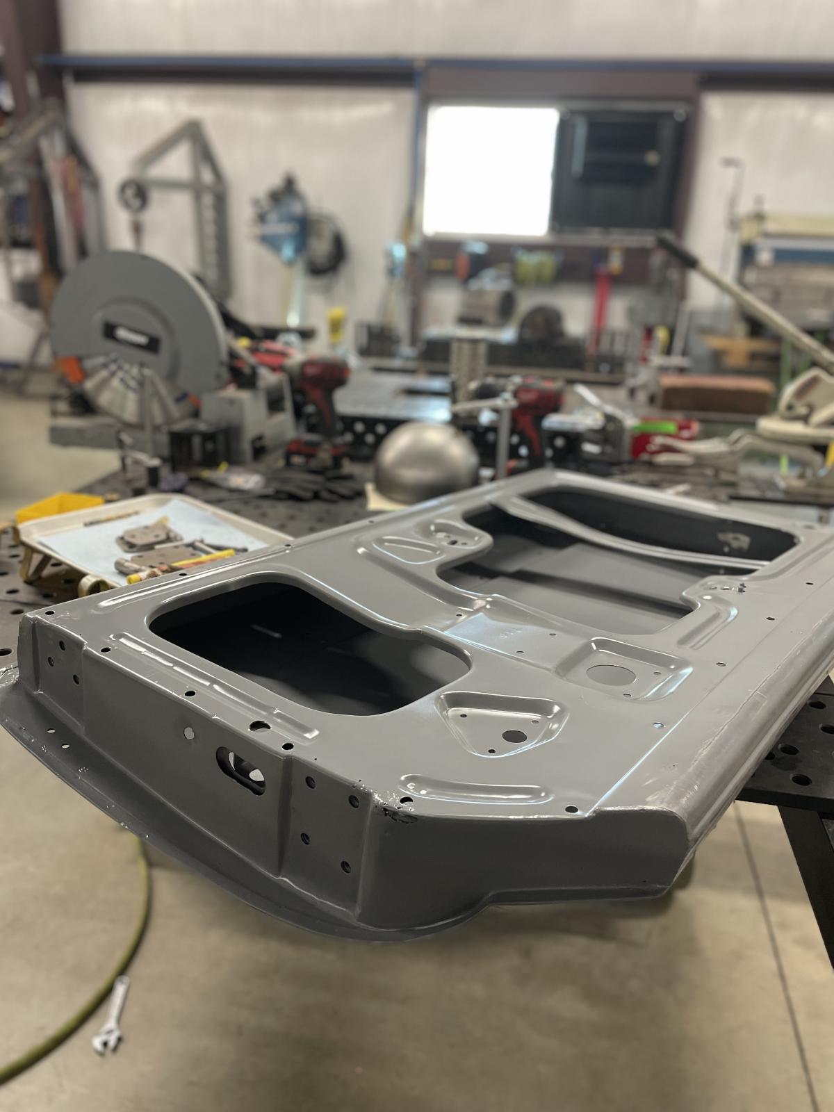

Time to hang the doors again and see how the look and fell after the hinges being sorted out.
We will also be leaving them on as we install the adjacent panels so we can make the appropriate gaps as we go.
They look and feel great so we are off to a good start.
