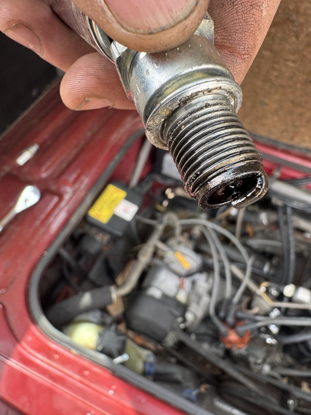

PostPosted: Sat Apr 26, 2025 9:20 pm    Post subject: Re: Syncro has sat for 20+ years let’s resurrect it! Reply with quote
Take off the manifolds and Spray intake valve stems with carburetor cleaner.
Carb cleaner may cut the goo.

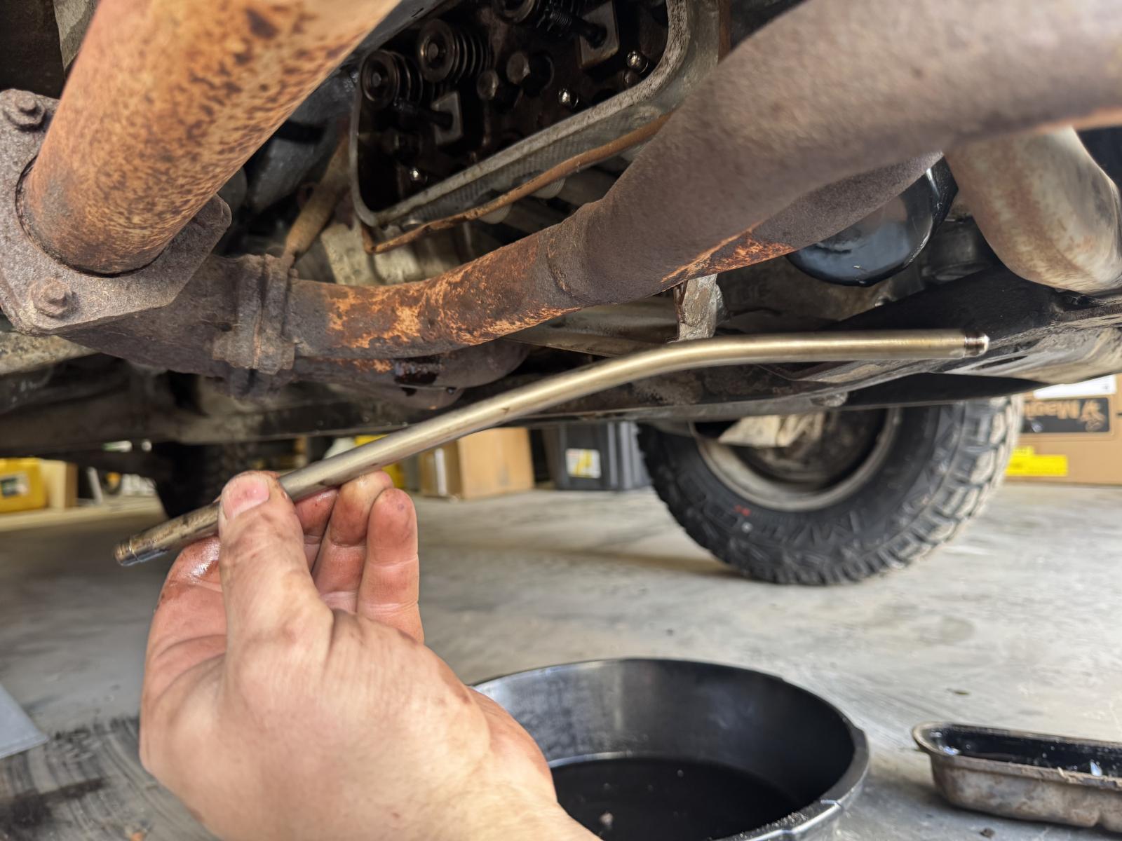

Well, I got some time to work on it today! Got two pushrod tubes from Van cafe along with some other stuff. I put the new push rod in on the driver side head after fitting the spring loaded pushrod tube. Got rockers in and valve cover on and this thing just won’t start.
I go to see if the pushrod bent again or something and it turns out there’s oil spilling from the passenger side head now. Great. Another intake pushrod completely bent just like the other side! Not just that- put upon pulling the valve cover I see a rocker arm snapped off but somehow the pushrod doesn’t seem bent.
What the heck man? Is the goo gas crap causing all the intake valves to completely freeze up? Why did it run so good but now doesn’t and everything is going wack with intake valves sticking? How is this happening? Lifters seem fine, no tick or anything. What in the world? I noticed the valve came back out very slowly from the driver side head- the one I just fixed the bent pushrod and tube on. I clean the crap out of it and it then seemed to back out just fine no lagging. Is it possible something is very wrong here? It really seems like all the intake valves stuck at once and cause this. How can that even be? My only idea is the goo gas. Ive had mmo and sea foam soaking in the intake valve ports from injector holes. Hoping to clean them up. Time to try and source a rocker arm and another push rod.

Well the valve isn’t sticking per se, at least not after a MMO and PB blaster bath. I’m going to wait a while and then see if it sticks and smacks the piston still after sitting for a bit and “drying out”. If it’s not sticking I’m going to do something pretty savage and cut a pushrod tube in half that I got for it and then install it much like the adjustable nut ones or the overpriced spring loaded ones that straight up go west says leak oil and that it’s normal. I’m going to cut it, find a hose that slips over it and slide it over one side with two hose clamps, then shove each end in with new seals and butt up the cut and then slide the hose over and clamp on each side. Is this ridiculous? Am I crazy? Or by some miracle is this going to work? I am unsure but going to take the risk and see what happens. Best case this works and we resurrect this Syncro for Easter by a miracle. Worse case I bend another push rod or that valve, knock a hole in the cylinder, my pushrod idea fails and pukes all oil out and I rune the motor… haha things could go horribly wrong.

I straightened out the bent push rod and put it back in with the rockers. Oil is pouring out although I lifted the drivers side so not super crazy. I poured quite a bit of MMO in the injector hole of the valve that’s sticking that bent the push rod. It clicked pretty bad for a few rotations then it silenced and seemed to be fine. This happened previously though and I thought it just needed to get the oil turning when I first started this van. Now I’m just not sure if it’s going to stick again and bend my new push rod. Everything looks okay as far as I can tell but honestly I’m not sure. I’ll have someone else crank over so I can spray more MMO and pb blaster on this valve to try and clean it up if it just had stuck from build up. What do you guys think about this situation?

Okay I need your opinions on what to do. I came out here to try and get the head swapped out but when I went down to start taking things more apart I saw that the intake valve actually went back I put by it’s self. A primitive leak down test through the injector hole confirms the valve is seating. What do I do? I know head gaskets were done not many miles ago on this from receipts I found. My gut tells me to pour a good amount of marvel mystery oil into the injector hole and bend the push rod back and reinstall rockers and turn it over and see if the valve comes loose. If it works I’ll put in my new push rod and get a telescopic tube to install without pulling the head off. What do you guys think? Worse case I actually do bend the valve which I thought had already happened?

It's quite possible it was already bent, might be why it was parked. It just wasn't catastophic until you ran it and it caught and bent more.

PostPosted: Tue Apr 08, 2025 6:45 am    Post subject: Re: Syncro has sat for 20+ years let’s resurrect it! Reply with quote
MayorMcCheese wrote:
Do you think the push rod bent when you ran it or do you think it bent 20+ years ago?
It for sure bent when I ran it. I had heard it a few times and thought it sounded like a valve sticking and hitting the piston... so I added some marvel mystery oil to the cylinder and changed the oil and it went away until I finished cleaning the tank and fired it back up then bang it smacked, bent the valve I'm guessing, bent the push rod and kinked the push rod tube to the point that oil started spewing out of the tube seal on the block side. It was pretty sad but I'm in the works with North-Westy to get a used head and possibly pushrod with tube and seals but we'll see if it pans out. Shouldn't be too crazy to just replace it as long as the head they send me is in good shape.

PostPosted: Fri Apr 04, 2025 11:13 am    Post subject: Re: Syncro has sat for 20+ years let’s resurrect it! Reply with quote
UtahGOgear wrote:
Bent push rod. Tube was very kinked. Valve stuck.
Honestly, it's been over 20yrs since I had a WBX, so my memory may be faulty, but from the pic it looks like both intakes are lower than they should be. Obviously the one on the left, but the other looks odd as well. Bummer but the head is definitely coming off, and hopefully that's all the damage. I would not run it again with out pulling the other head and going through it. If you have one or two sticky guides in this head, likely the same issue on the other side. As hinky as these heads are I'd be more likely to replace them than try to re-use, but there are others here who have much more experience with these issues than I, hopefully they'll chime in. The wet plug(s) not at all surprising as that/those cylinders have zero compression. Good luck!

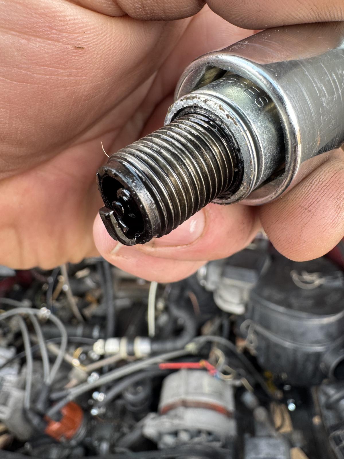

So… since I first tried to start this thing there’s been a weird clinking noise. I figured it was just everything getting lubed up. Unfortunately I have discovered from my massive oil leak that an intake valve was (and still is) stuck open. It likely smacked the piston and is bent now. I took the rocker arms off and this valve did not spring shut. This is not ideal. The push rod is very bent which also sucks. Most likely that valve is bent inside the cylinder and when the piston smacked it real good while it was stuck out it froze and the push rod met an immovable force and bent, bending the tube with it and causing the tube seal to unseat.
I honestly thought I’d be driving this around after the fuel tank clean out. It’s taken the better part of spring break, and I’m afraid I don’t have parts to put it back together nor time to take it apart. I’m guessing at very least I need to pull that head and replace the valve, probably valve guide is messed up too. Then get new push rod and tube and seals and if I’m lucky the damage wasn’t worse than that? Sad feeling a little bummed out!
Plugs were wet and it never did start back up. Not sure why, couldn’t be related to stuck valve? I don’t think it flooded and hydro locked, but maybe something like that? Although it made the sound before.

UtahGOgear
Joined: November 26, 2017
Posts: 201
Location: Utah
UtahGOgear is offline
PostPosted: Thu Apr 03, 2025 1:28 pm    Post subject: Re: Syncro has sat for 20+ years let’s resurrect it! Reply with quote
4Gears4Tires wrote:
I don't know if I would recommend the filter before the pump. If you prime it and then open the fuel bleed valve (that metal junction with a small bolt) does fuel pressure shoot fuel out?
Fuel does shoot out. It’s for sure under pressure. Sadly I just went to try starting it again after letting it dry out a bit and there was a metal clunk and now lots of oil on the driver side head area. Pretty sad about that, especially because it was running like a song a few days ago before the gas tank cleaning.
